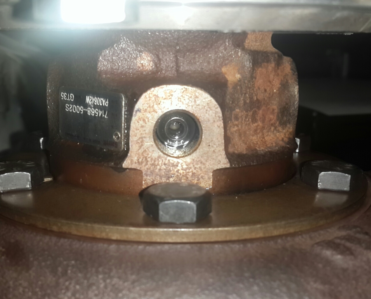

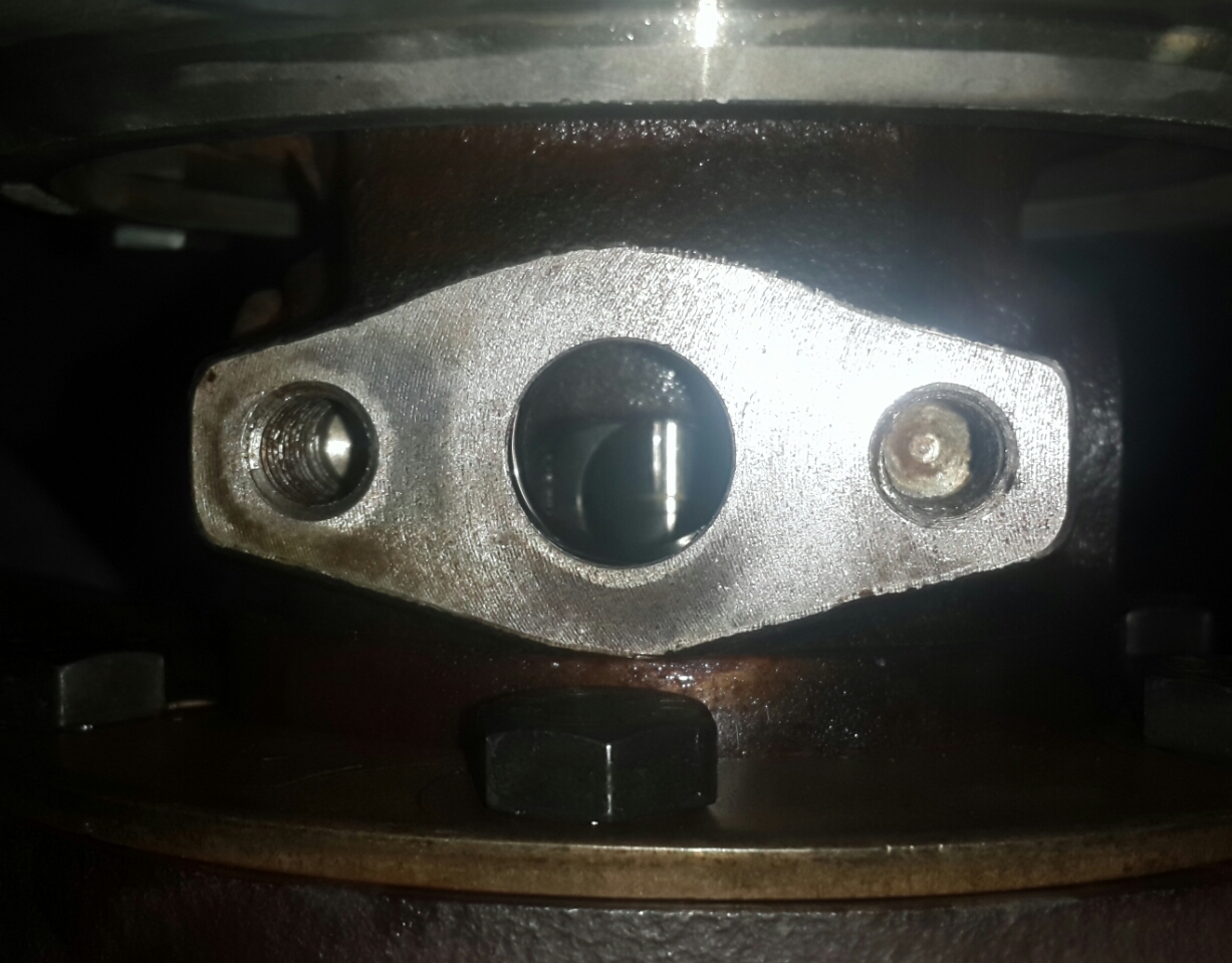

whats up guys!! :D
can anyone tell me which is the oil inlet and which is the oil outlet on my turbo

Re: turbo inlet and outlet
Top pic in, bottom pic out
Ja what draco said
Post by RaceBreed »
Schweeet gents thanks :D
