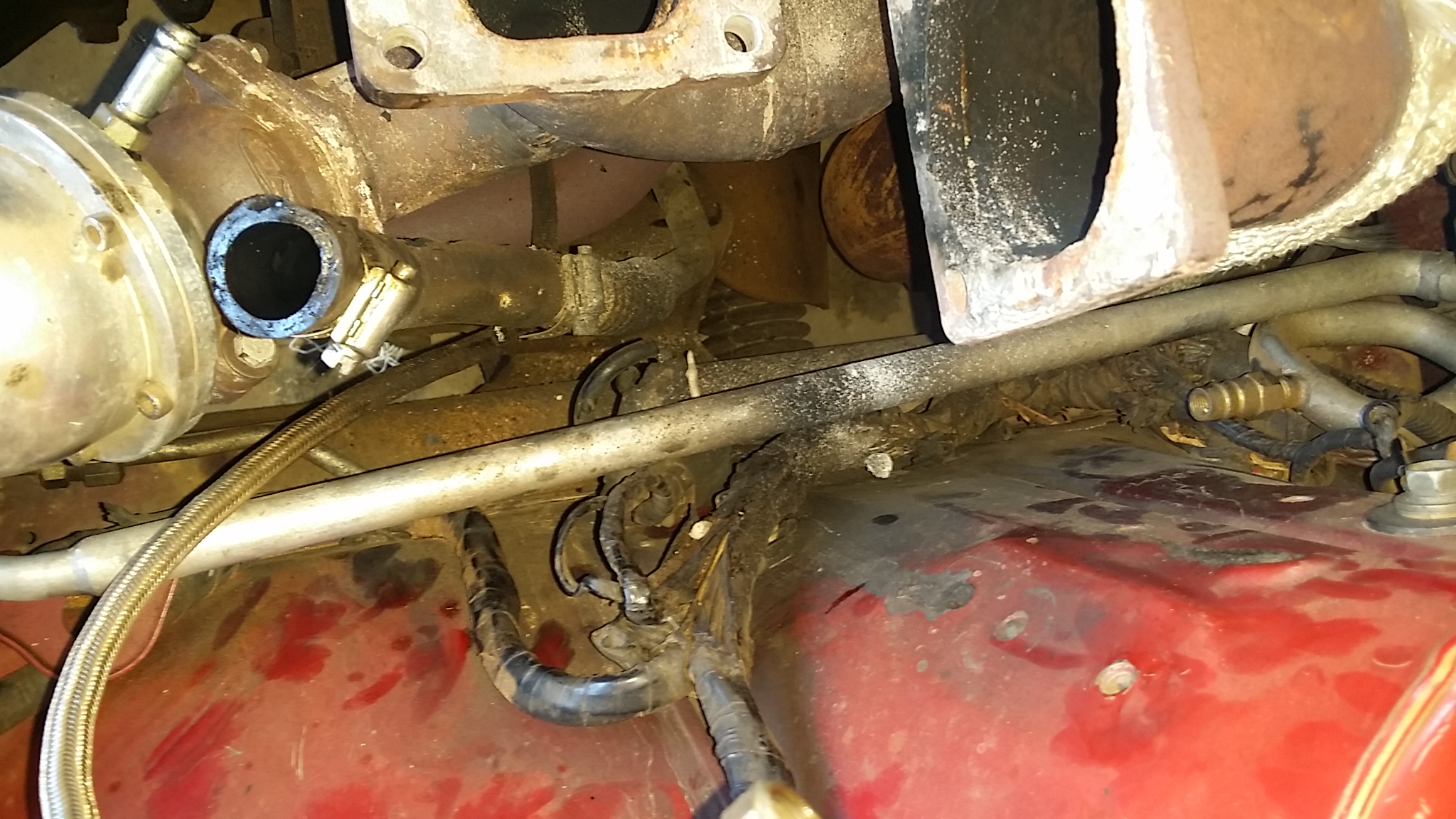

Hi there!
So Saturday night I had some fun with the car after working on the turbo. when I got home I saw smoke coming from the turbo side and relised I never refitted the heatshield.

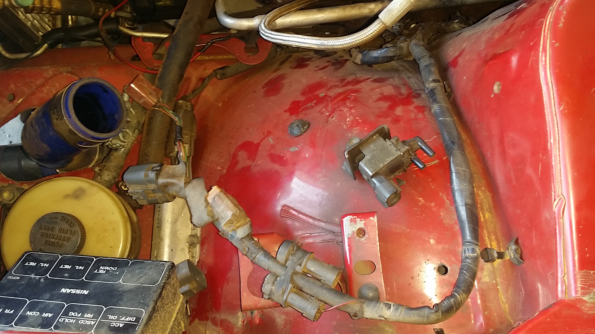

can anyone please tell me what this part of the harness does? everything in the car works fine, I disconected the powersteering and removed the aircon so I think its got something to do with the a/c and powersteering??
Re: burnt harness on my 200sx please help!
fuel pump relay signal abs sensor aircon afm load resistor. are you running stock ecu?

ok that sounds like good news for me I think. Running a spitronics engine management. Do you think I can just remove it completely from the car?
Thanks for the reply
you can yes but then your abs will not work unless you pull a new couple wires for the sensor
Or just loose the abs altogether.
Yah just rip the abs. Then even less wires.
