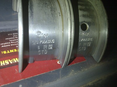

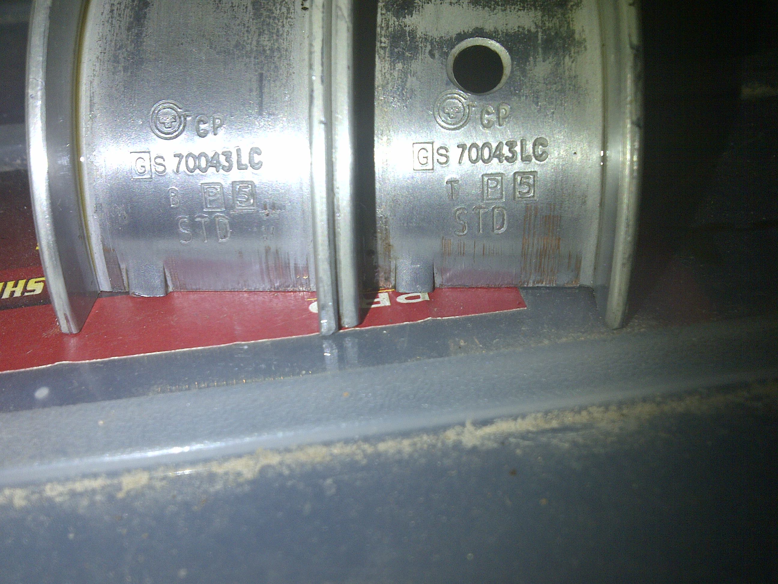

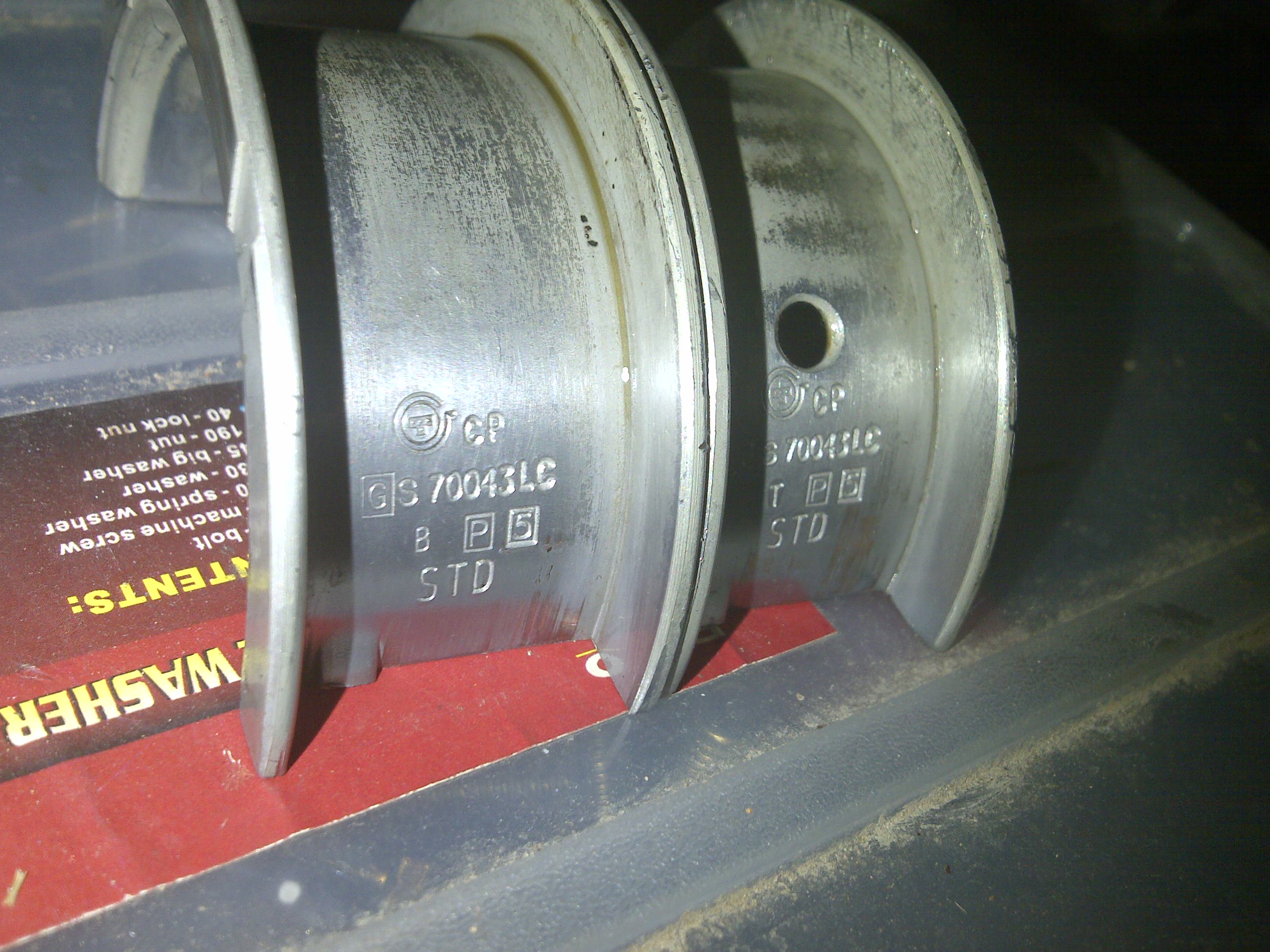

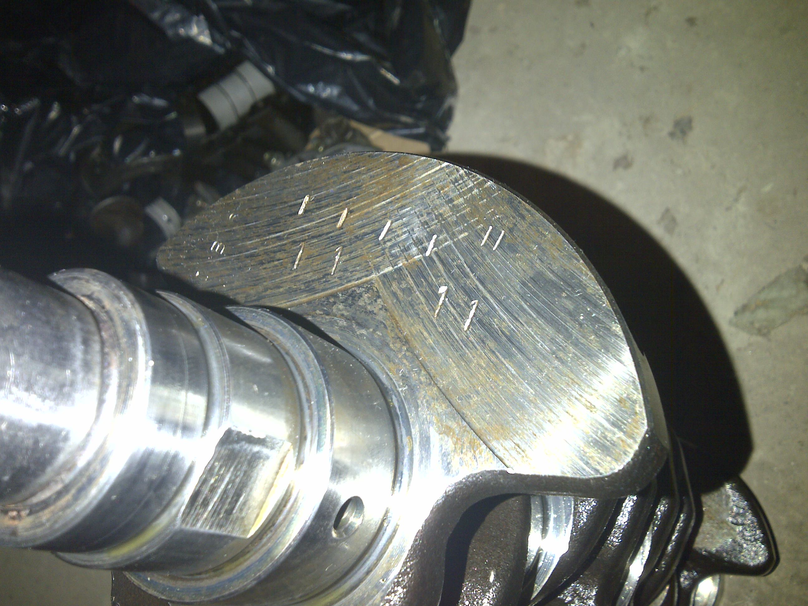

Ok, the crank was machined to balance I presume, there is a bunch of ones stamped into it, so 1+1=2 not a clue what that means. According to what I understand the aftermarket shops only sell one grade(size) standard that is within the allowed limit 0.1mm
Pics if it will tell u guys more than what my brain can make sense of.

Ok thats good, you need to check the numbers stamped on your block and stamped on the crank. You check in the manual as they said how to calculate the bearings you need. You will get something like a colour, green, yellow, etc.. and that is the bearings you have to get. They might not all be the same, so you might need to get different "colour" bearings for each journal. This is for standard Nissan bearings so that tolerances are perfect.
If you get ACL bearings or what ever, just get standard sizes all round.

if using aftermarket bearings i would sugest getting some plastiguage at the very least to check clearances.. nissan has like 4 grades inside what aftermarket calls std.. catering for very precise clearance adjustment

Hear what you are saying, not that I know how to use a plastiguage...the thing is it is only std aftermarket size and it falls within the 0.1mm which is the limit according to fsm, so it should be fine, not ideal but fine??
