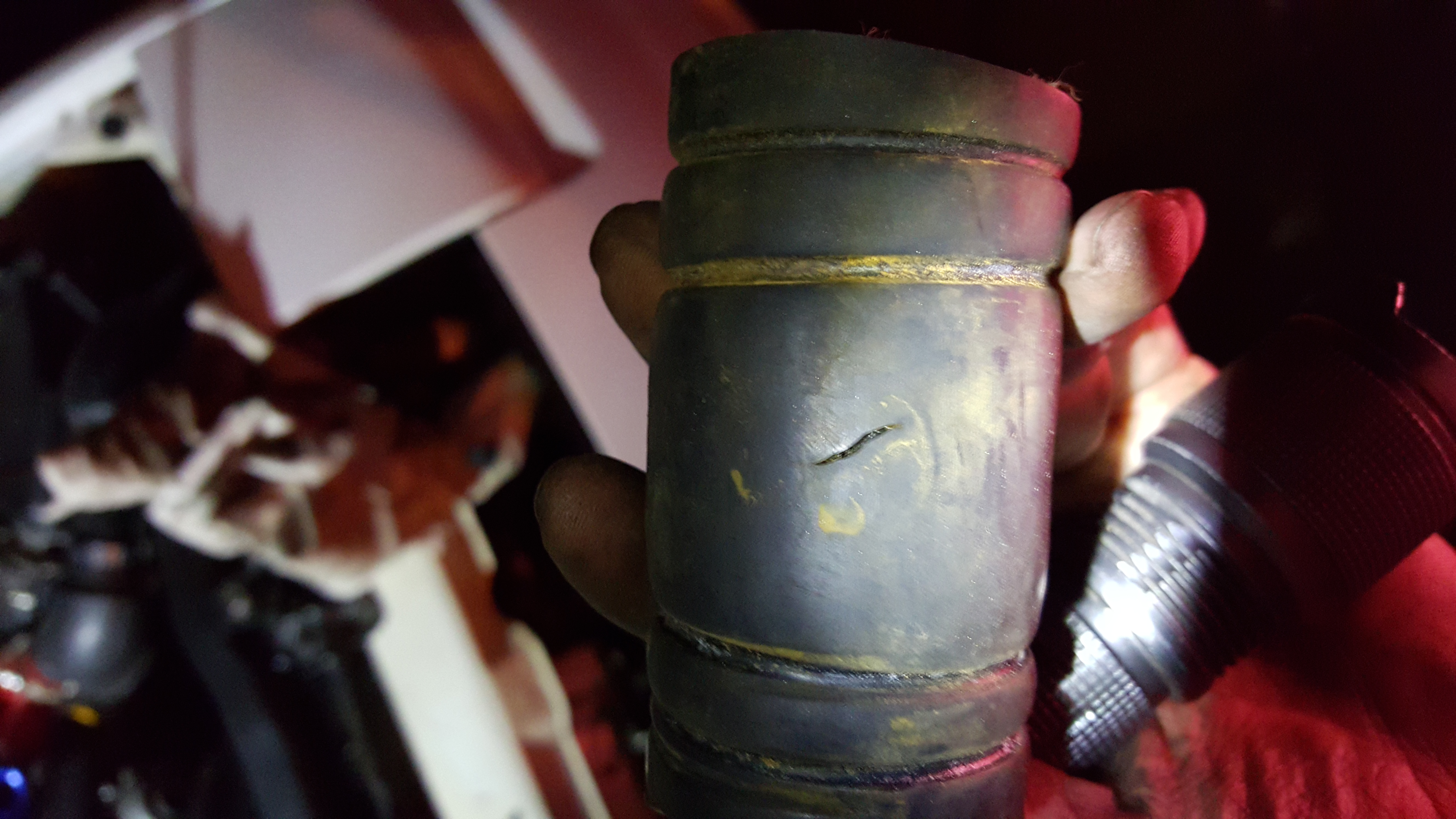

Ok so long over due update will start with the white sx.
Aricon fixed
abs fixed
reverse lights fixed
interior light fixed
Have now had a total of 6 water leaks from pipes been so old :roll: but car is doing well have 8000km on the rebuilt motor and car is pulling like a train very happy with it as a daily
