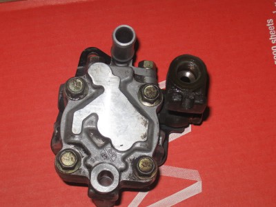

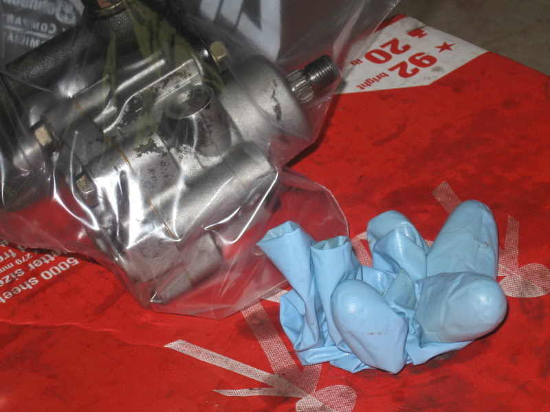

4. Remove the bolt size 14 witch hold the pump onto the bracket.the pump should look like this only with the pulley still on.

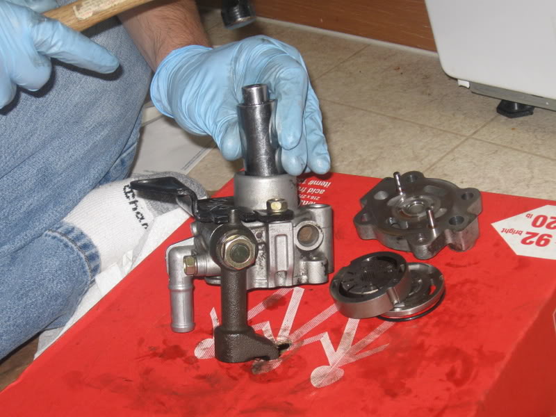

5. Remove the Pulley loosening the size 19 bolt and hitting the pulley with a small hammer a t the back of it Remember the pulley is splined so is the shaft be careful not to damage it or the treads.
6. Remove the 4 bolts at the back of pump to remove the back cover. You may need a engineers vice to do this.

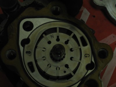

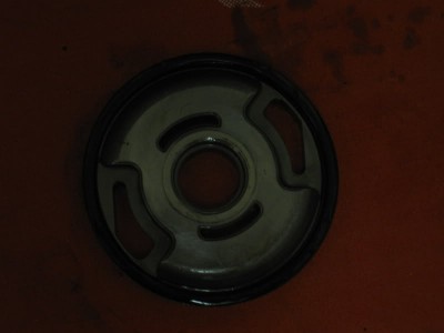

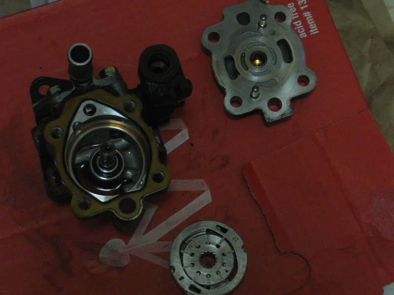

7.Remove the inside center sections there will be a spring at the back of these parts.Remember to take note as the parts come out they need to be reassembled in the reverse order if you not sure consult the service and repair manual.

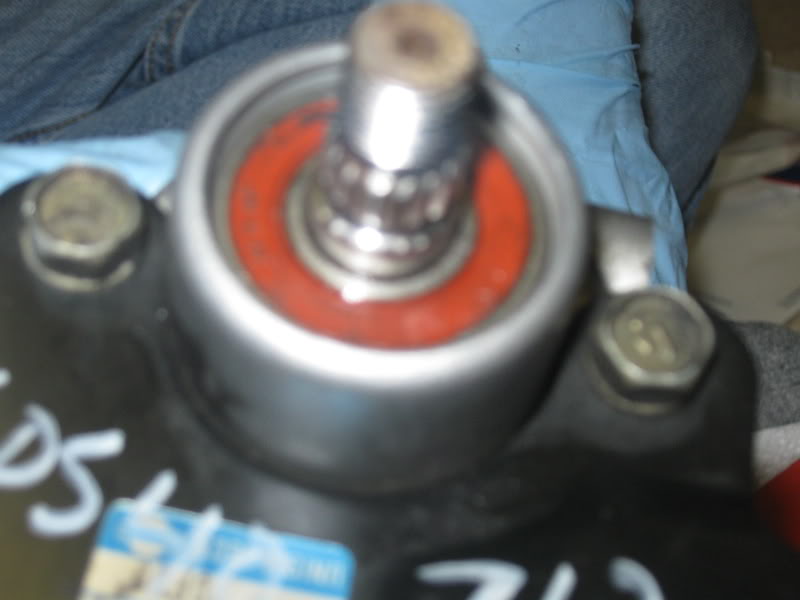

8.Remove the cir clip holding the bearing in place with cir clip pliers.

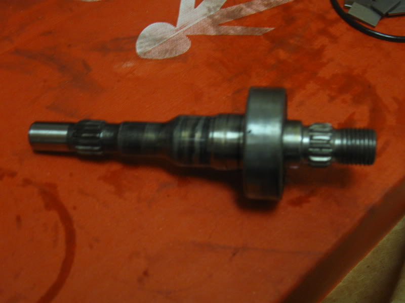

9. Use a bearing press or puller to push or pull the bearing with the shaft out of the casing.
10. Now pull or press the bearing out from the shaft Make sure not to damage the splines or bent the shaft.

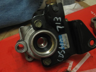

11.Remove the mechanical seal in the housing.( see above pic)

13. Push the new bearing onto the shaft make sure not to damage the new bearing.Also DO push it almost completely flush otherwise it will cause the shaft to be to far back and push against the back shaft housing seizing it up or damaging the housing where the shaft runs.
