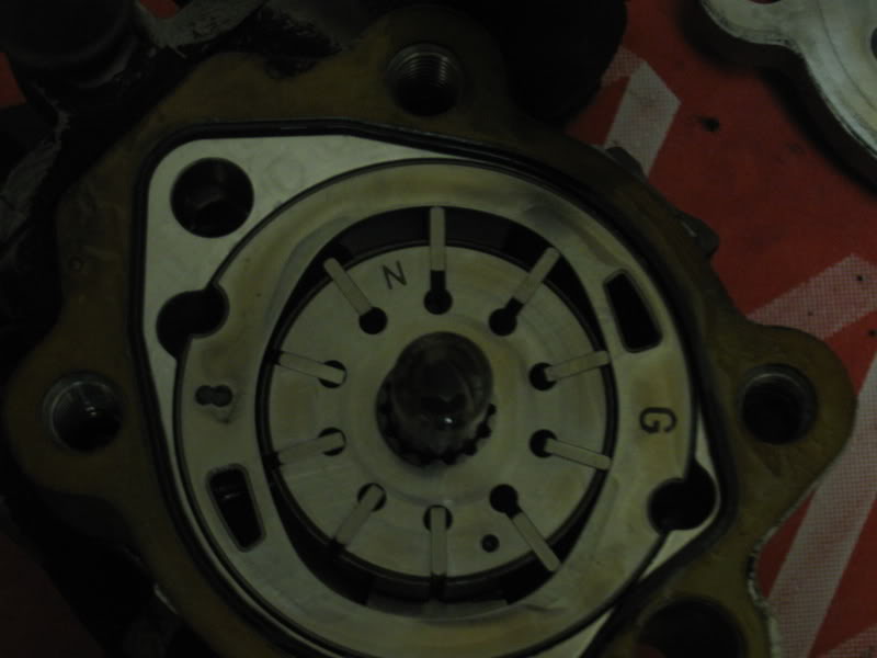

7.Remove the inside center sections there will be a spring at the back of these parts.Remember to take note as the parts come out they need to be reassembled in the reverse order if you not sure consult the service and repair manual.

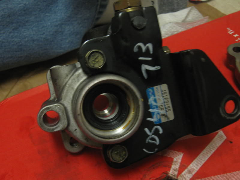

11.Remove the mechanical seal in the housing.( see above pic)
