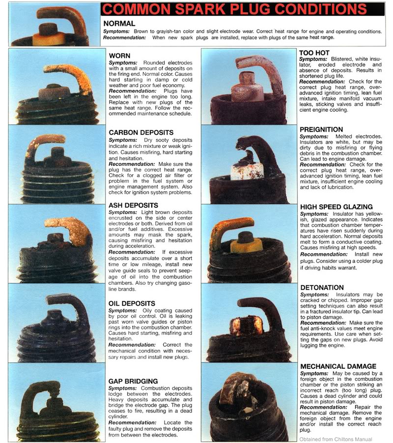

was on the nicoclub thought it could be helpfull

nice but since fuel doesnt have lead anymore makes it a little harder to read
Re: Spark Plug Chart
very true
