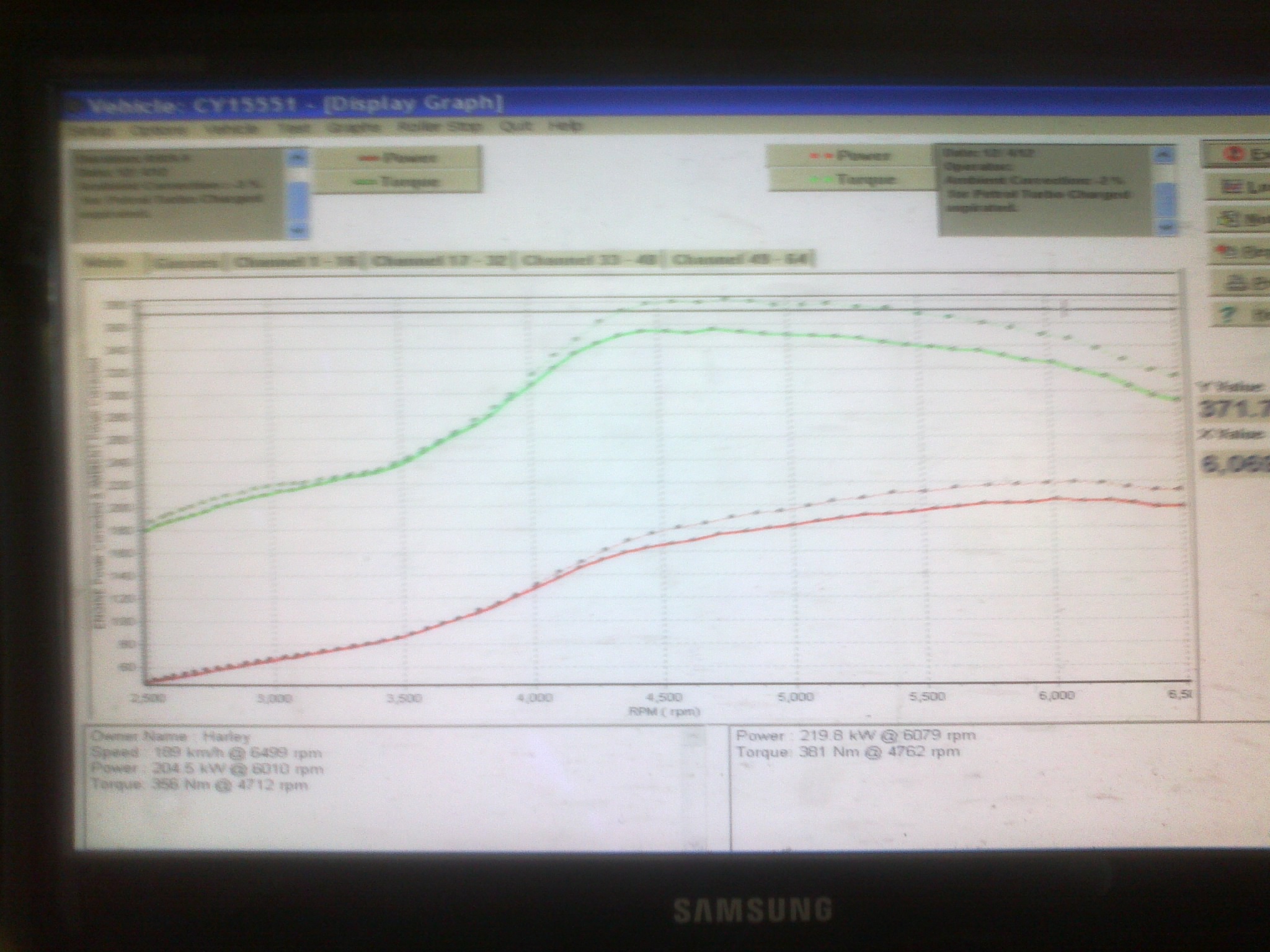

:lol: Well, the SR20 Blacktop and gearbox is in!
Goes like hell when the GT2860 winds up.
Dynorun shows 204kw and 356nm.
A little bit rougher than the CA18, but the increase in power more than makes up for it.

Re: Finally did it
Very nice figures for 0.8 boost!!!
I can't see on the photo, what was the ambient correction factor percentage?

Re: Finally did it
Post by Grobblere »
Looks like +- a 3% correction.
The power does look good!

Re: Finally did it
It looks like -2%, but the image is quite blurry and hard to make out.

Re: Finally did it
Post by harleyzx1400 »
-3%. Max of 205kw and 359nm. Only got a clear picture of the run in PDF format, and I can't post it. The setup of the forum wont accept PDF format.
