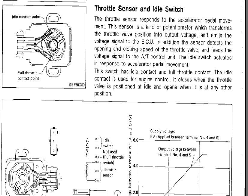

Hey guys a few weeks ago my sensor came lose and shifted I noticesed this when my response changed
I've tried to move it around to pick it up but with no luck
What can I do about it???

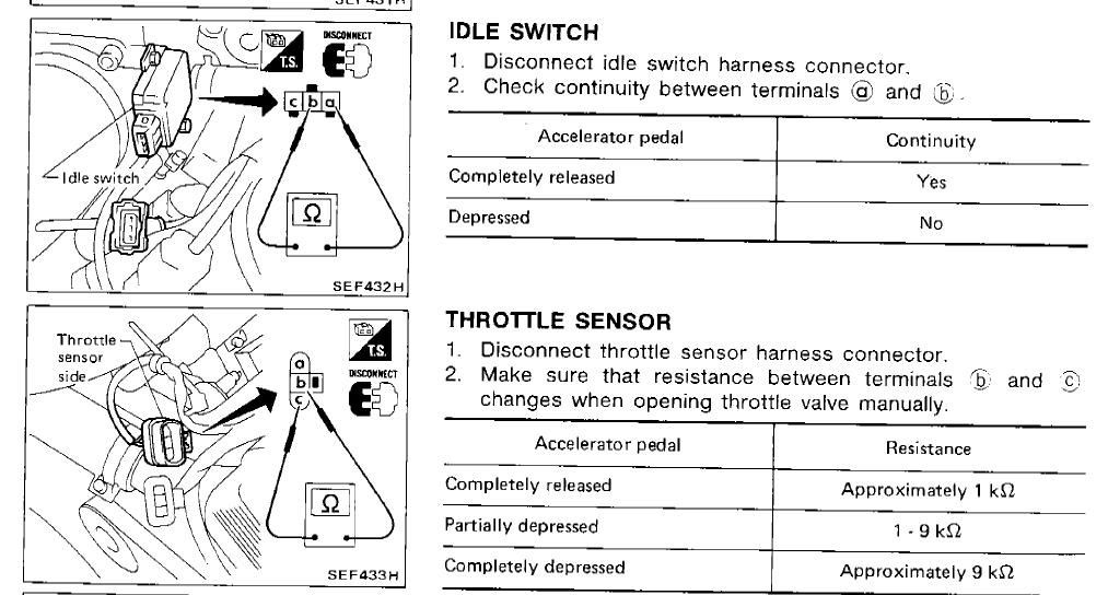

look in the fsm it shows you how to set it by ohms
but they are normally in the middle of the slot so set it near enough

ok here the three things i could find
hope this helps buddy
