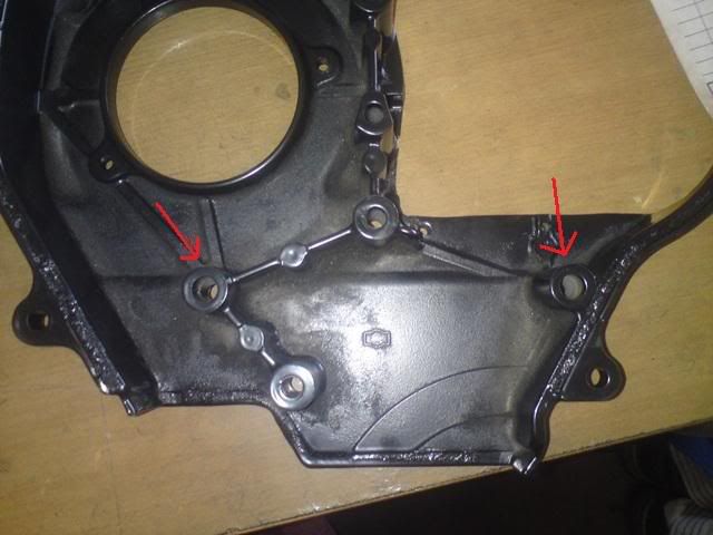

there is 2 locating dowls look at this pic mine are missing but gives you idea where they go
this is crutial or when you tighten your cas your timming moves and you mesd around alot (also found out hard way mine only had one in and when i tightend the cas bolts it moved between 7-10 degrees timing
