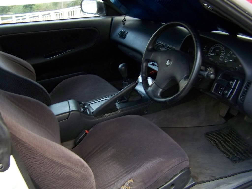

the car has never been raced yet as it has been standing for about 5 months now,,,,, made about 268rwkw as per Andre
Okay new pump is fitted i test dove it , need to set boost pressure back to 0.8 bar, needs a nice tune up
drives really smooth and still responisive, , feel like it could be used as a daily drive
only problem now is the sump needs a gasket, grey sealler not holding well
its got a small leak
car has stock wheels needs new tires , and a good valet
I practilcally rewired the front, all wiring has been moved to the other side of the engine away from the turbo side,
