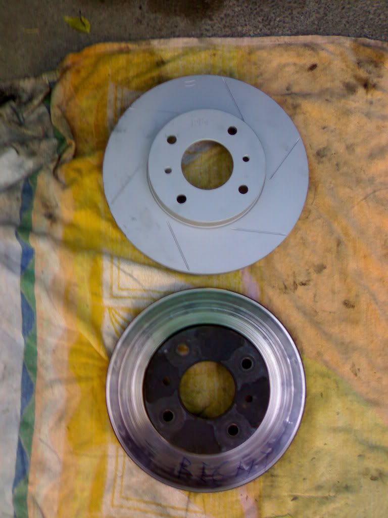

I got the pro street kit from power brake to replace my disks and pads but I've run into a bit of a problem. The torque member won't fit over the new disks... The new disks are 280mm and the ones that I took off I mesured to be 258mm.

Torque member is the bit the hold the rest of the caliper in place. Thats what its called according to the FSM. I'l post a pic in a few mins.

Post by Trance101 »
Here are the pics of the problem:

Post by Trance101 »
ya so it seems it the small brake syndrome ... :(
So does anybody know what is different with an sx thaqt suffer from small brakes? Are the brackets that the caliper mounts to different or is the caliper different? What would the best way be to get these to work....

damn those stock ones are tiny!
You might need the calipers of the 280mm model...or some custom spacers made.

Post by Enzio »
Your haste may have cost you a bit here....
My SX also has the smaller discs - the mountings on the hub are the same but the calipers differ between the 260 and 280mm discs.
The powerbrake kit for 280mm is about R3k and for 260mm about R2500.
So the solution is as follows:
If you've got the cash start looking for the bigger calipers, alternatively find out from powerbrake if you can swop the kit....
If all else fails rip out the angle grinder and switch your torque member into high gear.... :lol:
