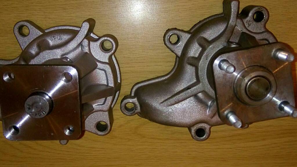

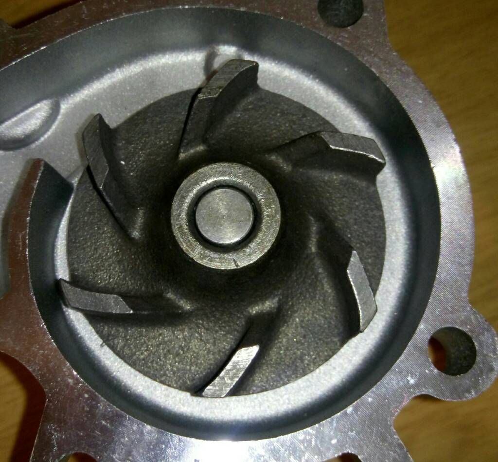

GMB pumps are fine never had issues you need to make sure you buy the correct pump because there are 2 pumps for a ca18 one the blade is a bit bigger and catches the block hence will fail very quickly the other pump is 1 to 2mm shorter and clears perfectly. OEM pump is well over R1000 these days and is not necessary ive drifted with my R300 GMB pump with no issues

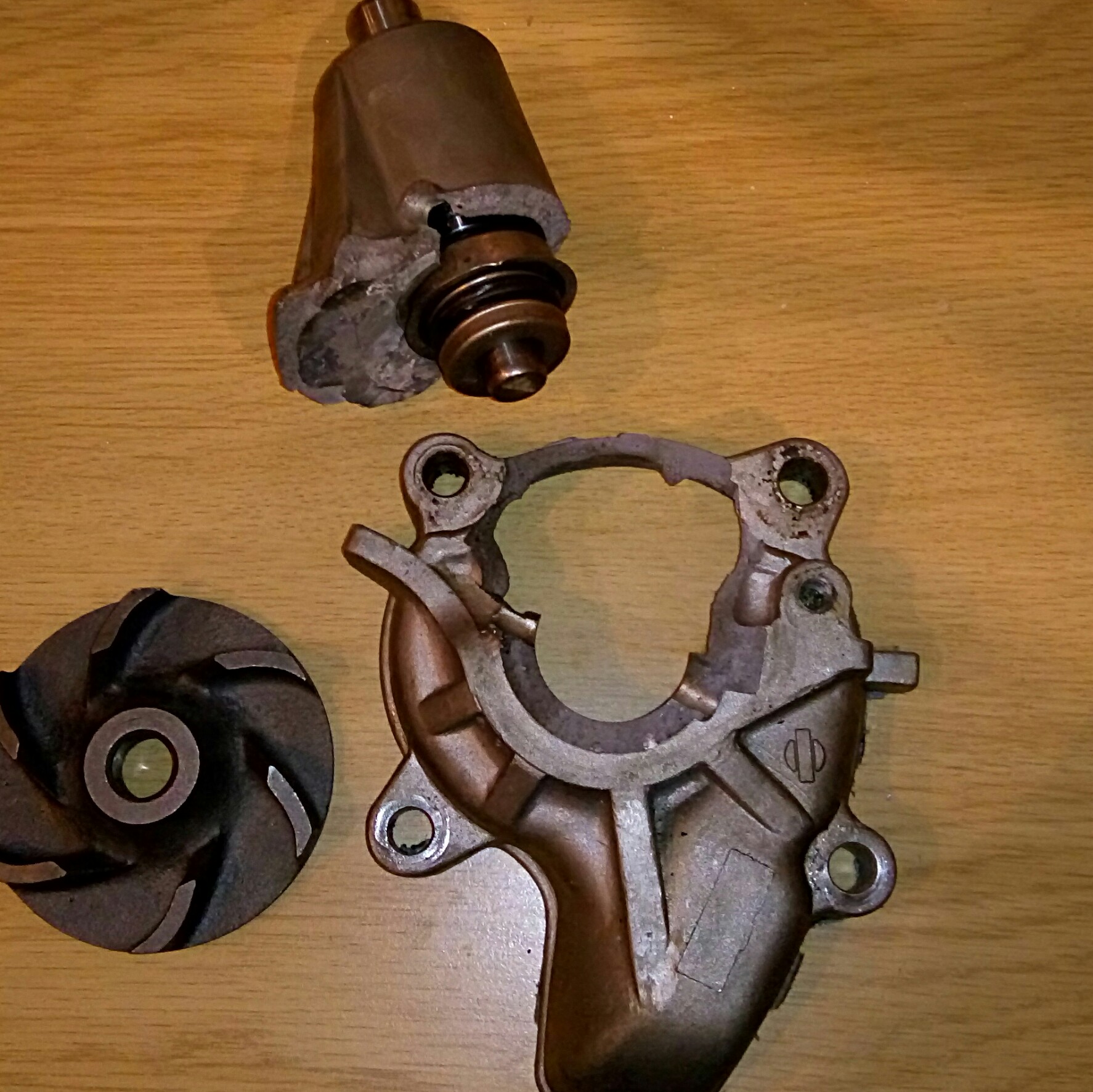

Last time I fitted a gmb replacement from middas the pump disintegrated and messed up the waterpump pulley. Bearings and seals where fine upon inspection.

Thats because you bought the wrong pump as i stated in my previous post there are 2 the incorrect on hits the bolck and will do exactly what happened to you

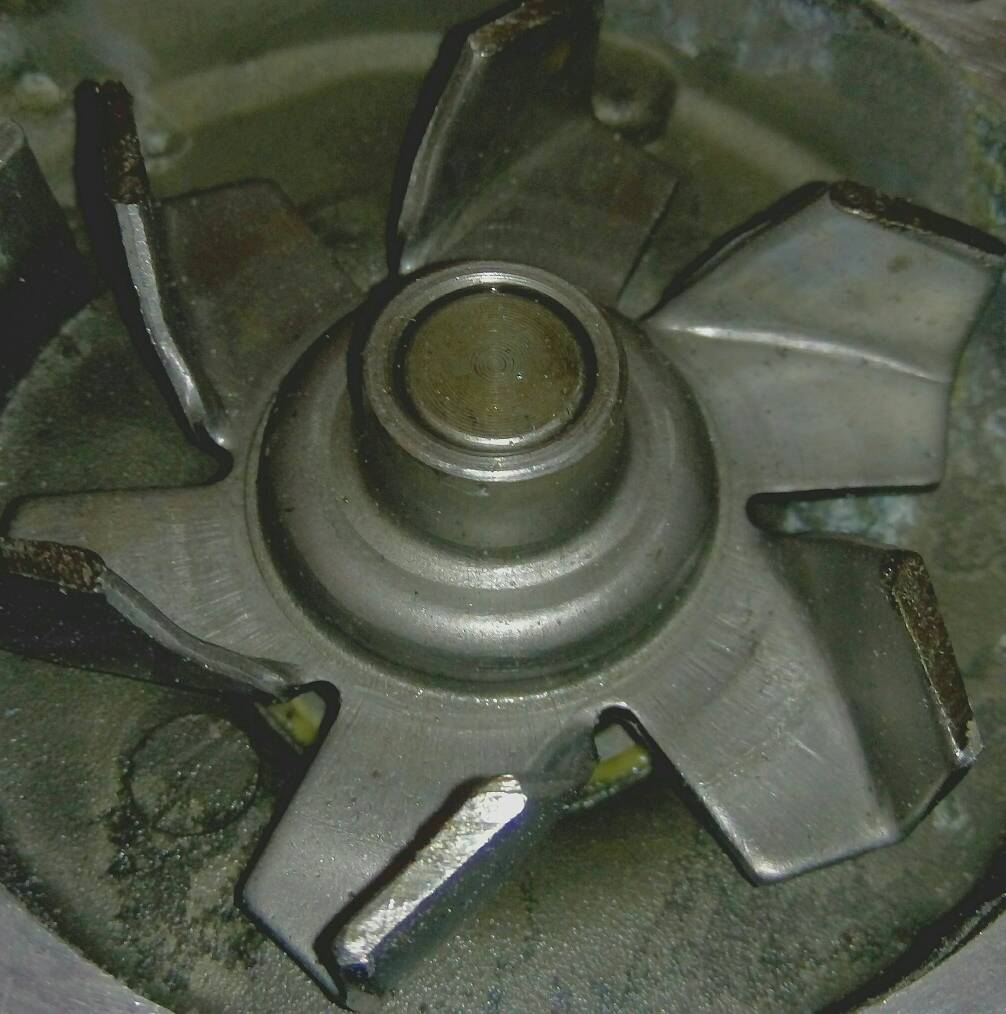

So I have pics of the one comming of and a replacement... But I checked the replacement pump and looks like it will hit the block.
But when I fitted the one comming of no weird noises came from it and did not hit the block.
Also the pump comming of seems to be ok bearing and seal.
Why did it start to grind against the block?

Or is it possible that the shift moved? Thus causing the impeller to grind against the block.

i dont think so never heard of them doing that only scratching cuz its the incorrect pump. Are you not over tightening the belt damaging the pump by ant chance?

The pump I took of is good. Bearing and seal is fine. Just some scuffing of the impeller.
