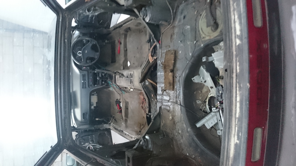

So pulled finger and got a few things done. Stripped the rest of the interior out including the dash. Hope I know how it all fits together again...
The next step is to remove the sound deadening and then prep for the cage. But one step at a time...

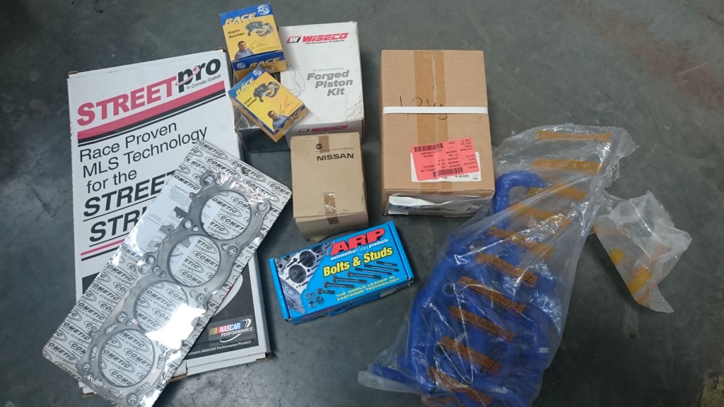

Here's a few items that will get used to build the motor one day...

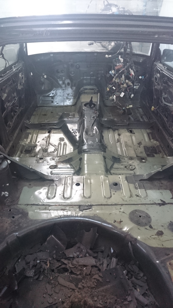

So did some more work to the car... Removed the sound deadening. Well most of it. Actually wasn't as bad as I expected, but I suppose I've only got the easy bit out of the way. Did a little bit of reading and watched a few YouTube video's and someone used Isopropyl Alcohol along with the dry ice. It super freezes and I think the alcohol helps to start the degrading process on the rubber sealant under the sound deadening.
So on the floor I managed to remove 90% of the sound deadening that was there. There are a few pieces left but I'll get them off eventually. The shitty bit still lies ahead. I couldn't get the rear wheel arches to freeze so most of that is still covered. I think that is going to be a tough area to get clean. Any idea what I can use in those areas except dry ice?

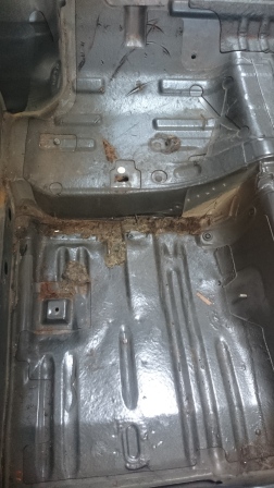

Here's a before pic of the floor in the passenger area.

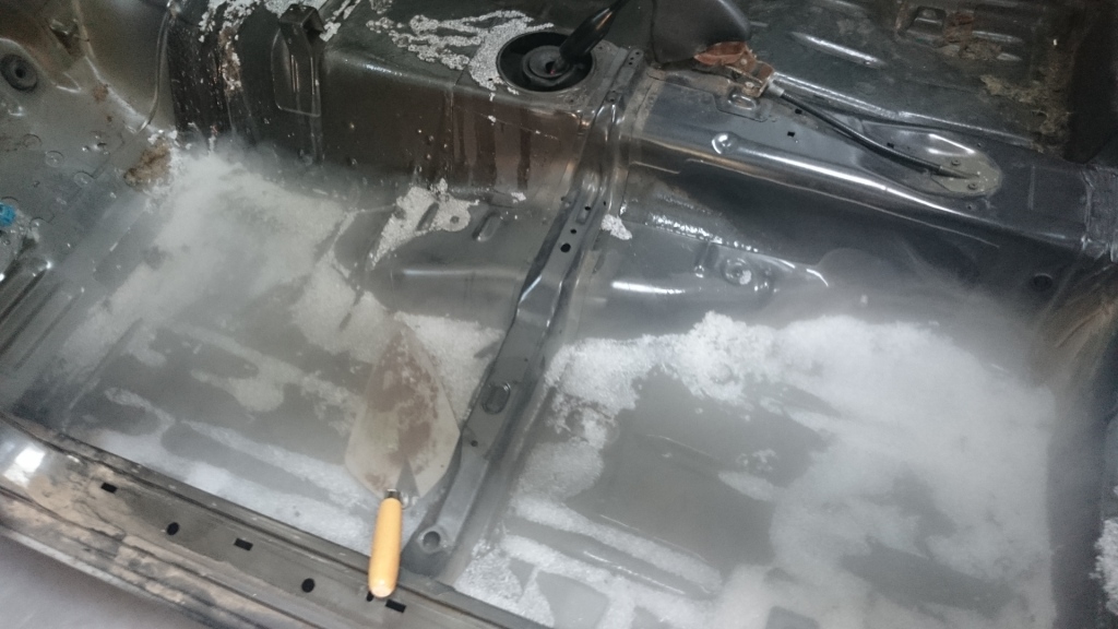

Here is a picture of the mixture cooling.
This is what it looks like 15 min after placing the mixture on the sound deadening.

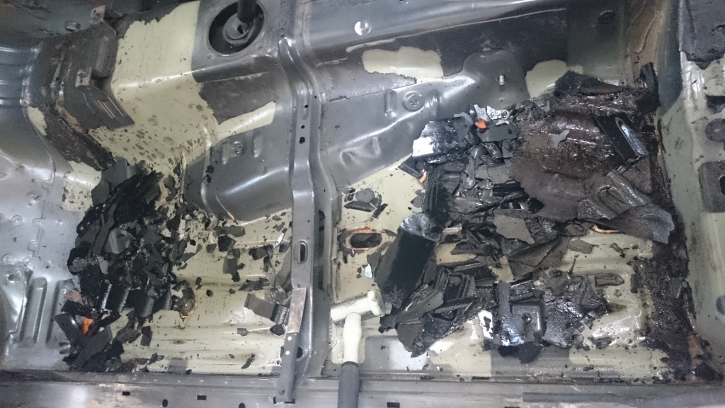

This is after cleaning. There is still some stuff left but we'll get to that at a later stage.
As soon as I have the last sound deadening out I want to run a wire brush over most of the interior to clean things up a little and get all of the stuff in the hard to reach places out.
Now it's beer time...![200SX_1eye [smilie=200sx_1eye.gif]](./images/smilies/200SX_1eye.gif)
