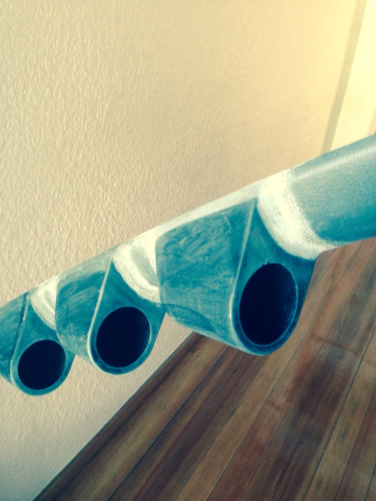

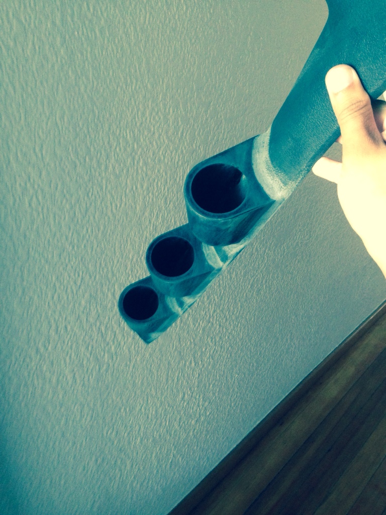

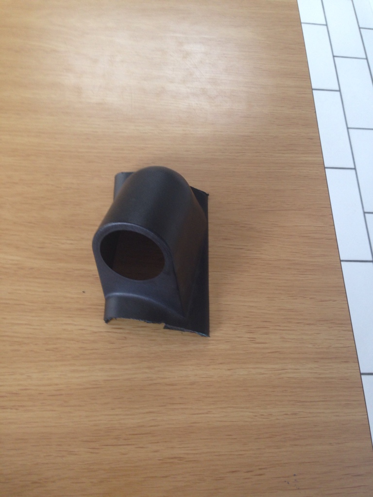

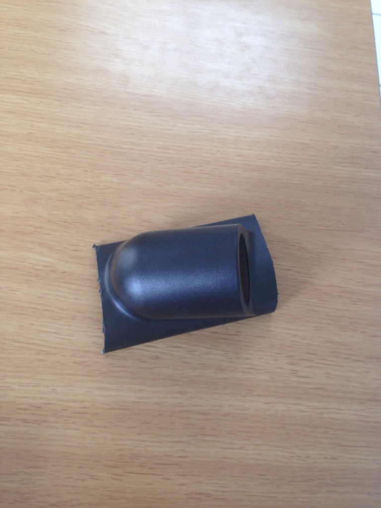

So i always wanted gauge pods on my A-pillar but nothing fits like oem all pods mounted to A-pillar are either to big or to small etc so got some inspiration from my budy that physically molded two gauge pods to his pillar so i borrowed the idea and tryed it and this was the result.

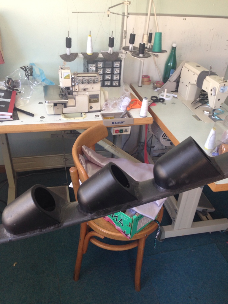

Gauge pods cut out individually

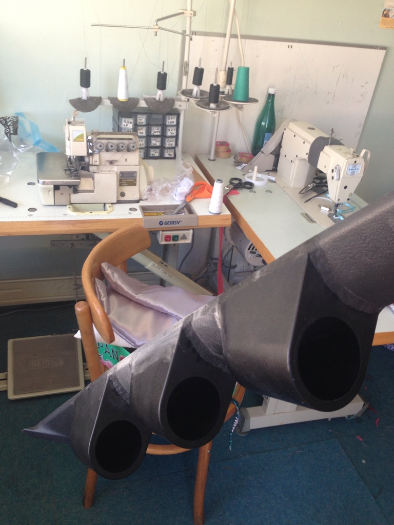

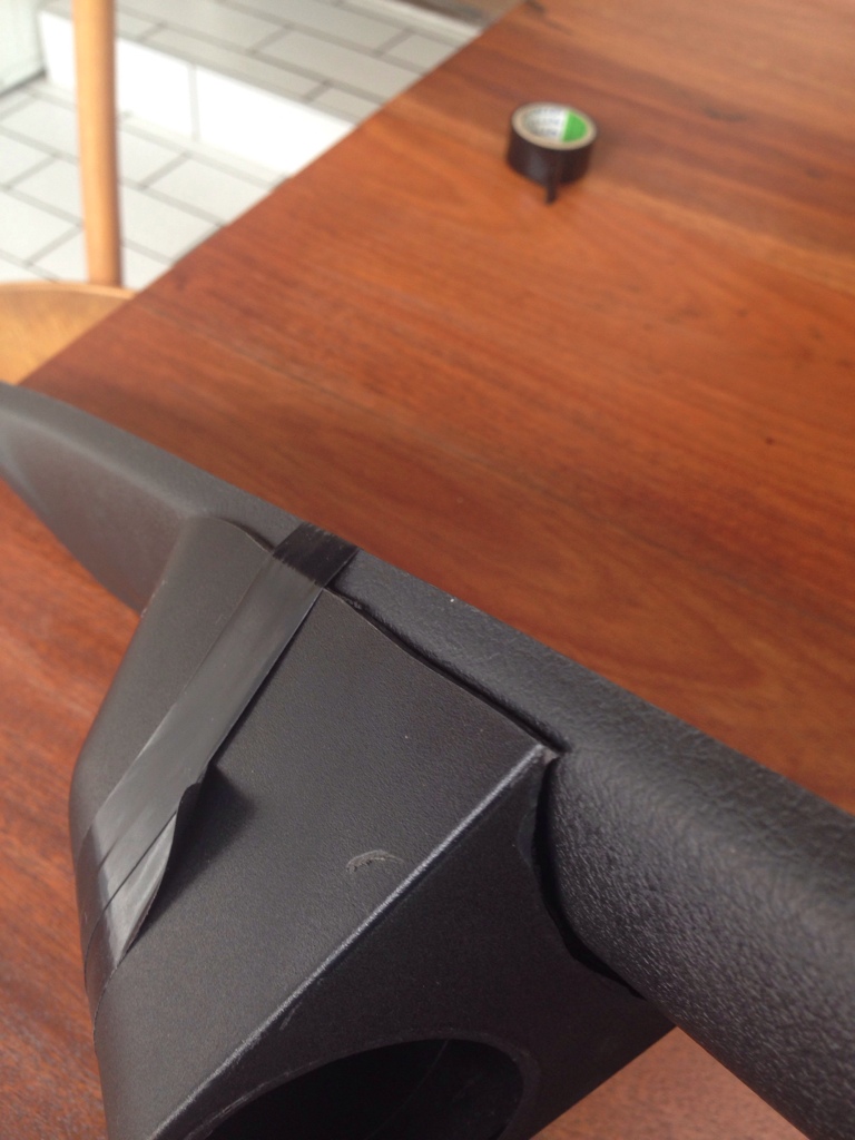

Then with lots of time and citing put it on the bench grinder till its almost a perfect snug fit, problem with s13 A-pillar is thats its very narrow so to make it fit with out overlapping is time consuming.

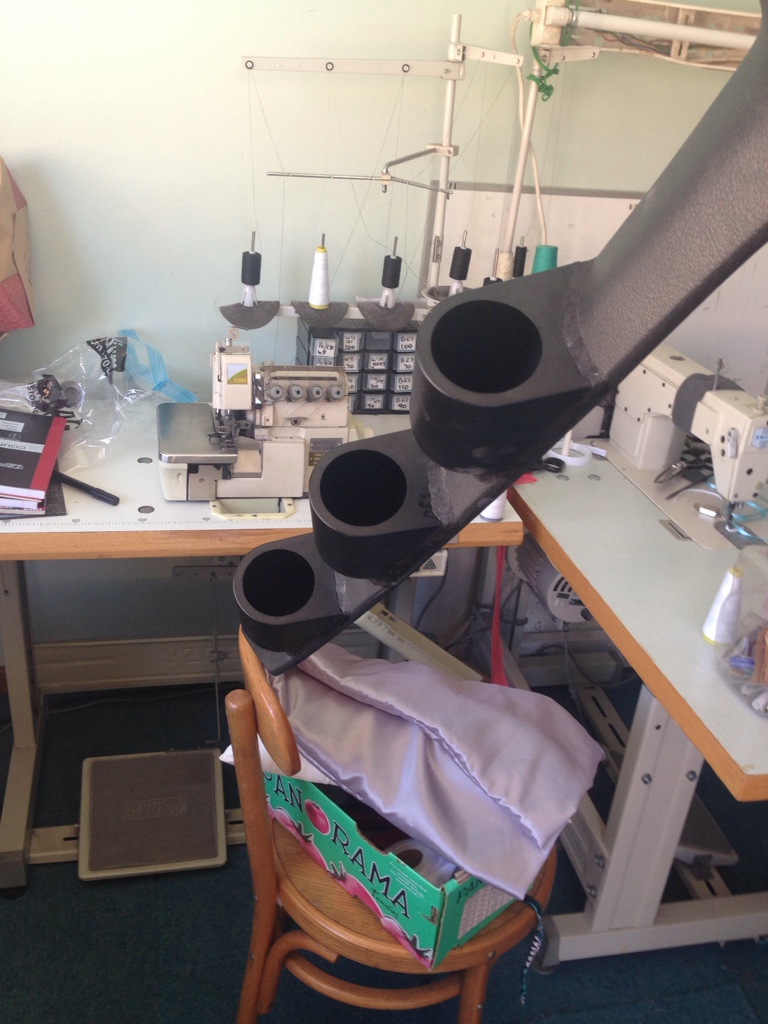

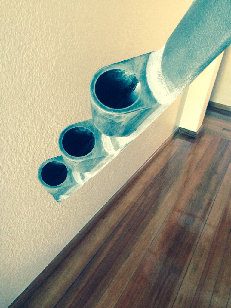

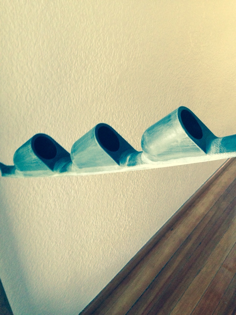

So joined all three pods with Q-bond and man that stuff is awesome, works really well.
Re: Stock gauge pillar modification

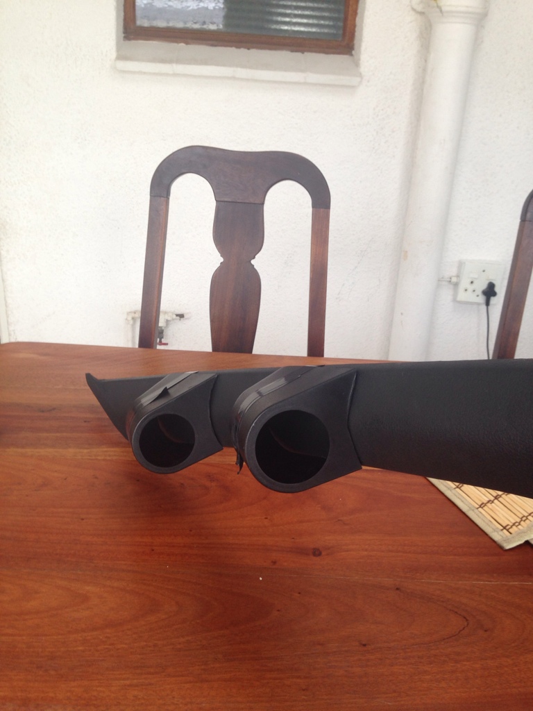

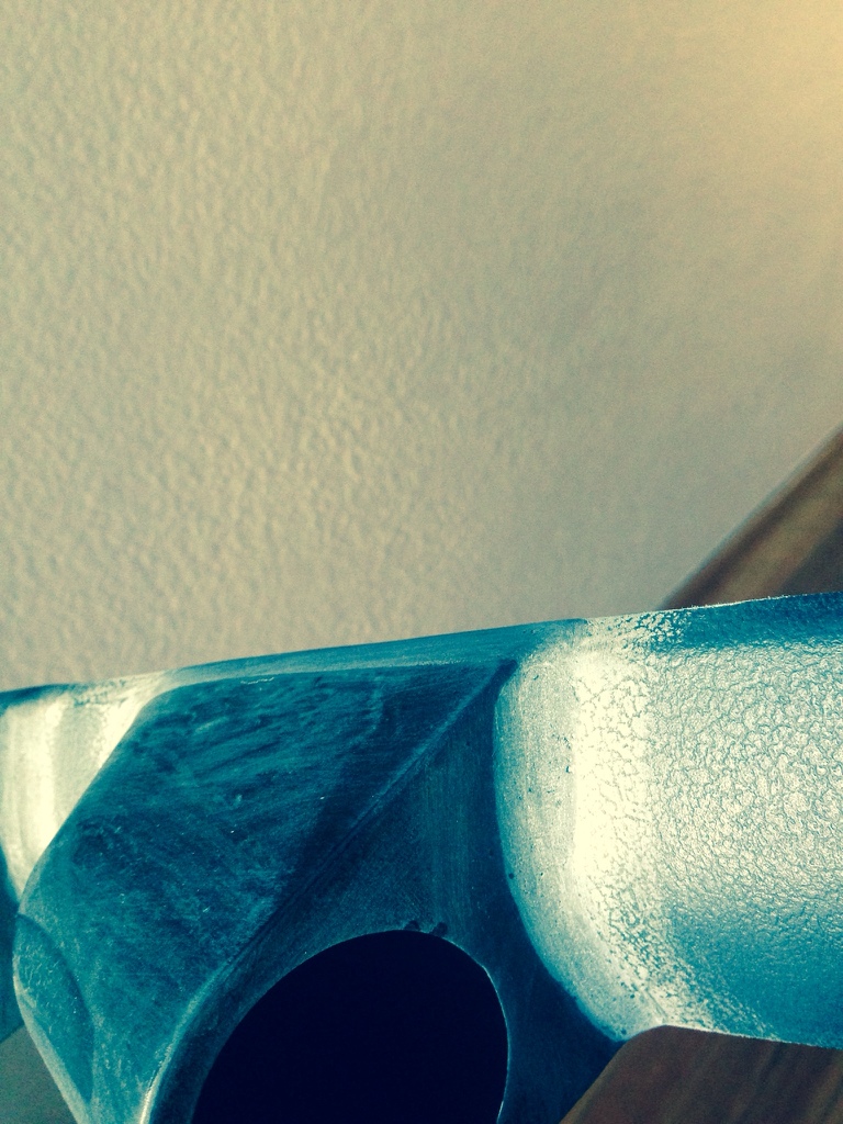

So after a full day of sanding my fingers off this is end product must still be sprayed.

Looking good dude! I'll be doing the same in the near future

Looks very neat bro!

Thank guys, just needs a spray now
