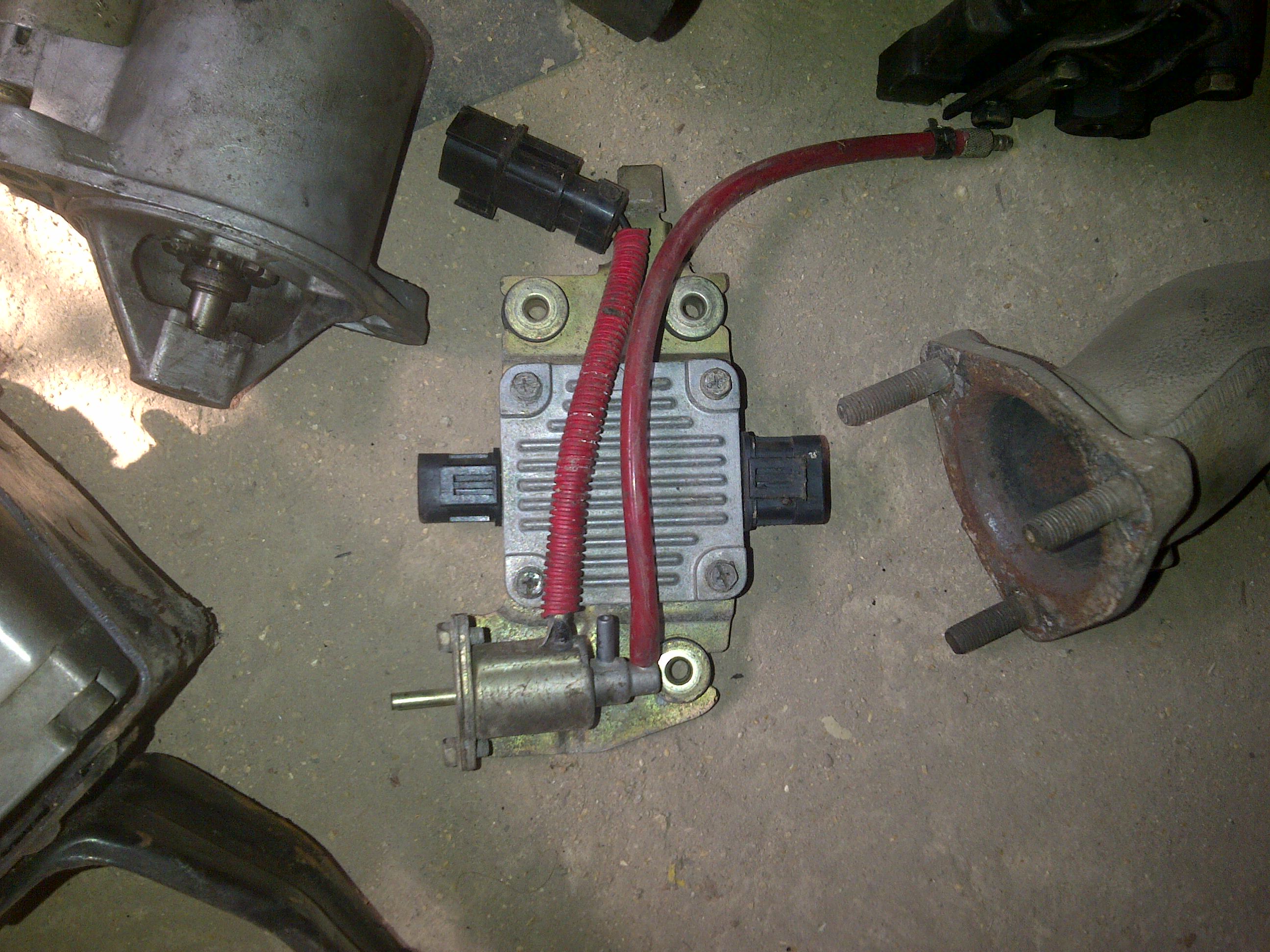

Is it possible to run MSD coils off the stock igniter?
What is the weakest like, the stock igniter or coils?
Re: Upgrading coil packs
Generally the coils....but if you want...I have an igniter for sale
I am going to fit LS2 coils with a built in igniter. I will need to make a loom to bridge out the igniter, so how much do you want for it? If you have a buggered one that would be better as I am going to break it to salvage the plugs.
The one I have is working unfortunately, I want R400 for it. Actually called a power transistor
