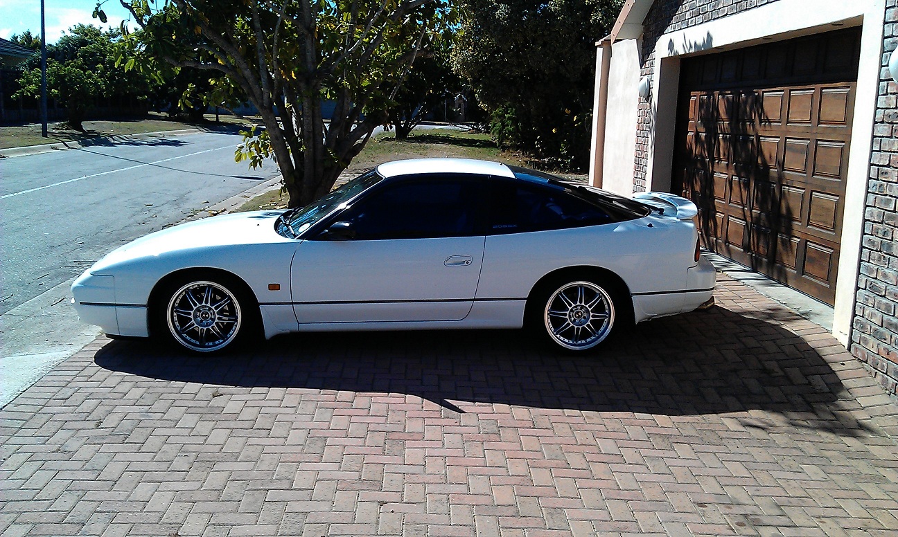

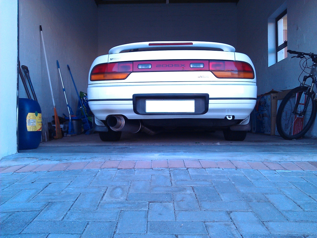

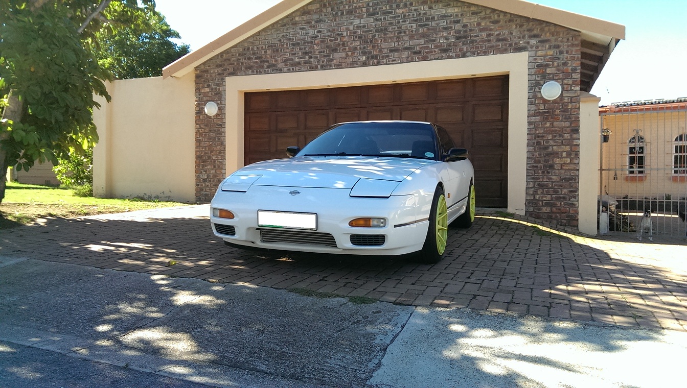

Hi Guys,
New member here. Just thought I'd upload some pics of my SX.
I got her like this about 2 years ago, The body is really nice and the interior even better, but the motor never made me feel confident.

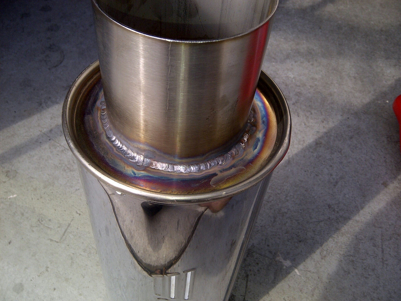

I fitted a custom 76mm exhaust, made by a friend of mine. It's a full 76mm system apart from the
down pipe, as I'm still running the stock turbo. I daily drove it for about 8 months and had a weird fueling issue that took me about 4 months to sort out.
I finally figured it our and fixed it, then this happened,

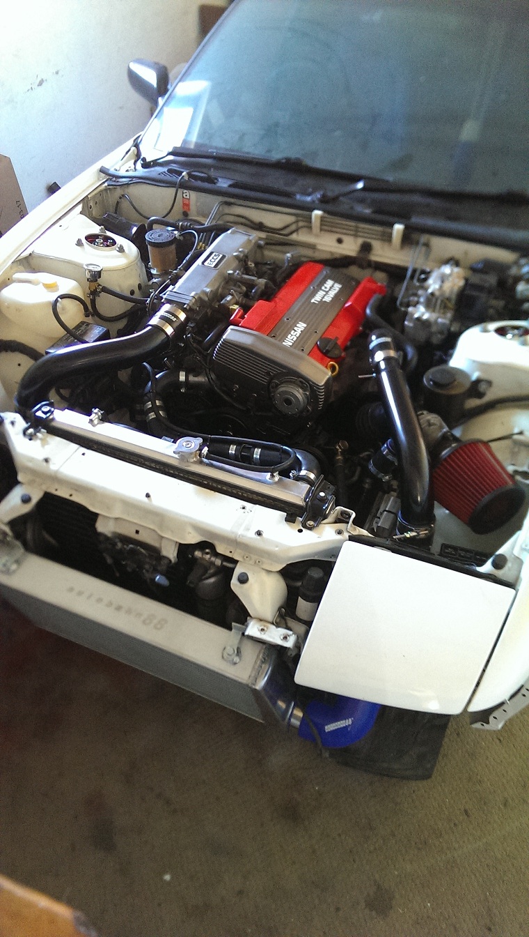

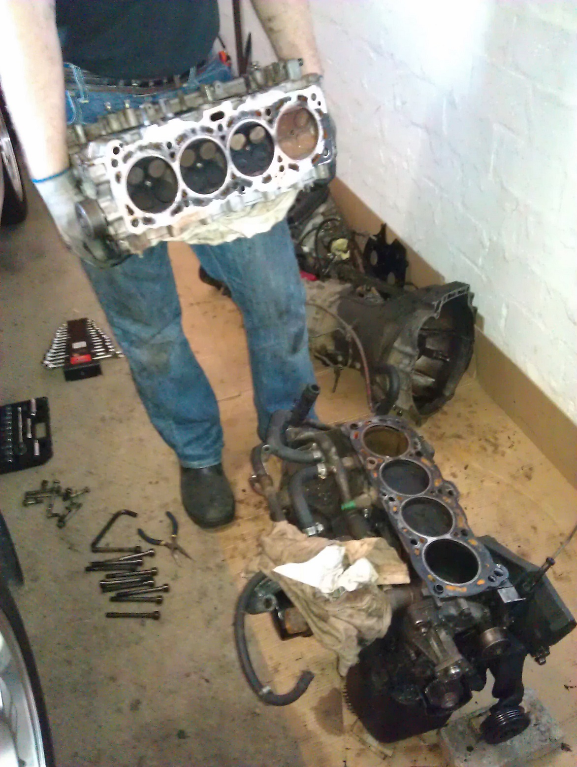

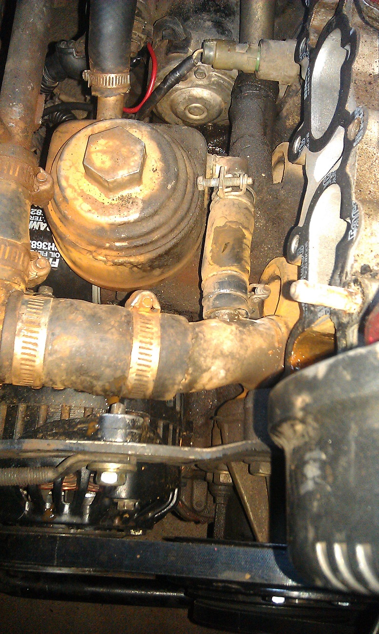

That caused this to happen,
I was ticked off, but I was planning on rebuilding the motor some time anyway, so I took it as a sign.

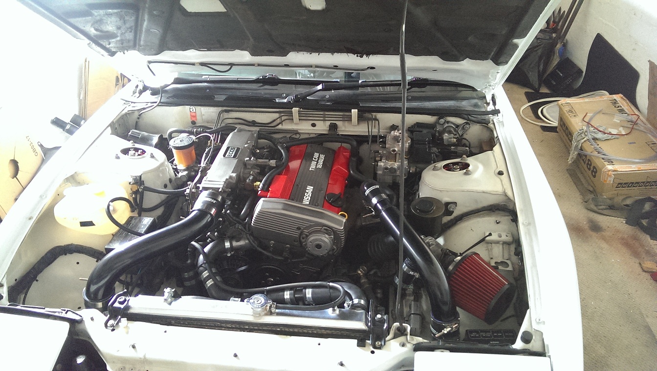

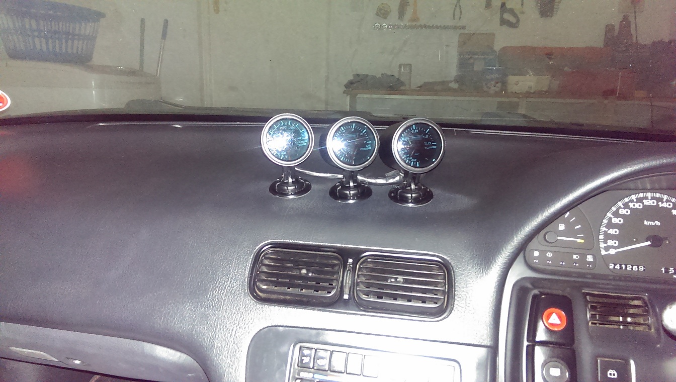

A complete rebuild followed, with a few added improvements. This is a 80% done pic , I also added some gauges (not pictured is my AEM wideband on the A-pillar) Here's a competed engine bay pic as she stands now. I stared her last week and drove her in nice
and hard. Everything looks and feels great! Also fitted my new wheels that I've been keeping in my spare room

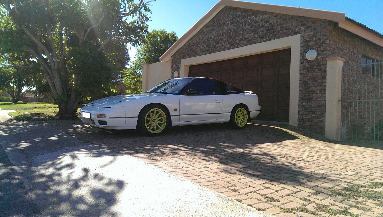

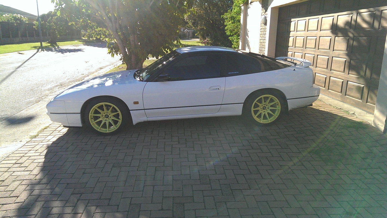

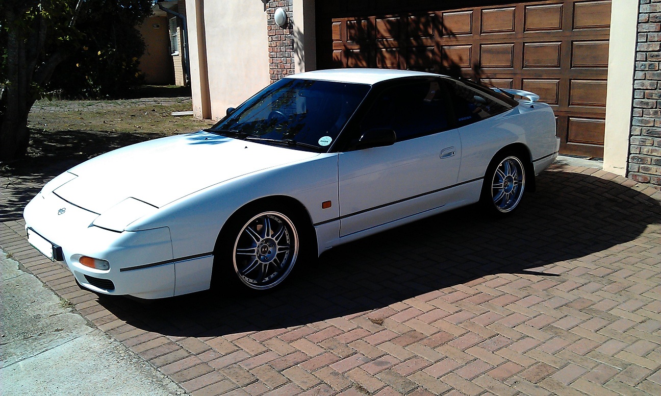

This is as she stands now,

@troopiec: The wheels are 17x9 ET30. I'm running a 5mm spacer in front cause the rim to strut clearance was only like 3mm, so now
its about 8mm. I wasn't comfortable with only 3mm clearance. I'm also running 225/45 tires, so there's a little stretch.
