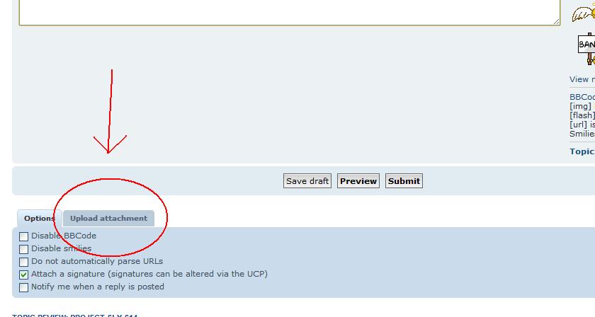

cool, thanx for all the help guys. will probably go for the sr20 turbo then. any ideas on power gains? also ccan anyone help me as to how i go about uploading pics? would like to get your guys opinion on my rim choice for vehicle.
Re: Turbo upgrade
their wont be huge gains but you will have boost throughout the full rev range it wont die off at high rpm like the t25

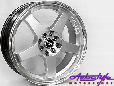

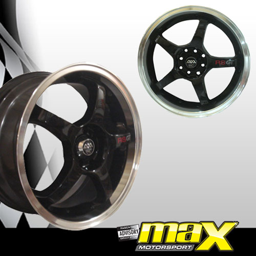

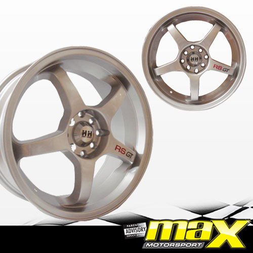

what do you guys think would look better on my 200sx s13? Bare in mind wat ever rim i chose i will be having them sprayed gloss black.
sadly i cant afford the ROTA GRID or ROTA GTR as they range from R 10 000 to R 15 000 ex tyres. where as these range from R 3300 to R 4100
Re: Turbo upgrade
they all look good lol personally id go with the second 1

i dnt no. the spokes look so skinny. im stuck on 1st pic but will change my mind if i get enough opinions. dnt want to make the wrong decision as rims are not something you change each month.

so can you guys help in my rims choice? whats your favorite out of them????????
