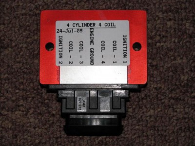

ignitor module has ignition 1 ignition 2 coil 1 to 4 and ground. ignition 1 and 2 go to the ecu ground to ground and each coil signal output to respective coil you coil consists of constant common posative ground and signal
