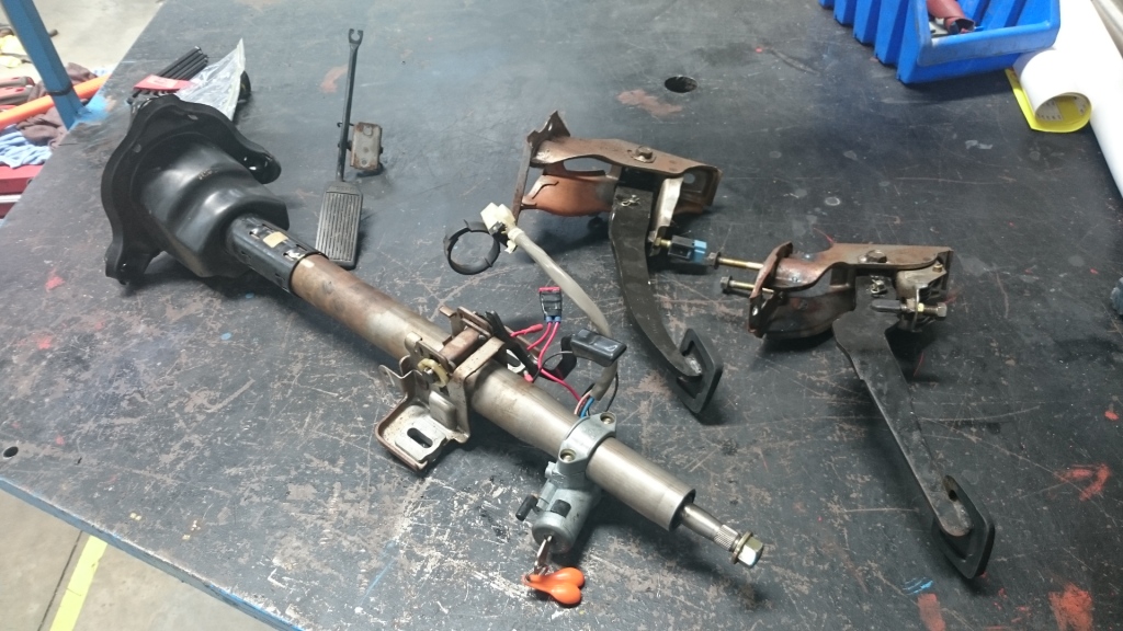

The guys who bend the piping can only get it done next week, so I took it easy this week and didn't rush to get things done. Spent some time today and stripped out the steering column and pedals to leave more room to manoeuvre when welding the cage. The stuff had to come out in any case when the interior got painted, so I figured I might as well get it all out. I hope how I can remember where it all goes...
This is more my pace. Spanners and screwdrivers suit me better than grinders. My patience gets too short and most of the time I just make a bigger mess of things.
The front all stripped and ready for the cage...
I'm going to strip everything down as far as I can so that it can get either painted or plated depending on the item. I hate working on dirty stuff so I'm cleaning and getting everything sorted as I go along. I don't want to get dirty if I have to work on it again in the future.

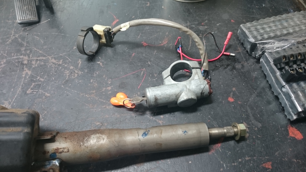

All of the offending items...
Had to remove the steering lock to meet regulations.

How difficult was it removing the dash and all that kak behind there?

It wasn't that difficult. Once the dash was out it was pretty simple. Just undo the bolts. I'm not putting any of the ducting back. So I just pulled it all out along with the heater assembly. The AC piping also needs to get stripped out but I'm working inside out...
