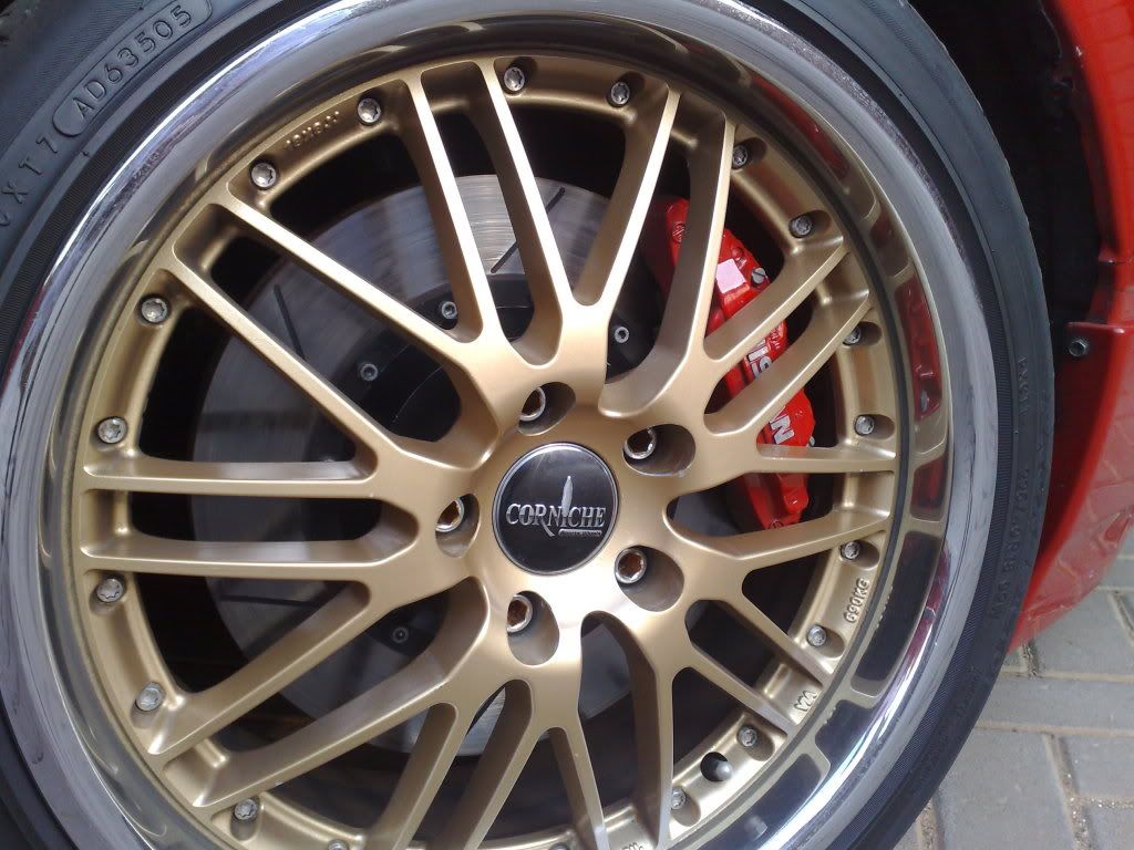

I have 330mm floating rotors and 17" still fit on the front.
<a href="http://www.flickr.com/photos/62487903@N00/541965496/" title="DSC00387 by Groot Mike, on Flickr"><img src="http://farm2.static.flickr.com/1424/541 ... 233b34.jpg" width="500" height="375" alt="DSC00387" /></a>
