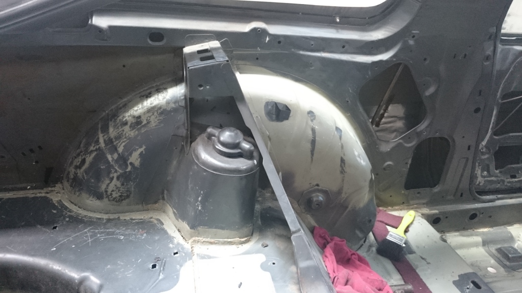

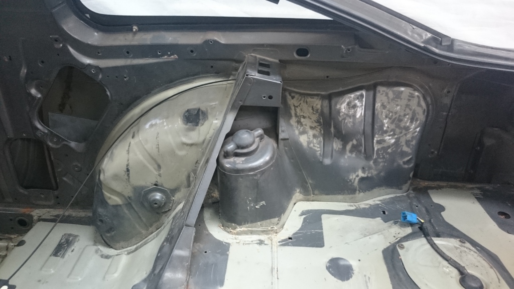

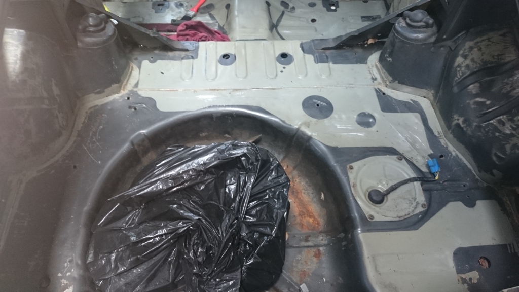

Ok. So all of the junk is now out of the trunk. :lol:
It took 10 times longer getting the seam sealer and sound deadening off the rear arches then I did getting the sound deadening on the floor and tunnel out. Glad this is over...
Here are a few pics of how the trunk and rear arches look all cleaned up. Still need to get the floor 100% cleaned up.

Re: PaKi's Track MoNSTeR
Remove the rear seat supports from around the rear shock towers, makes the interior much cleaner looking.

I was thinking the same thing. It seems like they are just spot welded on. I googled and a lot of guys have removed them. The cage guy is coming over on Sat to discuss the cage and the ideas I have.

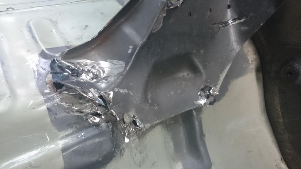

How did you guys remove the rear seat supports? I was hoping that you could just pop them off with a hammer and chisel so I tried it on one quickly now and low and behold, I tore the bottom metal. F#$k. Pissed off with myself now. Guess grinding on the weld until it pops is the correct way to do it then. Luckily the tear is small but it's still there...

So, stuffed that one up... This is why I don't do things like this... :oops:
Tried the drill route and that didn't work so lekker. Then got the grinder out and gave that a go. The results are less than impressive. Will make a plan to get the stuff removed next week. Enough suffering for one day... :facepalm:
