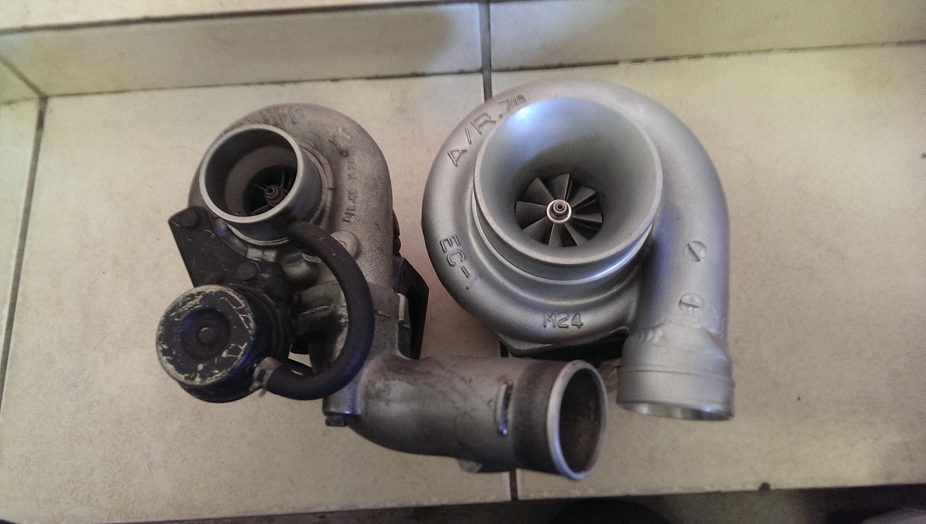

A friend of mine is turbo charging his Corsa bakkie and needed a turbo (after the one he was going to use failed on the dyno), so I told
him he can have mine. This started my big turbo swop...a little earlier than planned, but I wanted to get it done anyway.
Here's a comparison between the stock T25 and what's going on:
The big turbo is a sleeve bearing version of a GT2871r with a genuine Garrett GT2876r 0.70AR compressor housing. The exhaust side is 0.64AR.

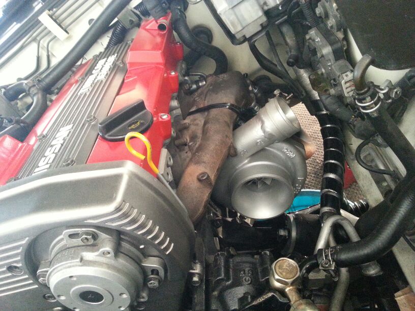

This is a pic of the mock up I did to determine what size spacer to run between the exhaust manifold and turbo. I have to do this as the big
comp housing fouls on the manifold.
The spacer should be done by the weekend and then i can fit it again to measure up what else will be needed. I'm expecting some lag with this
turbo, but hoping for not too much...guess I'll have to wait and see.
I'll update as soon as there's something to update about.

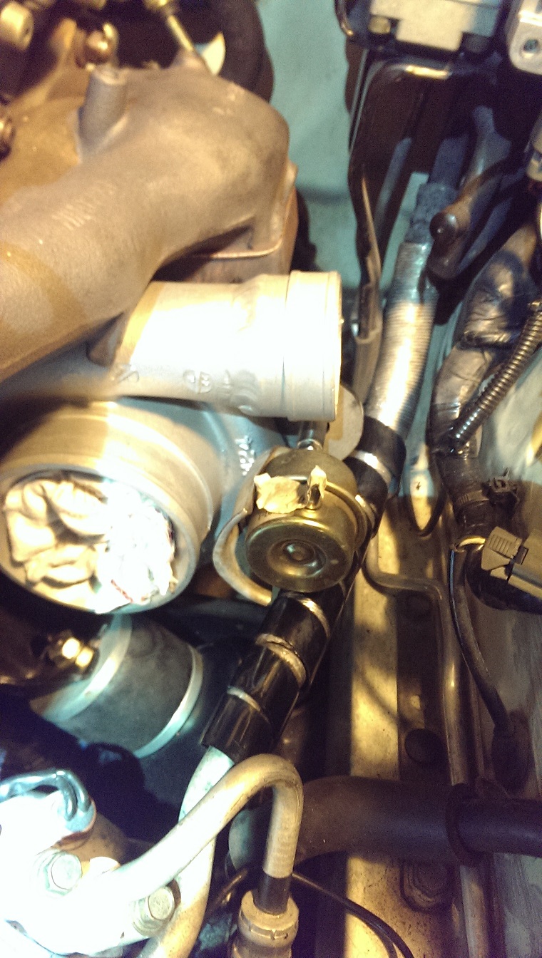

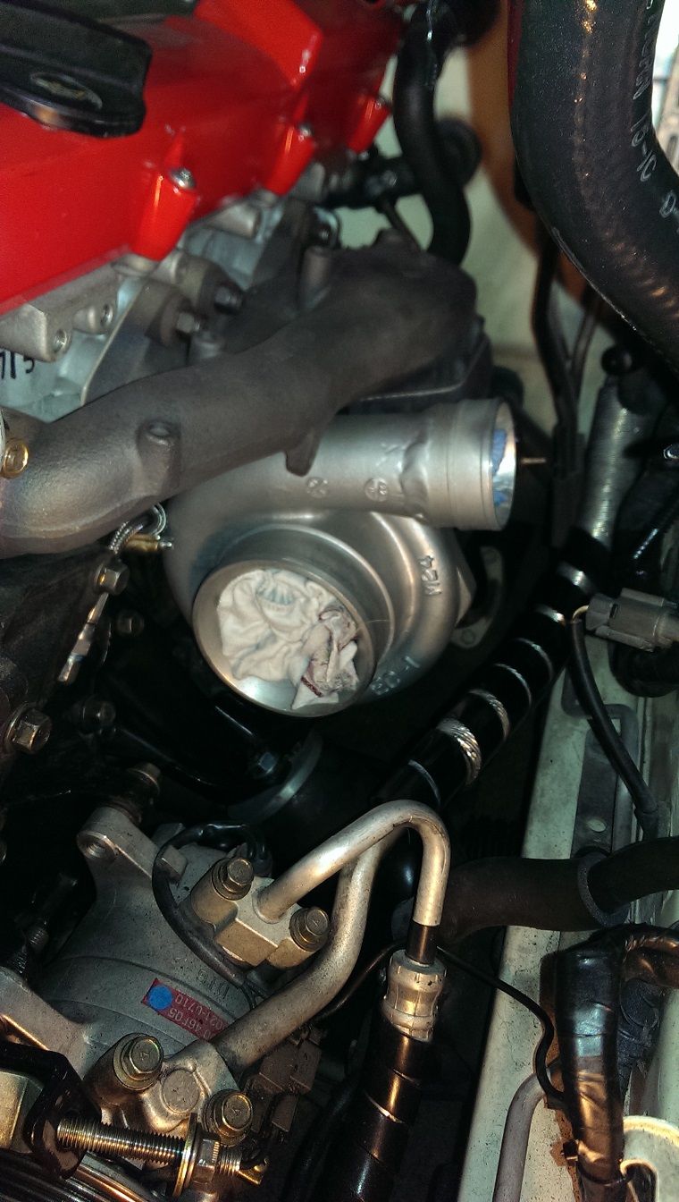

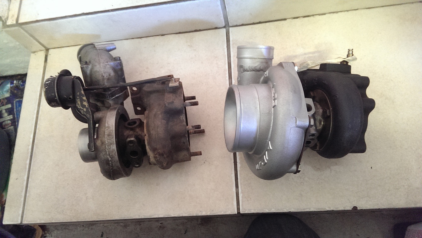

The good news is that the bigger turbo is in and running. It looked like this after it was fitted with the spacer and gaskets...

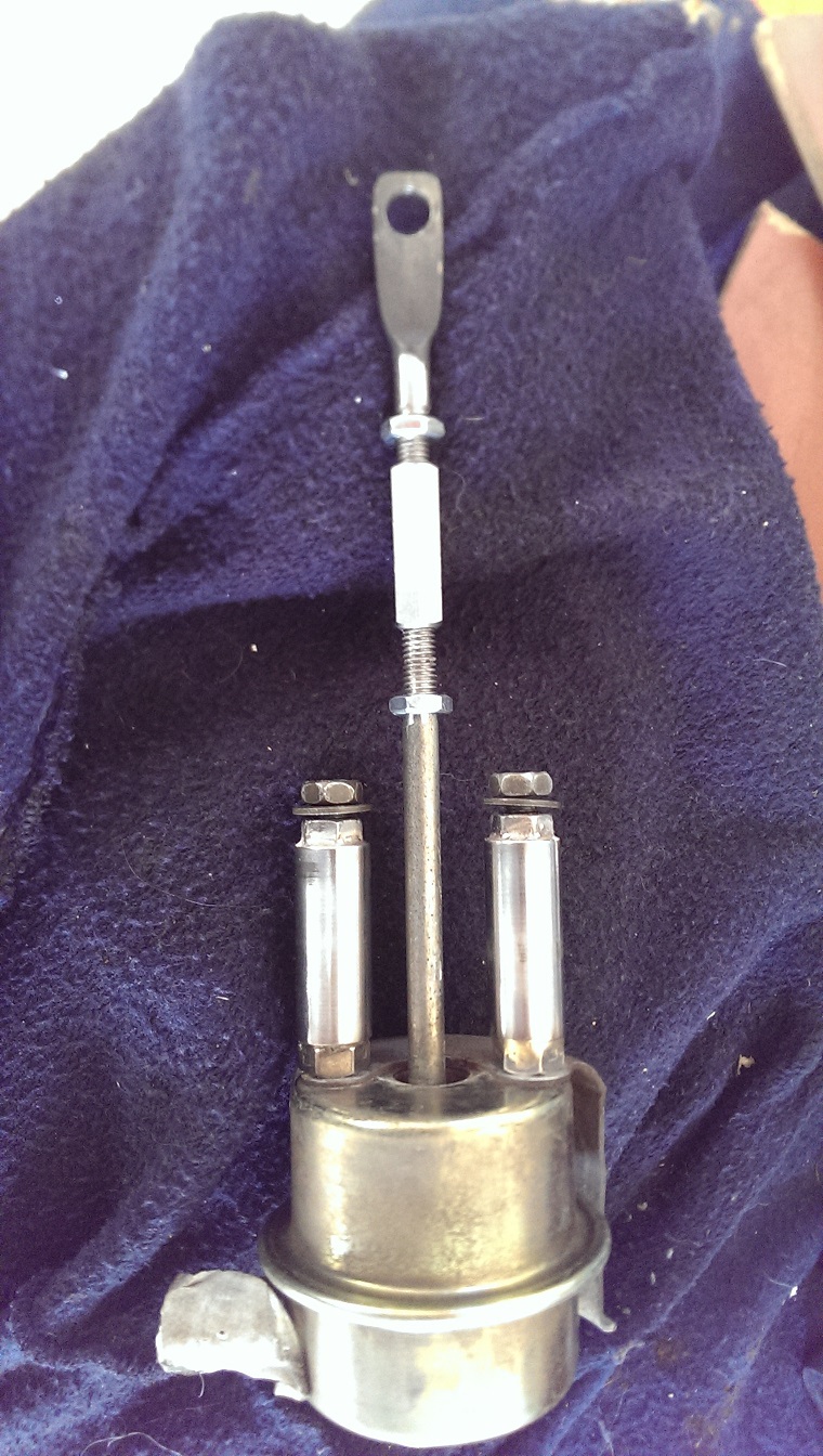

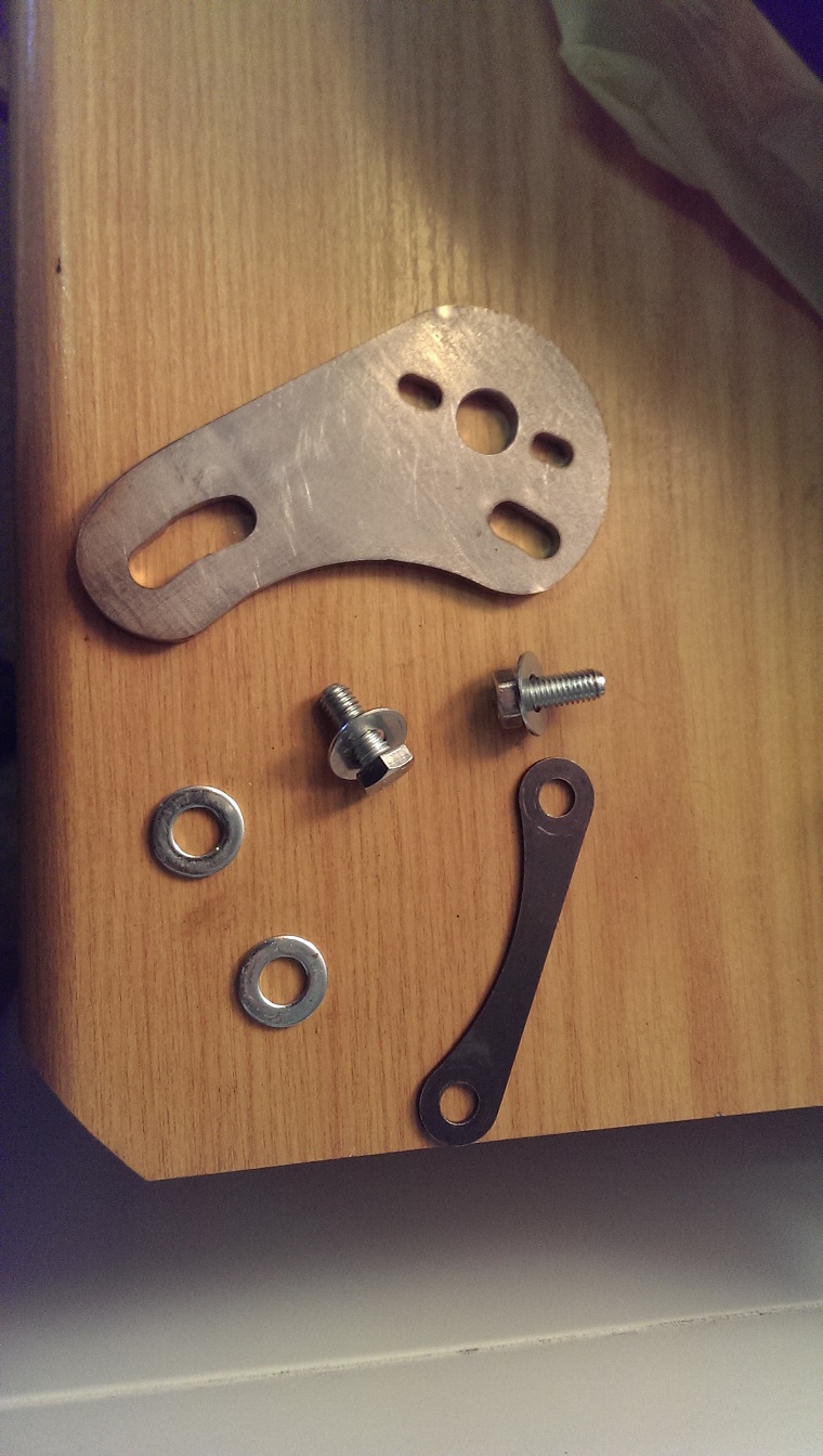

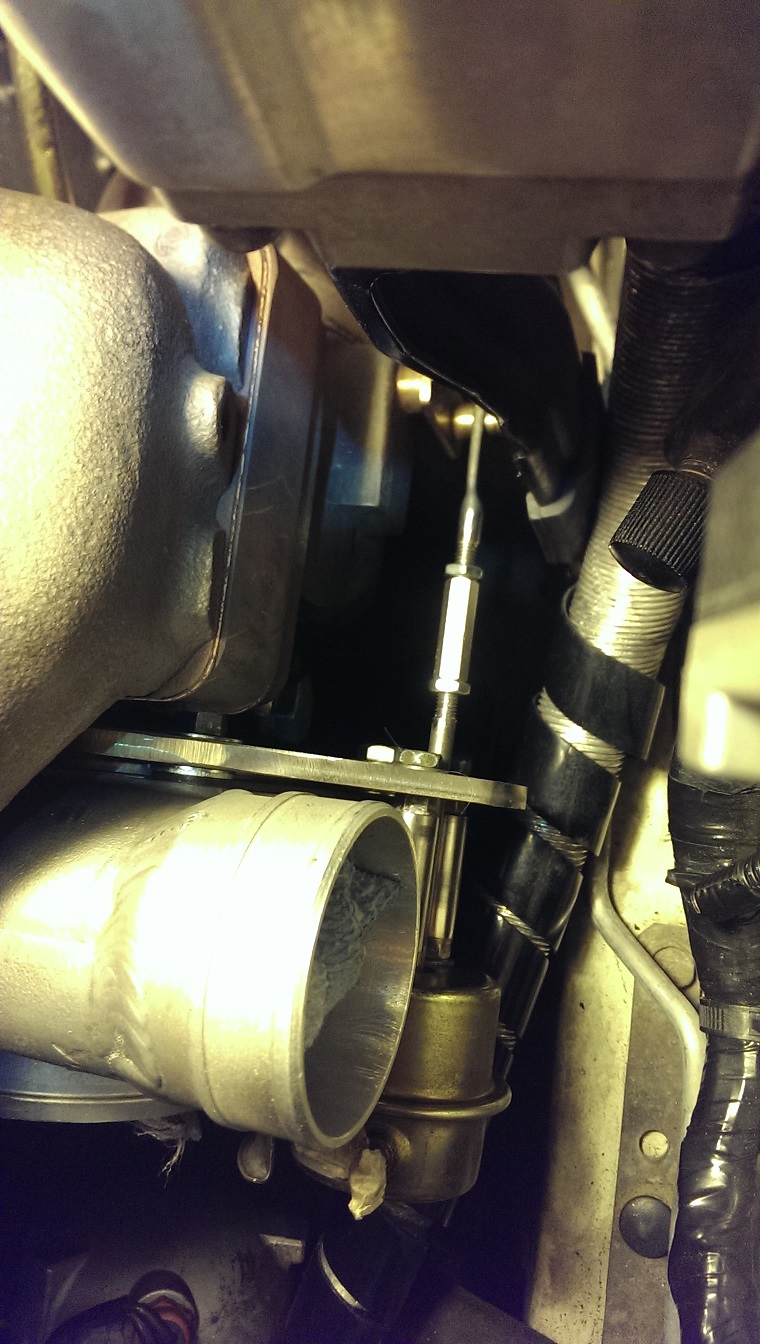

If you look closely there's no actuator to operate the wastegate flap. The front housing of my turbo is a 2876r housing so it
doesn't have provisions for a actuator bracket, so I had to make a custom one for the actuator I had (off a T25G i think). Here's
some pics...I'm sure you'll be able to figure it out looking at the pics. I used the bolts that holds the comp housing to the core...

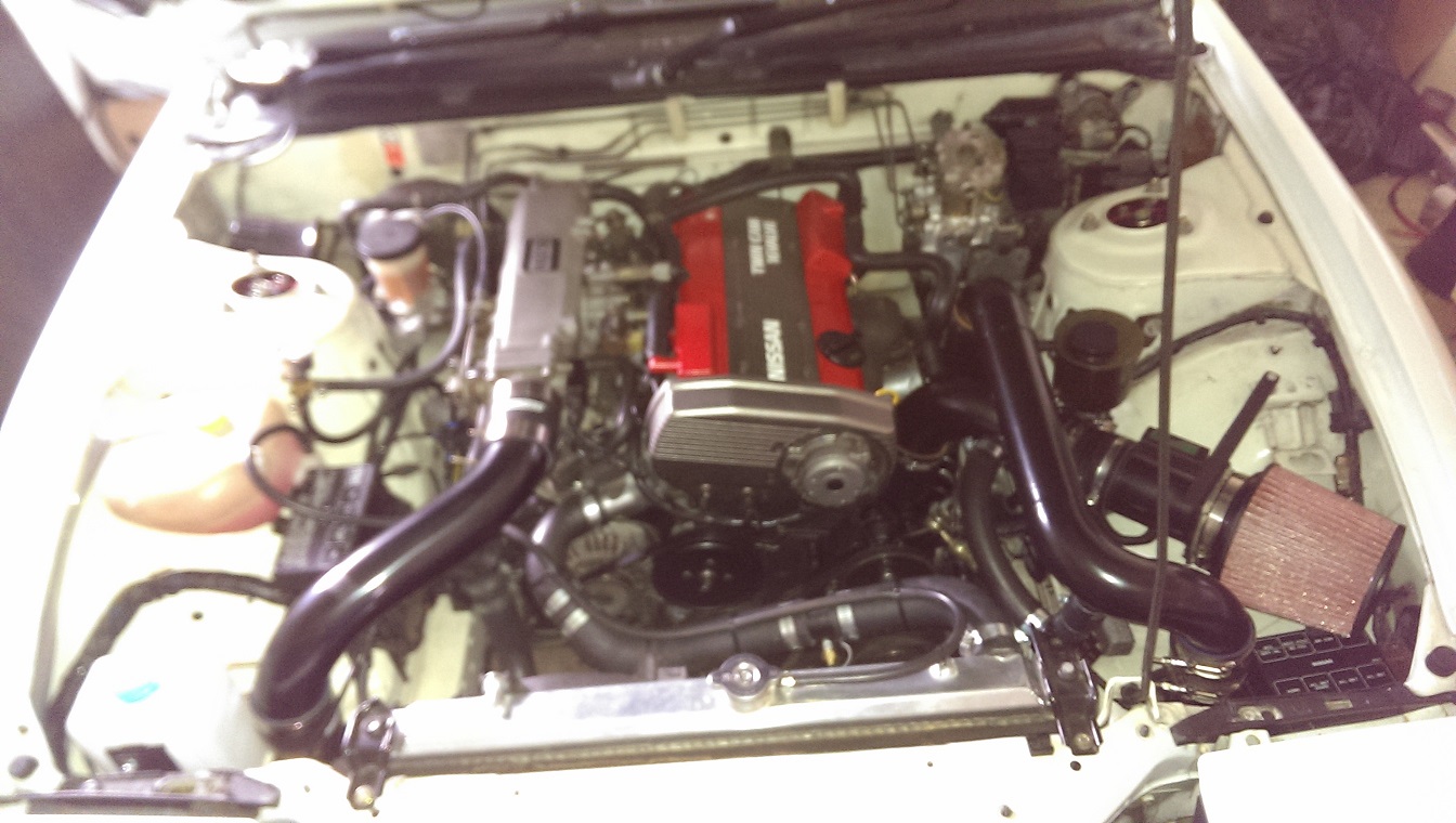

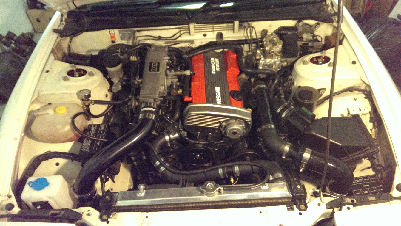

And how the engine bay looks now (had to go back to a cone filter due to space)...
So, onto the bad news...it looks like I won't be able to tune my setup properly with the Piggyback Chip, there's just some
issues that I can't get right. I suspect it's cause I've made quite a lot of big changes for the piggyback to get back into line.
So...the answer will be a custom Eprom chip written by RS Enthalpy. It's currently being shipped to me and should be here
shortly. I'll socket my ECU and run the custom Eprom without any changes from the piggyback.
I'll let you guys know how it turns out. Hold thumbs please :D
