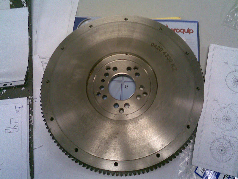

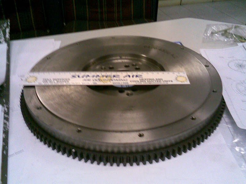

Lightened flywheels reduce the amount of energy produced by an engine that's spent in moving its components (parasitic loss). Since flywheels are solid, unsprung components of a vehicle's driveline, a lightweight flywheel will decrease parasitic loss at a constant rate, improving a vehicle's horsepower and torque output (measured after the flywheel) throughout it's entire rev range.
FICTION
At a constant rpm, horsepower and torque both change proportionately. If installing an aftermarket header, for example, seems to decrease torque but increase horsepower, the fact is that at the rpm where torque is decreased, so is horsepower (and vise versa)-changes are simply more apparent to horsepower at higher engine speeds, and torque at lower engine speeds, due to the function of calculating horsepower from torque. Installing a lightweight flywheel doesn't decrease torque, but it does decrease inertia, meaning more torque will be needed to break traction with a clutch-kick (drifting or burning out), or to accelerate a vehicle off the line during a launch (drag racing, daily driving).
