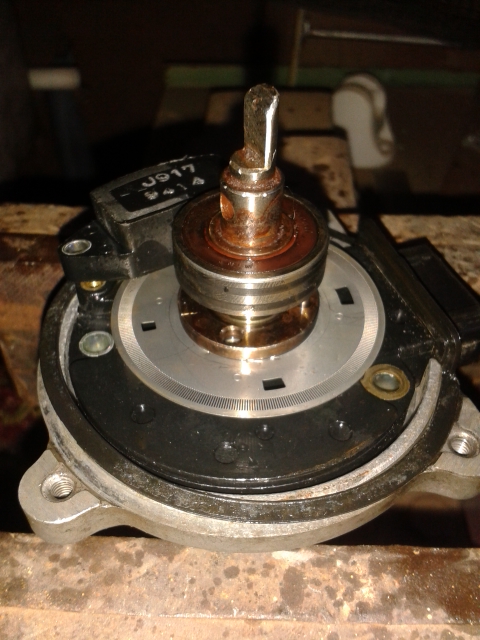

Any advice on what to do next. I can't seem to get the std nissan disc out of the CAS to replace it with the dicktator disc.

Re: Wiring a Dicktator Wasted Spark up to a CA18DET For Dumm
Post by Tobievandernest »
Here is a link for anyone who wants instructions on how to replace the disc in your CAS with a dicktator disc.
