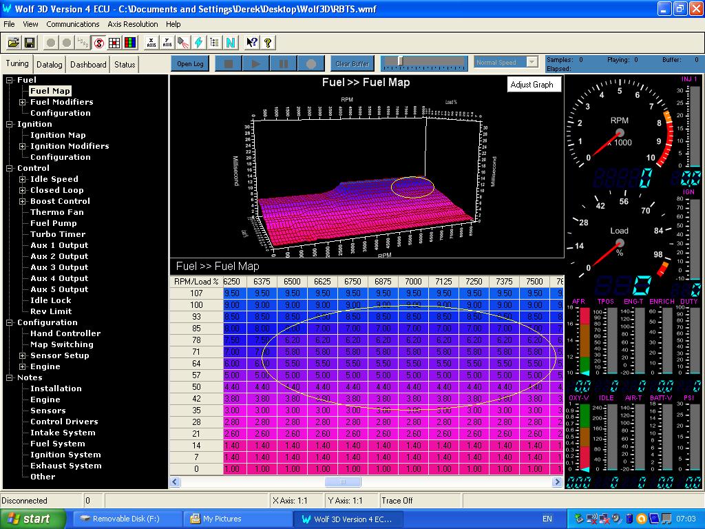

Hi guys, sorry I'm at hom not having internet, made a plan to get everything to the phone and then post it, the fueling map does not look to bad in my opinion, the timing map does not look good in my opinion.

Here is pics of parts of the maps.

Personally I don't think the power or power curve is bad at all, specially from a ca... Time wise, a dicktator is normally tuned in an hour, so half an hour for fumbling his way around I don't think it's bad either... I would though specify the type of running I want before it even starts, that way of its not too my liking I take it back and it must be sorted out... But ye I agree, every 1000rpm is a bit lose for a car that's being tuned for so much power... A bit dangerous in my opinion... But it is still impressive power...

Needs some more mapping around those cells

Incorrect timing can make an engine real crap to drive while the correct timing here will put a serious smile on your face. Don't be scared to chase timing up to say 0.5 bar boost.Obviously check it out carefully but you will not believe what it can do to the driving experience.
Thanks BK, it is something I have to do, there is parts where my afr jumps to 17 on very light loads, there is some work to be done on my fuel and timing map, the problem is to get someone to drive while I do that, for some reason my afr gauge and the ecu does not record the same afr amounts, so my data logging does not help me much.
