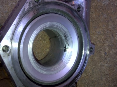

Take your air intake pipe off of the turbo comp housing, feel if there is play on the shaft fornt to back or accessive side movement.
When you pull ot push the turbo shaft it must have no play, if it has, there's your problem.
Taking the compressor housing off will looks like this...
