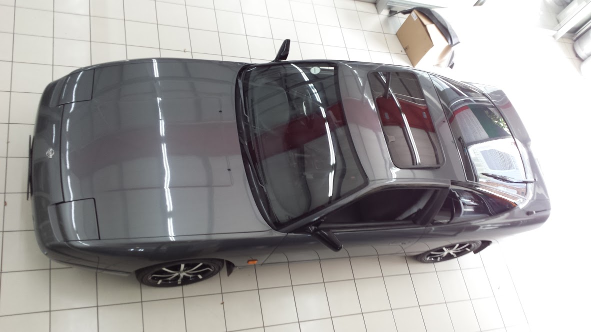

and awesome ride, i like the wheels
best factory colour for the s13 in my opinion, and looks like a fine example
also really nice photo's and cool location
