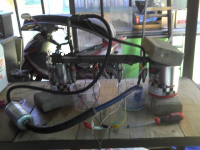

After reading this thread http://www.nissanownersclub.co.za/forum ... &start=285 figured it would be a good idea to clean mine so started to research sounds like a good idea will do a write up this weekend when i do it
Re: Injector Cleaning
So i used Fuel system cleaner works very well but you will need to put a filter in aswell

Very nice! Will need a testbech like that at some stage

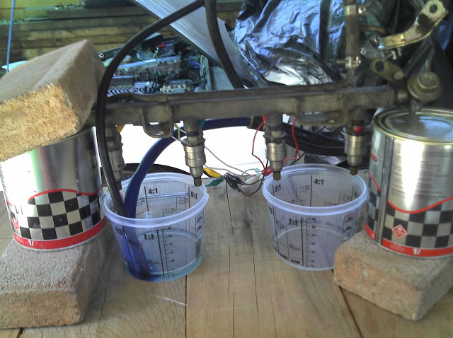

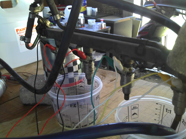

NB: while doing this make sure to put in a filter you dont see it in the pic but you need to do it i had alot of bits and crap at the bottom at the end
