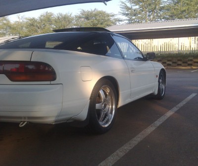

depends on the width of the rim and how flush you want it to sit. but around et25 is what you would want for a flush'ish fitment.
For reference here is a pic of my old wheels 7J et35, not the best photo or angle though.
