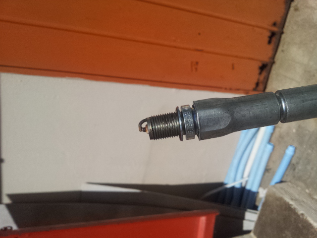

Check the tail pipe for "crystals" Run it hot and check the tail pipe for steam or vapor. The fact that it misfires tells me water into the cylinder. Pull the plugs and again check for super clean plugs or "crystal" on the plug..

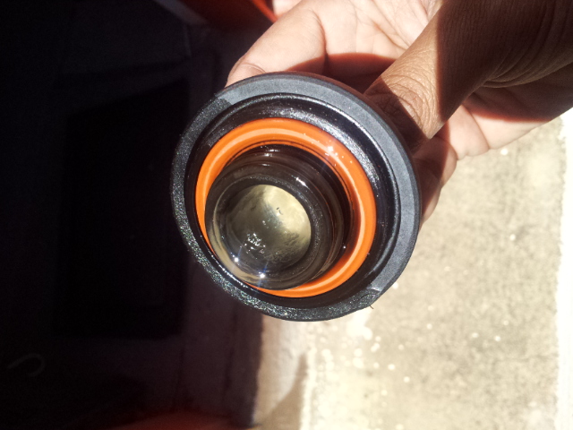

Hey Toby....Mr President....my bet is also HG, also check oil cap for white/cream coloured oil residue inside of cap, oil meet water...water meet oil.

Missing water and no leaks, plus miss fire at low rpms. Thats what mine was doing when the water leaked into the cylinders. Although it was slow to disappear and I never saw any mayo anywhere, just the water getting less, until a much much later stage when more overheating occurred.
Do compression test but sounds like new HG and a skim is needed.
