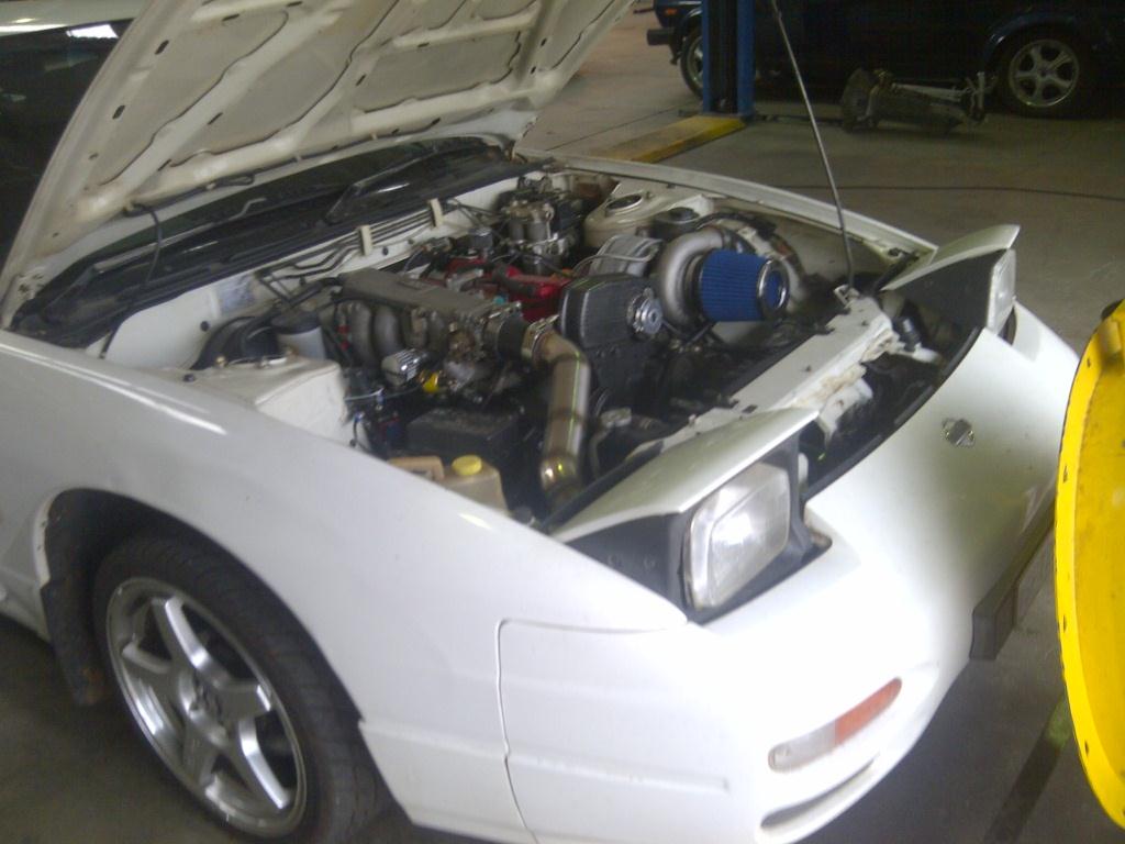

Installed motor
Moved the Battery to the back
Installed a surge tank at the back
Installed extra fuel pumps
Painted the branch
Then i decided Bbm'ing a girl while operating a crane with was a good idea...
Fitted a new 76mm exhaust
Tried to start the car for the 1st time and then we toed the car to see if we can get in going.....Eventually after wasting one day we found the new ecu to be at fault.....Although it gave spark and fuel, it didnt want to start the car so i had to send it in. But the service was great and i got it back asap (Thanks Dictator and MRD Racing)

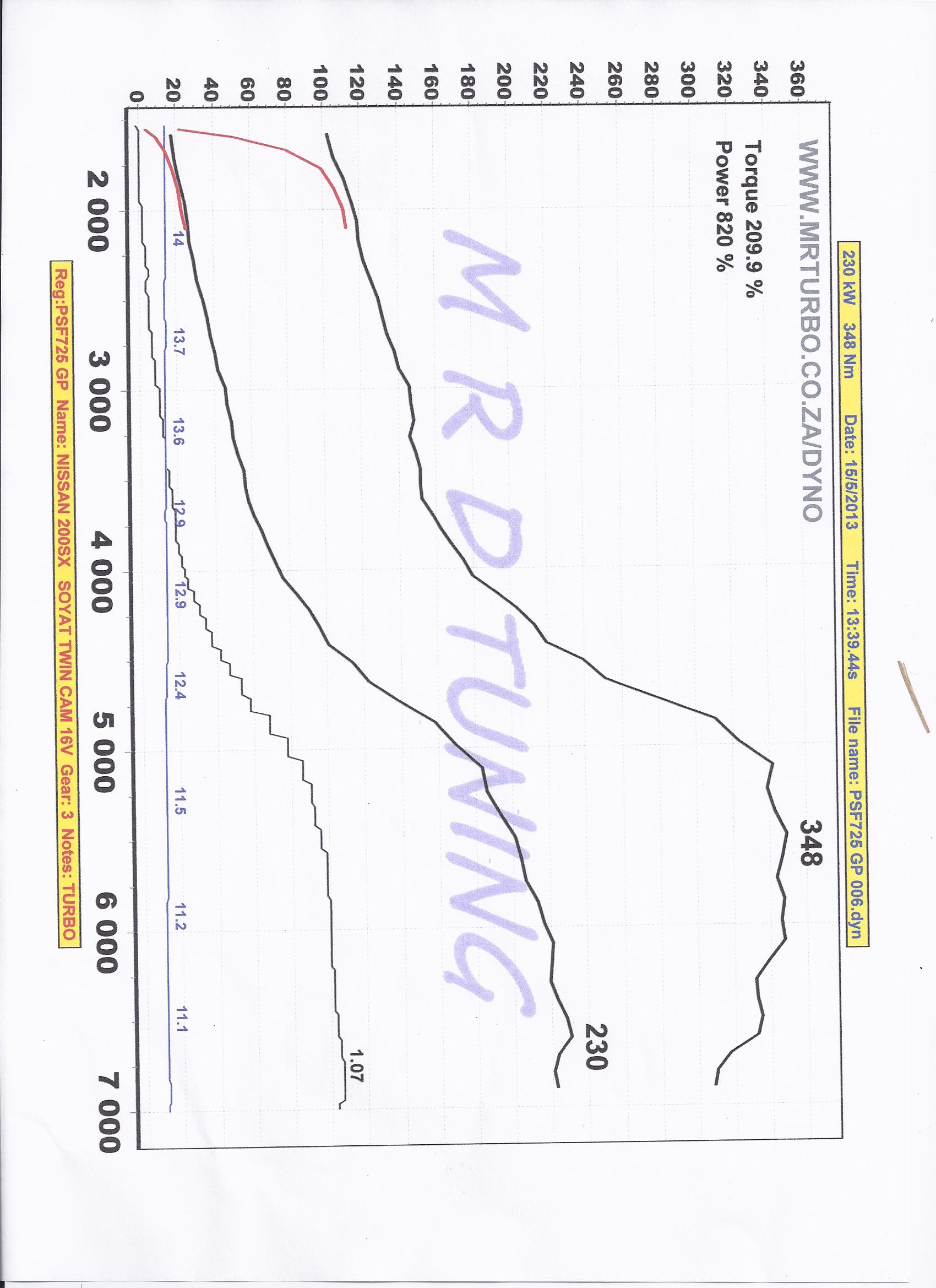

Car at the dyno
Cant post my figures as yet,...Found the 3 pumps has a restriction somewhere and they do not supply the volume of fuel they are supposed to which causes the car to lose power, the Wastegate's spring is also not hard enough causing the car to lose boost and my "Drift" cone filter is causing me to lose 10whp.....Yet the Drift cone filter with the black front cover we tested is more effective.
We ended on 286whp @ 7200rpms at 0.85 bar boost,.. There is allot of untapped Hp to gain. Going to do a couple of changes and dyno it to around 8200rpms with around 1.8 bar pressure.... Should be interesting!
Unfortunately i dont have a sheet, but i took this photo on its base run, with the filter. Without the filter the base run with all these issues are 217whp with barely any boost
PS im getting intake temps as low as 4 deg celcius in dyno room (given it was cold and raining yesterday), my intake temps seem to be below 24 deg.....

Installed motor
Painted the branch
Car at the dyno
