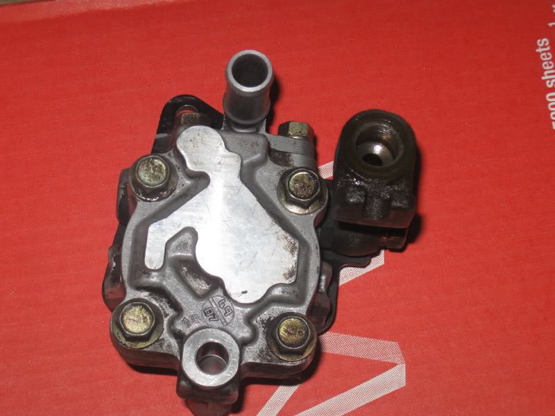

4. Remove the bolt size 14 witch hold the pump onto the bracket.the pump should look like this only with the pulley still on.

6. Remove the 4 bolts at the back of pump to remove the back cover. You may need a engineers vice to do this.
7.Remove the inside center sections there will be a spring at the back of these parts.Remember to take note as the parts come out they need to be reassembled in the reverse order if you not sure consult the service and repair manual.
