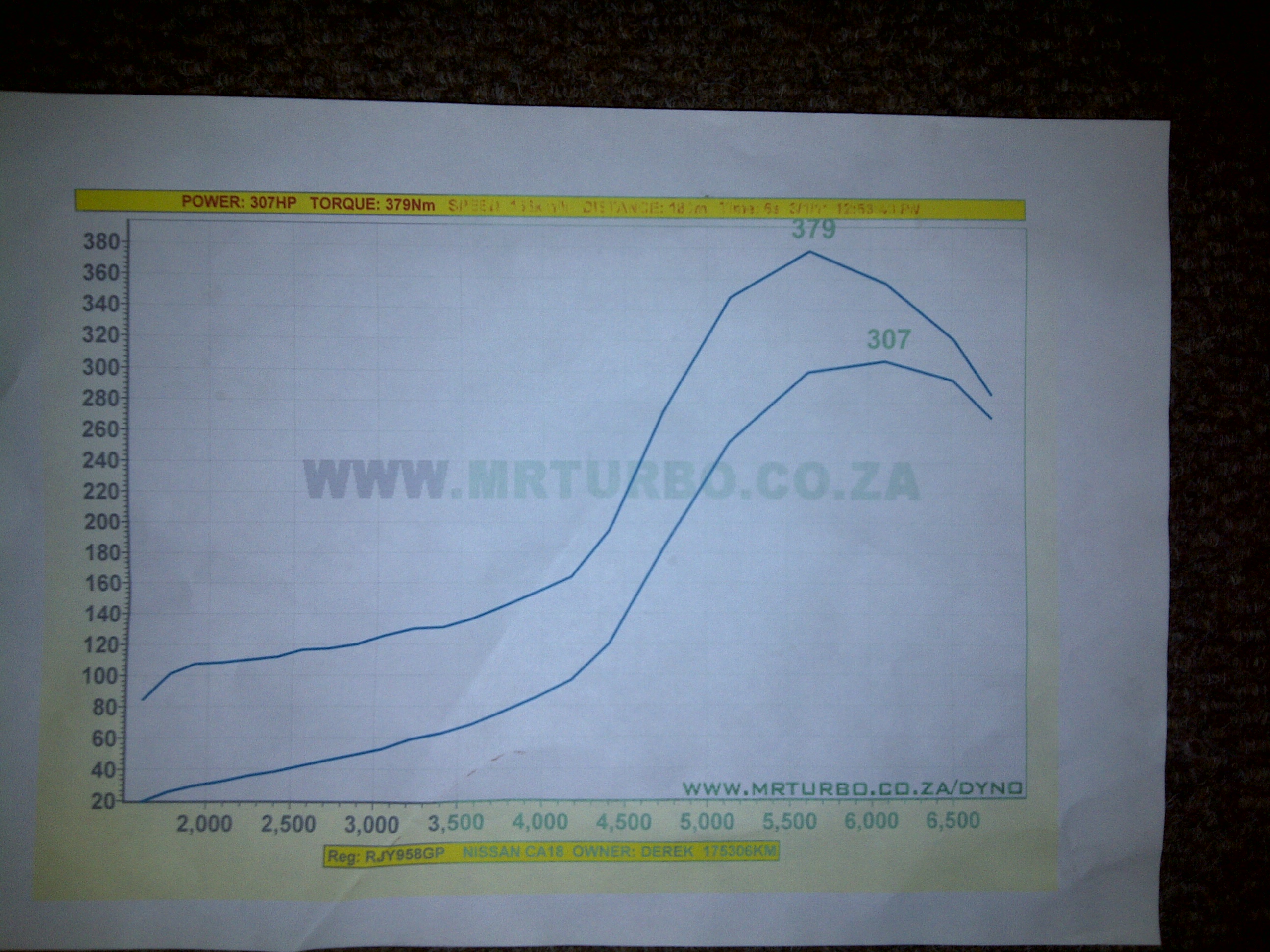

CA18DET
CP Forged pistons
750cc injectors
hi flow fuel pump
FMIC
T3/T4 turbo(small AR60 housing)
1.3 bar boost
95 octane
Date: 01/03/2011
307 WHP

Re: CA18det Dyno figures
management?Draco wrote:CA18DET
CP Forged pistons
750cc injectors
hi flow fuel pump
FMIC
1.3 bar boost
95 octane
Date: 01/03/2011
307 WHP
Wolf 3D, the figures could have been better, these guys did not have a clue wats going on in the wolf(most tuners don't) so I basicly tuned myself with their input and my tuning ability is very limited.SonOfAnarchy ZA wrote:management?Draco wrote:CA18DET

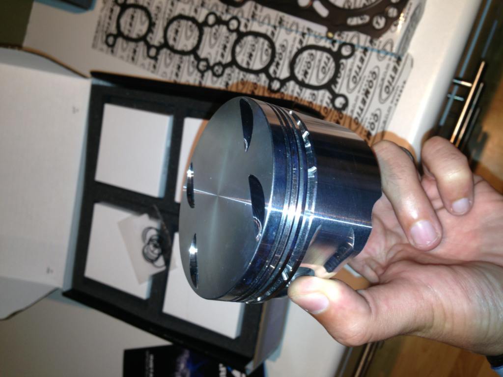

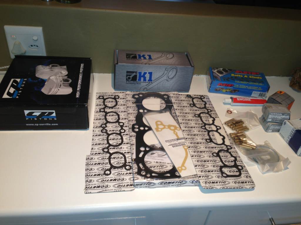

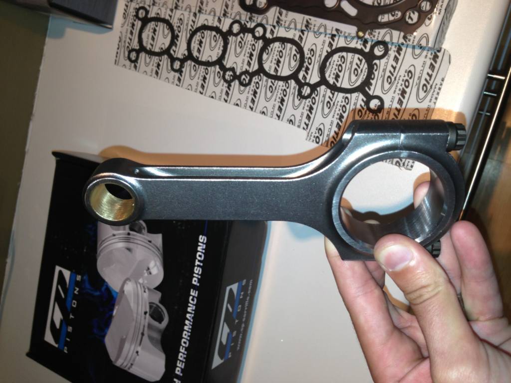

Awesome stuff Gary! And thanks for the posts guys, its really fun to see the CA18 figures shine!
I cant post my figures as yet,...Found the 3 pumps has a restriction somewhere and they do not supply the volume of fuel they are supposed to which causes the car to lose power, the Wastegate's spring is also not hard enough causing the car to lose boost and my "Drift" cone filter is causing me to lose 10whp.....Yet the Drift cone filter with the black front cover we tested is more effective.
We ended on 286whp @ 7200rpms at 0.85 bar boost,.. There is allot of untapped Hp to gain. Going to do a couple of changes and dyno it to around 8200rpms with around 1.8 bar pressure.... Should be interesting!
PS im getting intake temps as low as 4 deg celcius in dyno room (given it was cold and raining yesterday), my intake temps seem to be below 24 deg.....
CA18DET (Forged bottom end)
Stock head (Reconned)
Arp head studs
Cometic head gasket 1.3mm
Cosmetic exh gaskets
800cc injectors
Modified fuel rail
Custom high mount manifold.
38mm Tial wastegate
60mm TB
76mm exhaust (1 box)
Dictator X2 management
FMIC
Custom Garrett t3/t4 turbo with Ar70 comp housing and .63 exh housing
Custom twin plate clutch and flywheel
