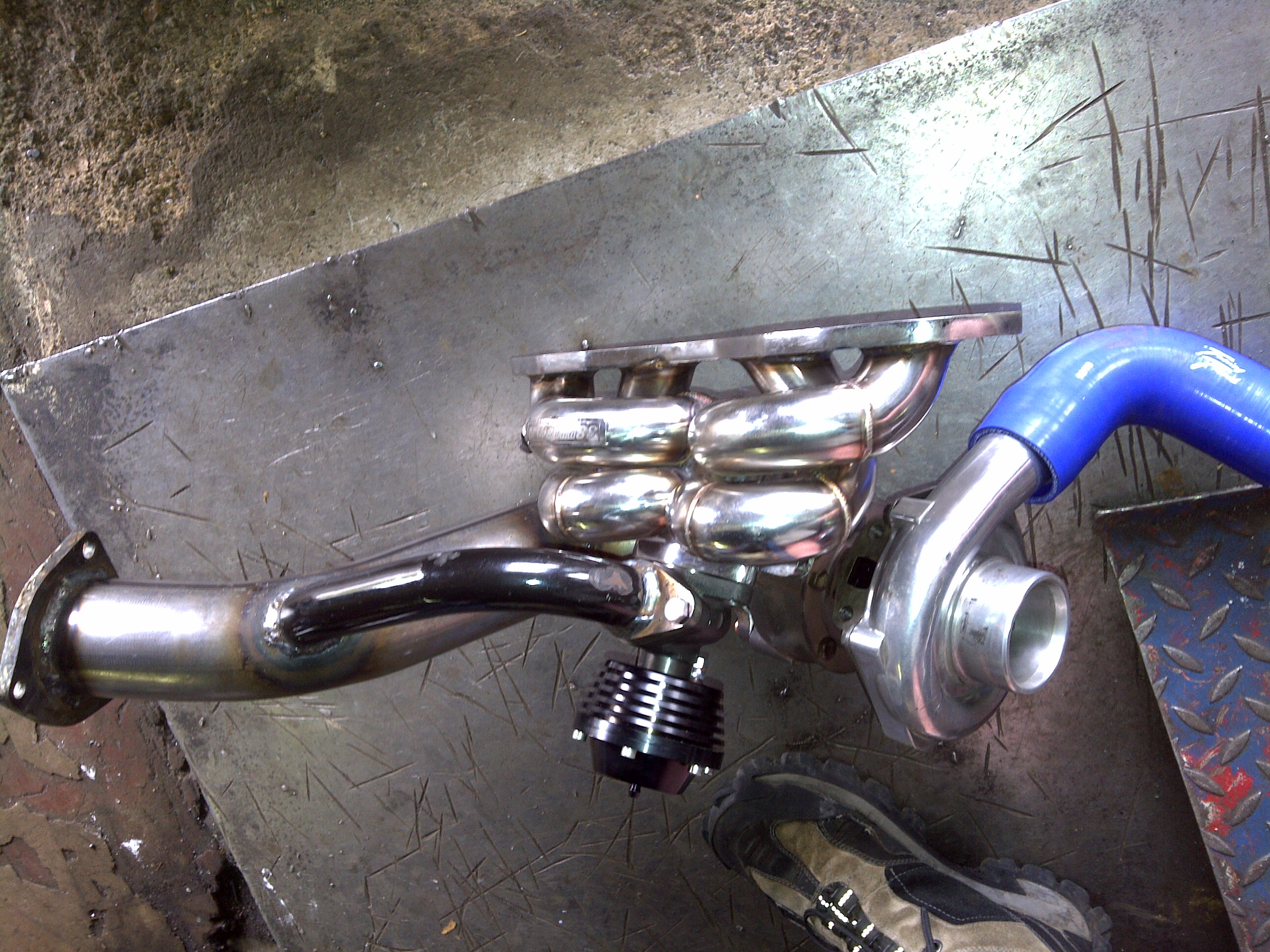

I bought a autobahn 88 ss top mount, but ended up using it to build a jig from which I build myself a steam pipe mani. I sold the ss mani to Draco but looking back I don't think I did him any favours. Unless u buy a moer of a expensive ss mani which is braced and sopported in every way possible you're wasting you money.
My 2c.
Re: exhaust mani
Posts: 5726
Re: exhaust mani
Charlvdw wrote:I bought a autobahn 88 ss top mount, but ended up using it to build a jig from which I build myself a steam pipe mani. I sold the ss mani to Draco but looking back I don't think I did him any favours. Unless u buy a moer of a expensive ss mani which is braced and sopported in every way possible you're wasting you money.
My 2c.
Not blaming Charl, he is right, rather get a custom steam pipe one built, the S/s is just not up to the task and has more issues.

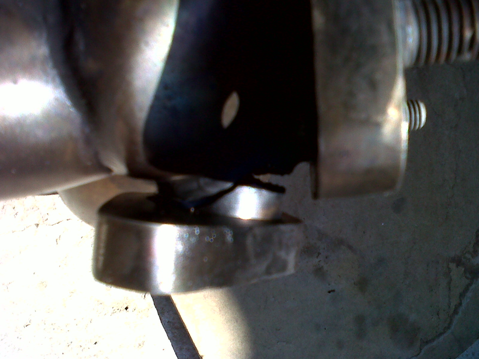

My wastegate flange also broke off during the night, there was an event at the rock about 2 years back, washed the car the evening, pulled it in the garage, next morning when I started it, everything was cocked, mani was leeking bad, when I took it off...this is what I saw...over night..
Look at the space there was for studs and nuts...trust me...it's a bitch..
Make damn sure if you buy, u get one without these problems, think the megan racing one might be slightly better..
