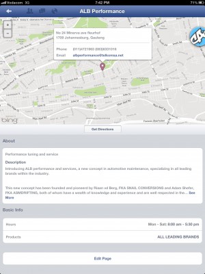

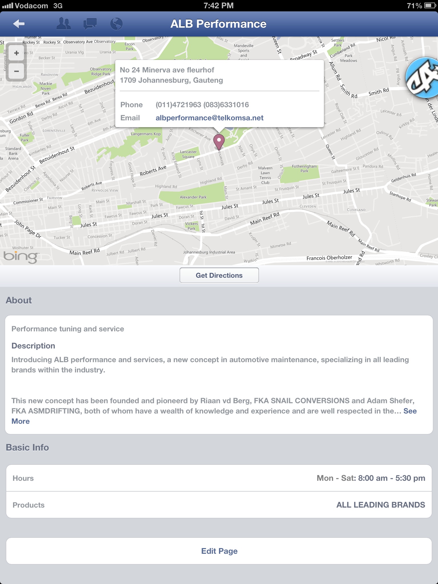

Hi
There is the address, and send me what you think is fair. Ons kom mos al n lang pad uncle. Also one of my clients Marco is going to call you, he needs some work on his Z
