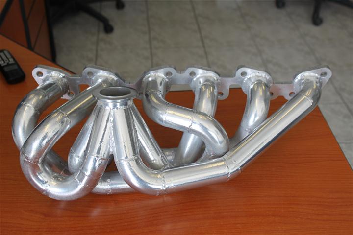

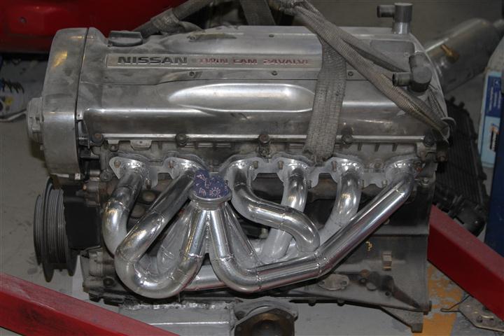

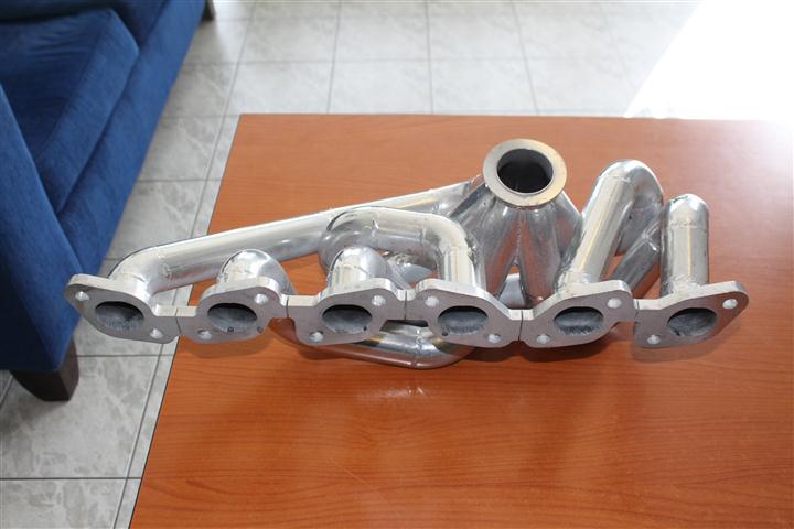

Nice turbo manifold. Who built it? Need one for a GTR. Wil also fit a GT3582R turbo.

Love the collector.Well done.
