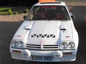

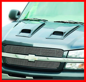

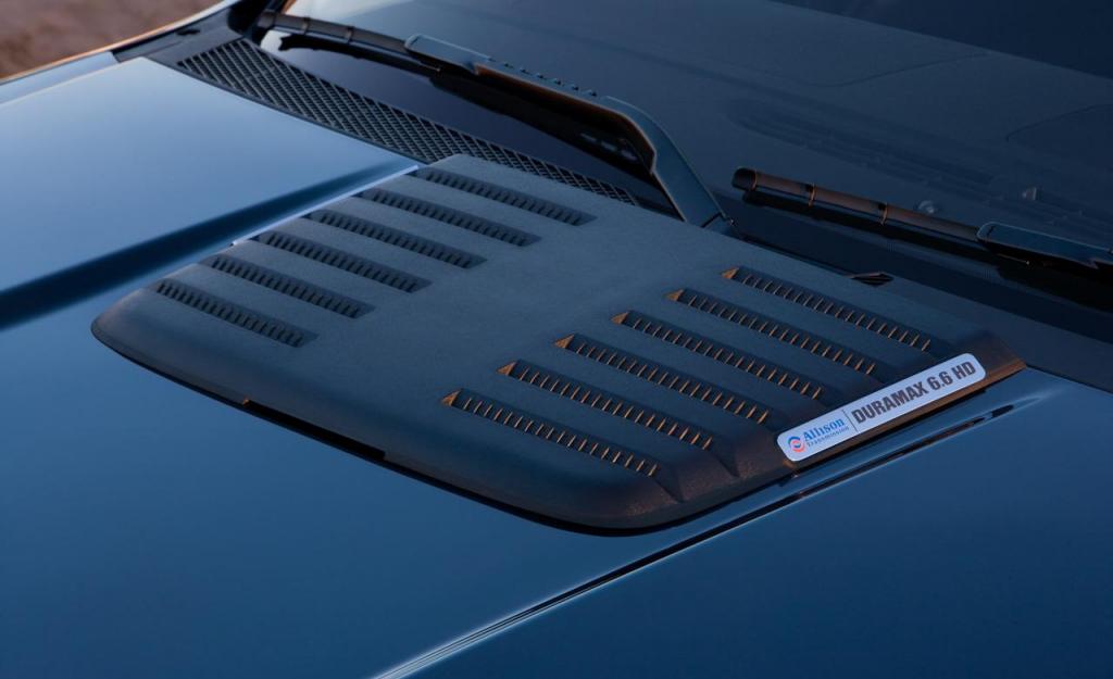

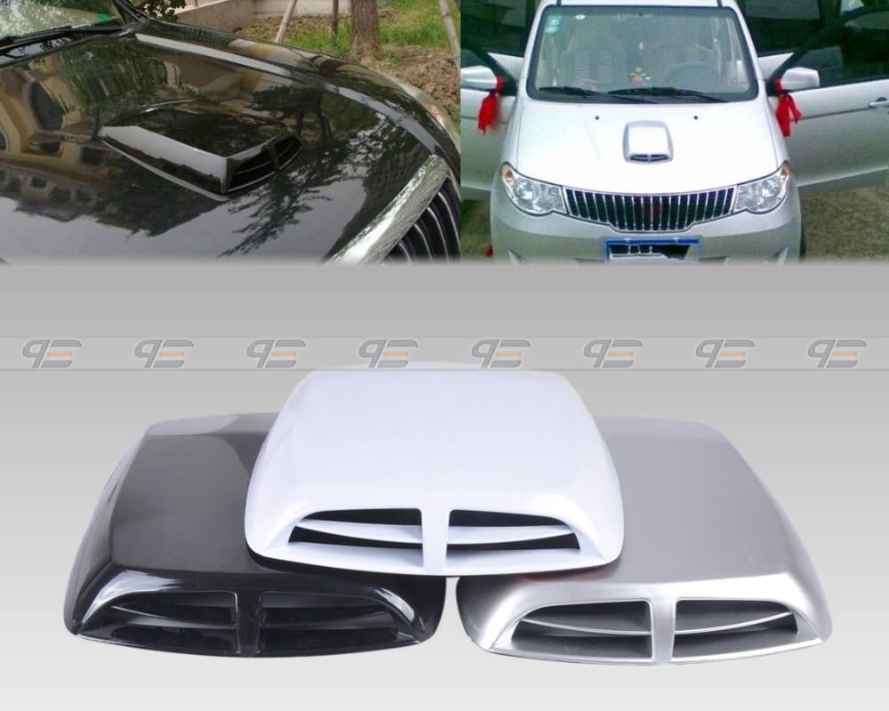

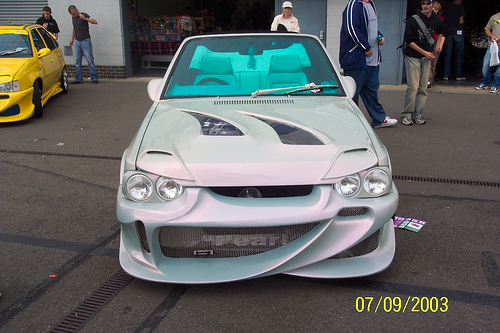

liking the v mount mike! whats your plan for the bonnet to get the air to flow right?
Did someone say VENTS???
