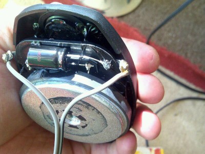

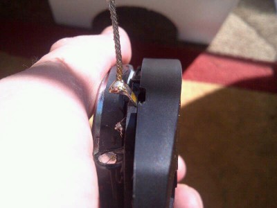

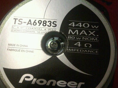

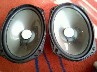

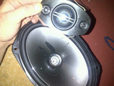

Ok so seeing as I am sitting board at home today, I figured Id start nodding a set of my 6X9's into a split system for the front doors. . Hope the pics will tell the whole story for me coz I don't really feel like typing every instruction out today. . . .
also, tap talk might put it in the wrong order, but so be it. . .
1 set of pioneer 6X9's Neatly cut out the sticker covering the screw holding it together gently remove the sweeter which is hotmelted to the magnet frame inside to be continued. . .

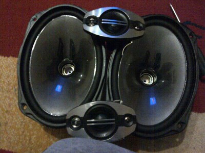

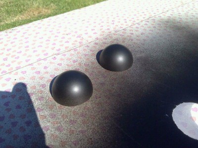

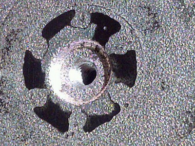

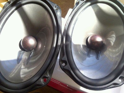

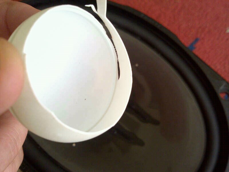

Hopefully the rest will be in correct order this time. . .
Speakers should now look like this now cut 2 pingpong balls in half to use as the center domes almost there spray the balls lightly to what ever color you want Now stick the ping pong halves to cover the voice coils with rapid epoxy resin
.... To be continued
