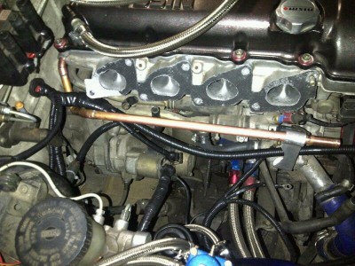

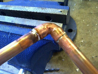

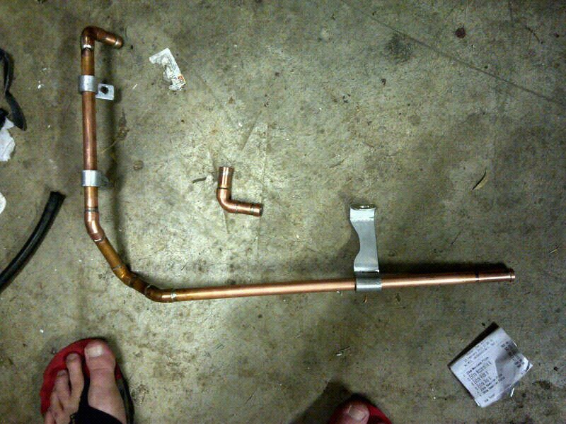

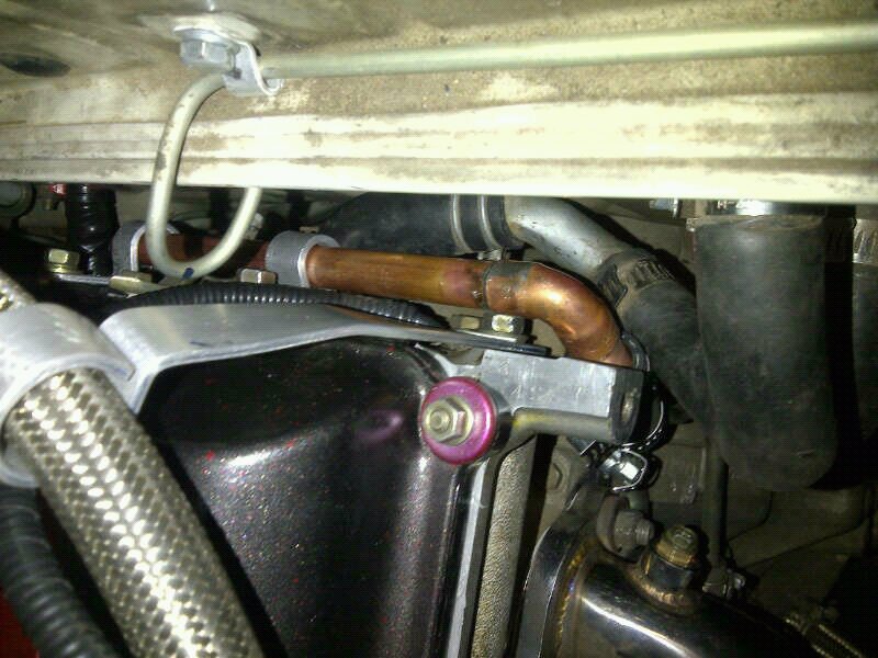

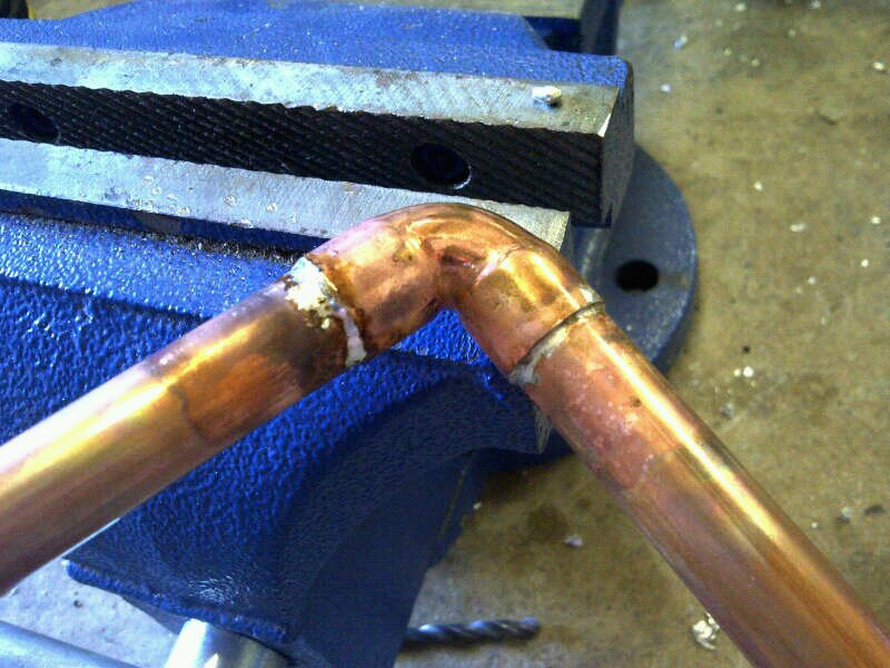

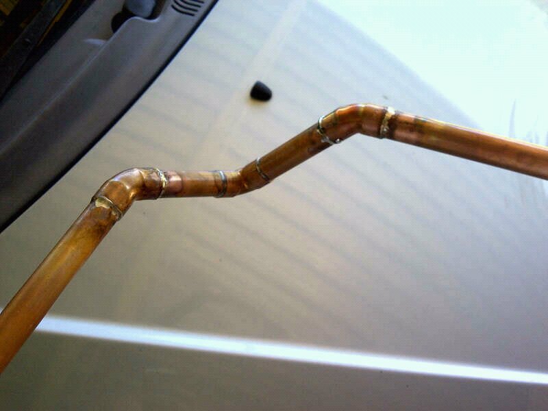

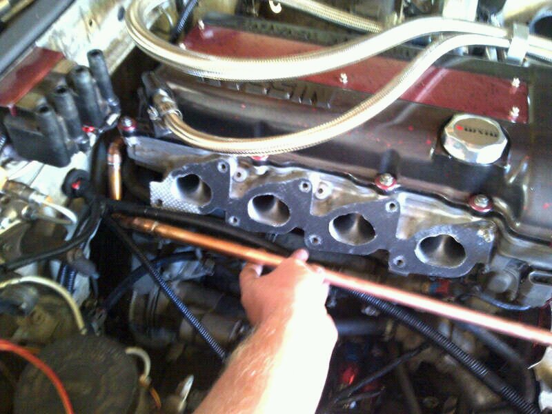

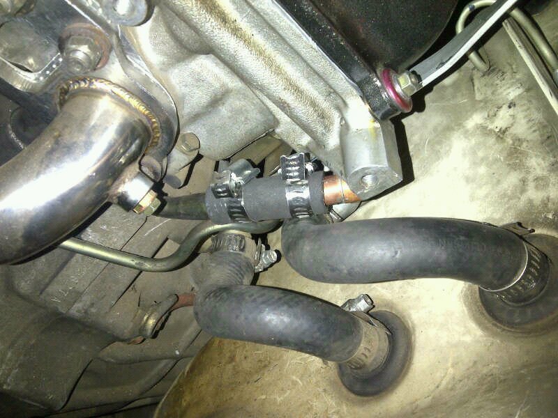

Ok so a slight change I made, the oil return pipe I had made to go round the back of the motor didnt work to well, so I got some copper plumbing piping with a few bends and braised it all up. Now she fitting snug and looking good. . . Decided to rather go with standard rubber pressure hose on the joints to allow for some better flex though as the braided pipe is a little to stiff for this application.

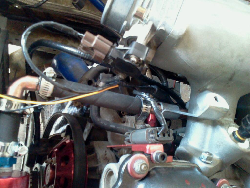

TPS check
Temp Sensors check
Hall Effect pickup check
not much left to go in the engine bay atleast now. . .

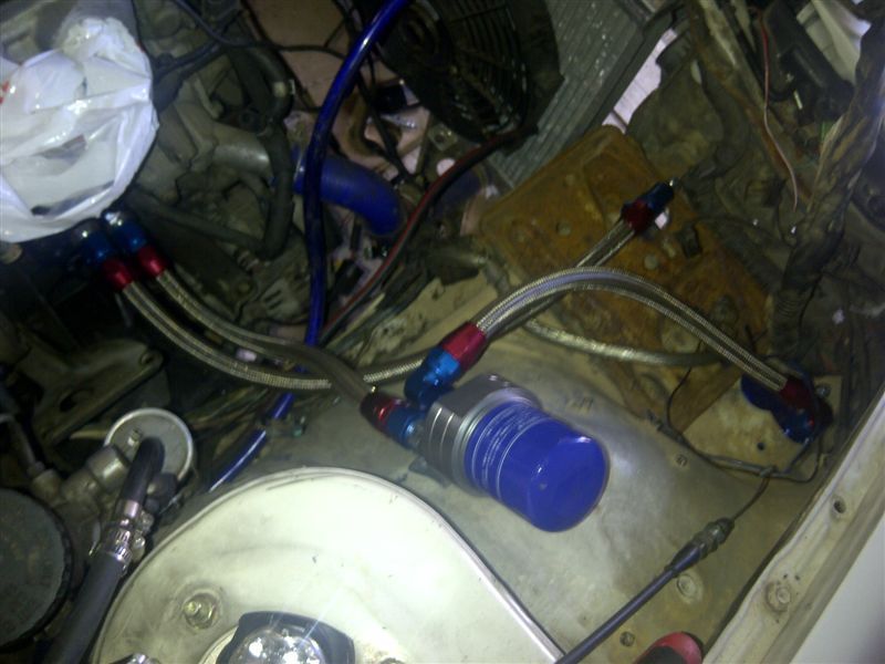

Then I needed a few braided hoses and some hydrolic fittings...... Ye made my own hoses up, wanted the correct lengths and enough to do this
combo Oil Cooler and Oil Filter relocation...
Fitted the relocator and Greddy filter where the fuse box used to be located.... Easy reach was the point...
Connected up the hoses.....
And there it is....
