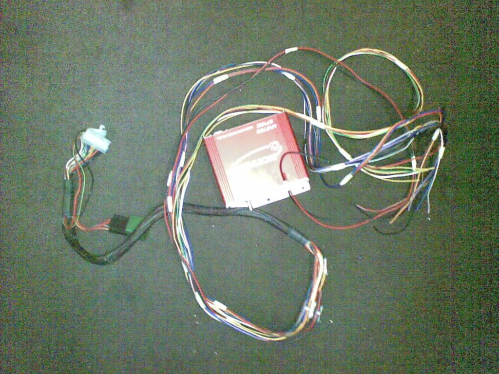

ok so with this dicktator install I want to do a step by step and then make a sticky to show how easy it is and I am making my own individual wiring diagrams just to help that little extra bit
Now there are two ways to wire in dicktator
1) Wire straight into the loom
2) Create a new loom
I went for 2 because to me wire has a 15year lifespan so tapping into the 18year old wire can pose a few problems like (breakages, black death etc)
So I’m making my own looms up for
A) Injectors
B) Cas
C) Coils
D) Idle control
E) Water and air temp sensors
So far I have made up the injectors and idle control harness and part of the CAS harness
Here is a picture of the injector and idle control harness together did it as neat as I can
Those are meant to be 550cc injectors but has 660cc engraved on them so will have them tested and cleaned
I’m busy looking for netting to go over it all to hide everything
If there are any questions please ask and see if I can help out
