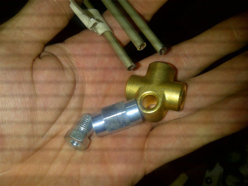

I was getting irritated with my break lines looking so sh!+ after removing the ABS pump....
So I went a picked up a few new pipes and fittings....
And tested out my new bender and flairing tool....
Then mounted my line locker and started with the new break lines...

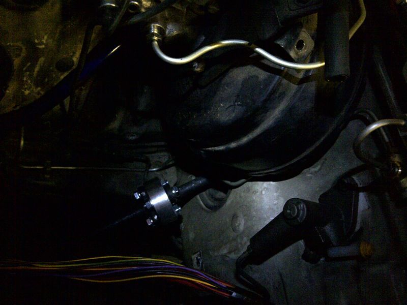

You will notice lots of bends where you may wonder what they are for and why... Well lets just say it's to ensure the greddy intake will fit
withought rubbing with the motor torque...
Well All done now and looking good... Taking up much less space while looking neat...
