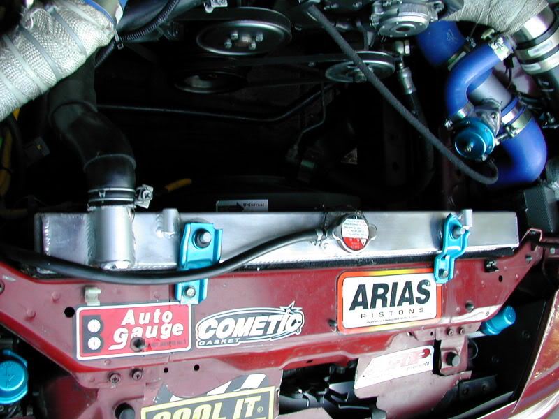

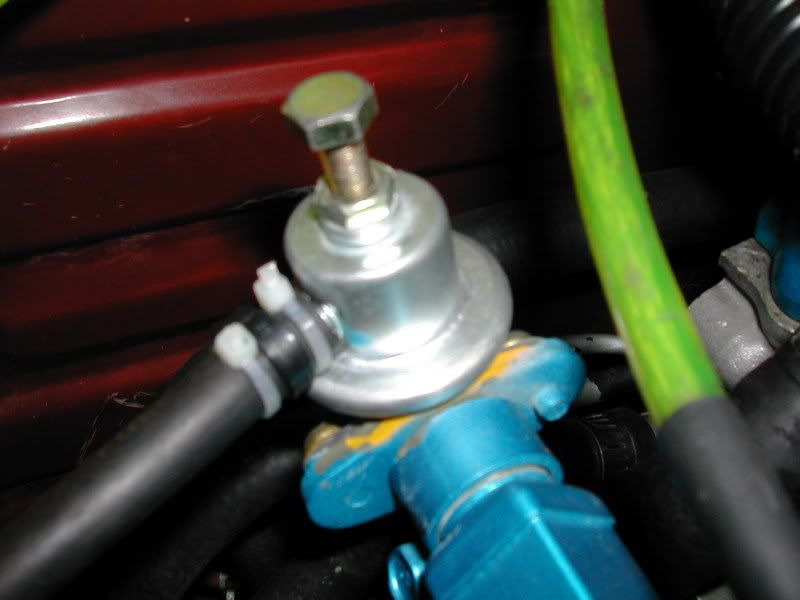

Nismo FPR

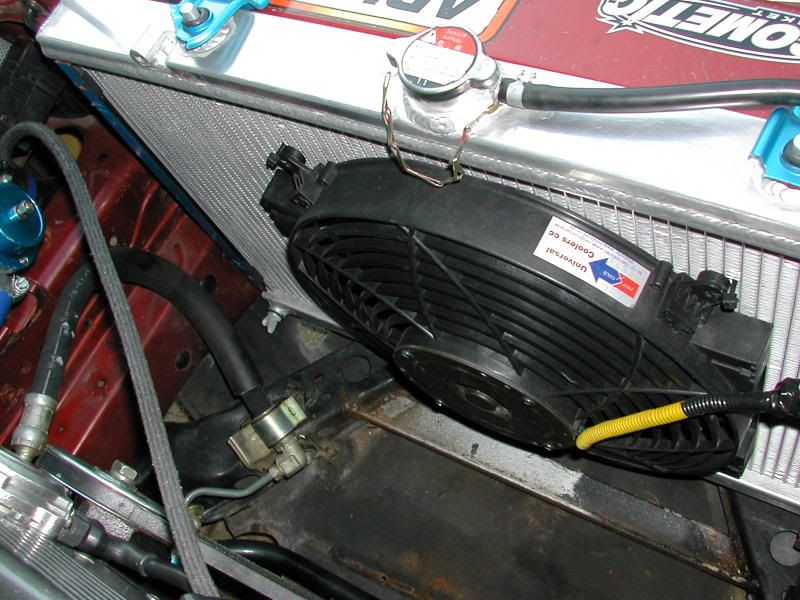

Upgraded Radiator

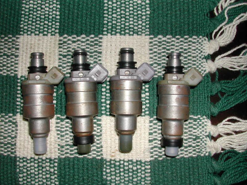

550cc Injectors

I did a Comp test on the motor when doing the service last week all Cylinders came to 800Kpa with only a 10Kpa variance between cylinders.
I have installed the injectors and I tuned the car today the car now holds a stable 1 bar with 80% duty cycle on the 550c's its a base tune so i still need to work out the issues of cruise AFR's and lean down a few 10.3 AFR zones in the map when going through the RPM range
I have crunched the numbers and the car is around 190 Wkw's now based on fuel usage, I was suprised to pick up a snake at the 5000Rpm in 2nd carrying over to 3rd left a brown strip in my pants to be honest
