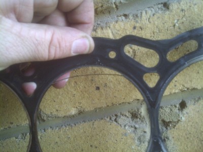

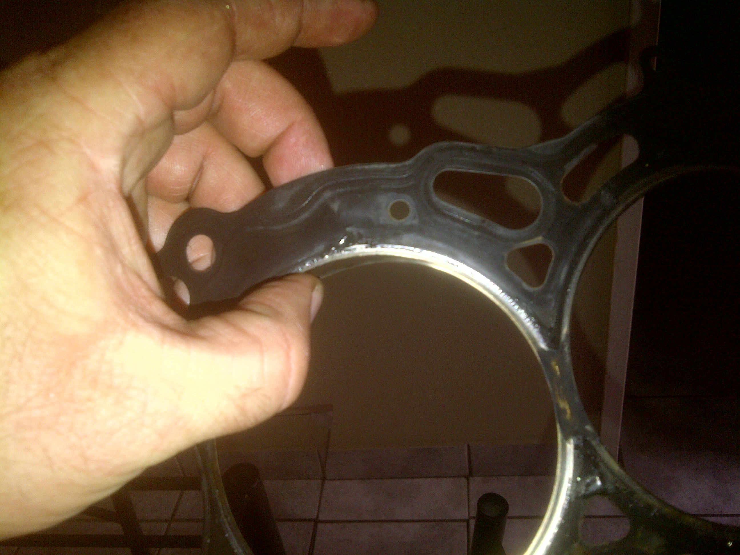

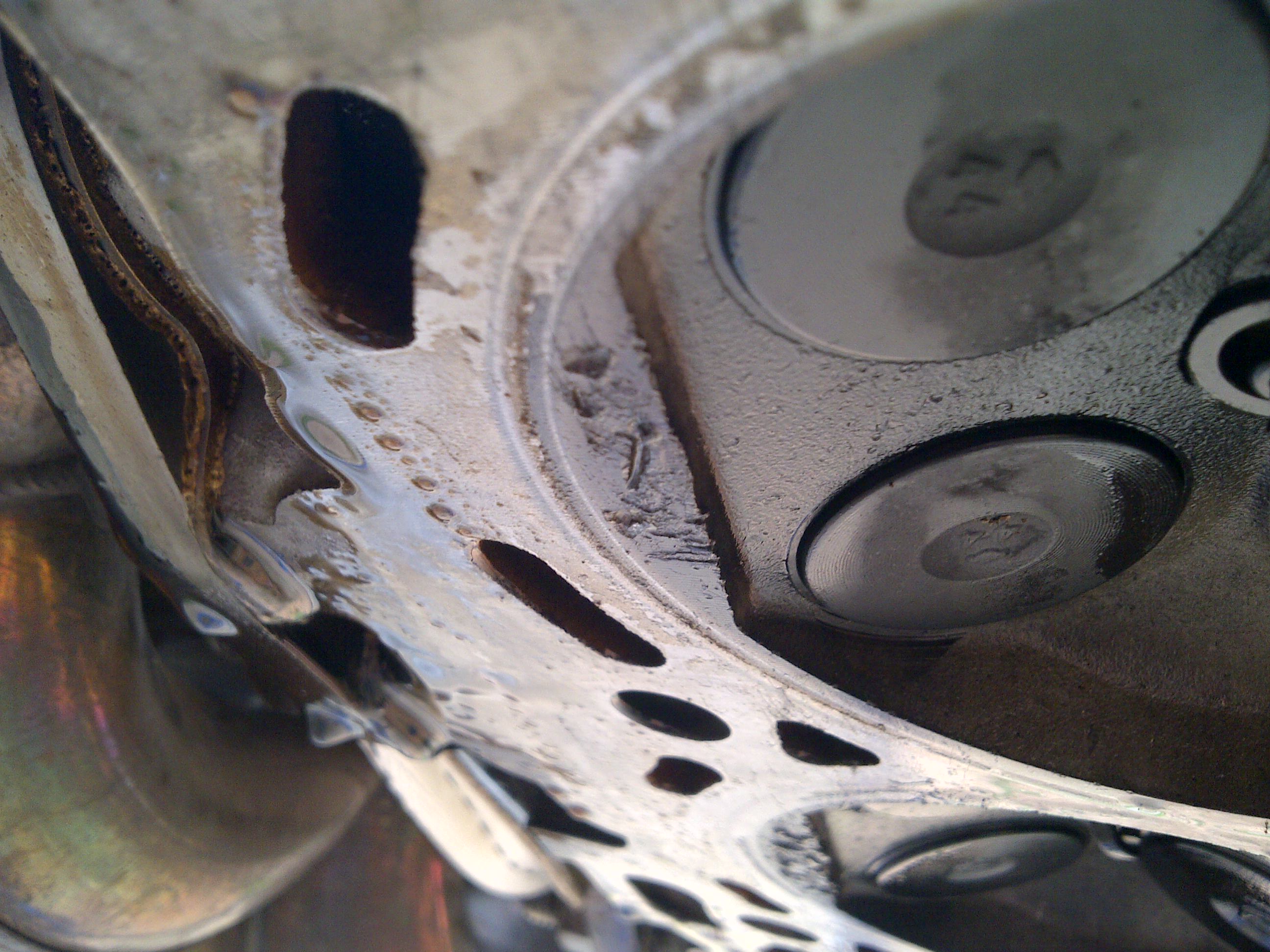

Last weekend I went to Darryl to fetch some stuff I baught(thanks buddy) on the way there, about a km away from him the car went down on 2 cylinders, stopped and had a look and all seemed ok so I assumed it was plugs, got to Darryl and removed the plugs, nr 3 and 4 was wet and dark, thought it was fuel at that stage and also found that the ground starp is touching the spark point, opened the gaps but could not gap it proparly as neither him or I had a feuler guage at that moment,installed it and walla she was running again.
On the way home had some issues here and there as if I'm loosing spark but got home, removed the polugs and 3 and 4 was dark and wet, gapped the plugs 0.2 more than I usally do and put them in and leaned out my idling values, the spak gap made a huge diffs, it was now idling at 13-15 afr.
I thought it was because of the heavy fuelling at the bottom that fowled the plugs, this weekend I took her for a drive on the highway to do some data logging to tune and set boost right, I saw a huge difference in afr, it was way leaner on top that it was before, I assume that is because of the spark gap.
So took it slow to the next offramp and stopped under the bridge to increase feuling on top, pullled away and there was a hell of a diffs, got onto the highway and gave it soem stick and suddenly I lost spark again and then the white smoke came, she was running good but white smoke everywhere, parked at the R21 garage and opened the hood, checked whether everything looked ok, took off oil cap to see whether oil and water was mixing and did not see signes of that.

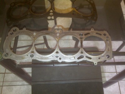

Drove her home casually, got home, let her idle for a bit and then switched off to start checking, first was the turbo, felt the play on the compressor and it felt ok, then did compression and it was the same as last time, all 4 was low(as usual) but all the same, just 4 that was a bit lower but not heavely so, the plugs, 3 and 4 was wet and this time it made sense, it was fowled by oil, I assume the HG is not stopping oil into the chambers....this is why I believe.... Saw this, so I ordered a copper gasget from a company, after struggling to get him the info on the gasket he said it will be done in a day or 2, waited a week and did not hear from him so I decided to do this....
Because the 2 outer layers of the cometic HG was damaged and the copper gasget was unresponsive, I decided to separate the 2 thinner layers of the gasget and use only the 1mm S/S middle part... it worked till now...I believe it's sealeing everything except the oil that is getting into nr 3 and 4 chamber, seems I have to go and get the copper one...

Hi Draco
What gasket is that and was it new or did you re use it?
SONY Xplod inside
SR20DET Powered Red RS13
It was a cometic HG that I reused the middle one only.
- Posts: 1717
- Joined: Tue Aug 01, 2006 4:00 pm
- Location: Will always be called Pretoria
I mean originally before you did this?Draco wrote:It was a cometic HG that I reused the middle one only.
SONY Xplod inside
It had the cometic HG since Vlades days...he put this one on with his last build...
- Posts: 1717
Ok so you reused it when you took of the head?
SONY Xplod inside

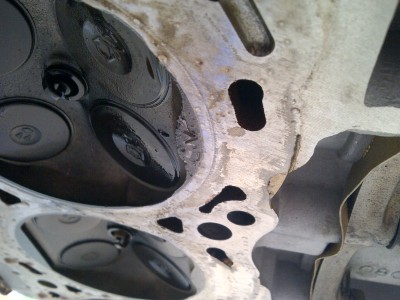

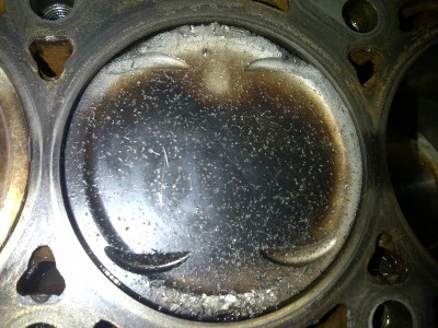

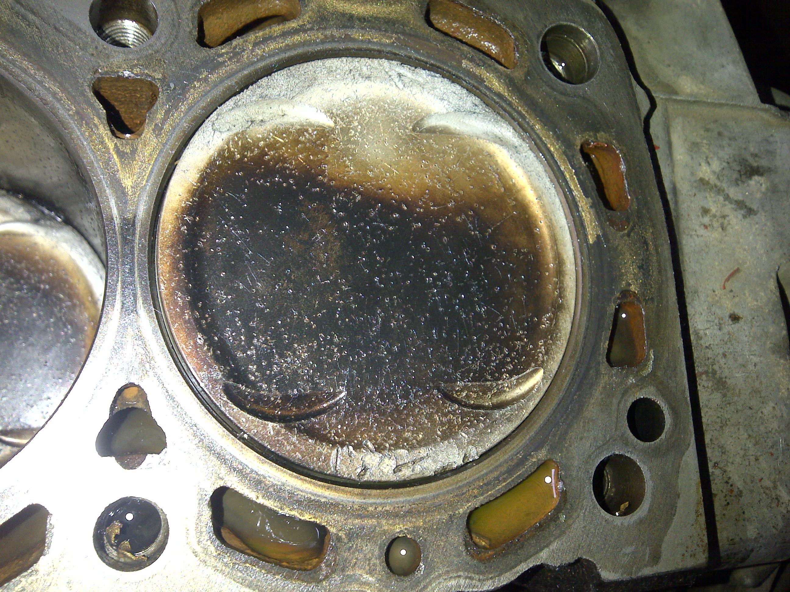

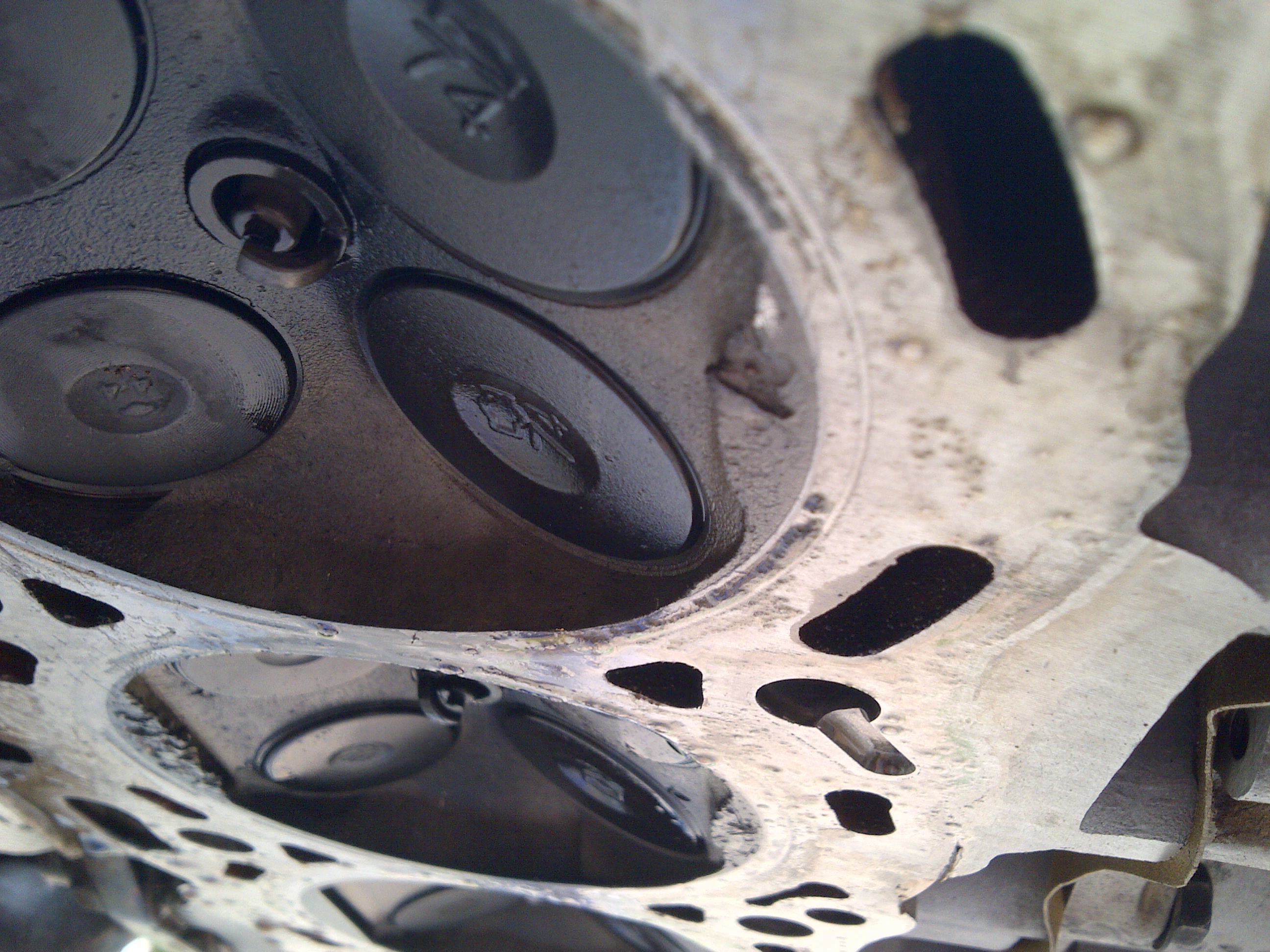

The head was not off since Vlades rebuild, when I took it off because of the valve damage I saw the damage on the gasget and used only the middle part...
She's dead again till money is availible, seems there was a clearance issue or a misterios object got into cylinder 3 and 4, did some real damage to pistons and head also took a knock, ol murphy has moved into my house it seems...it never rains it pours..
