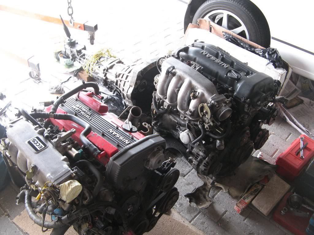

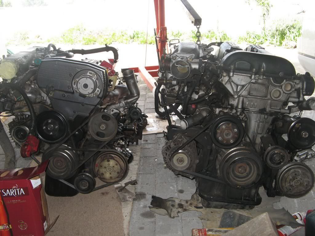

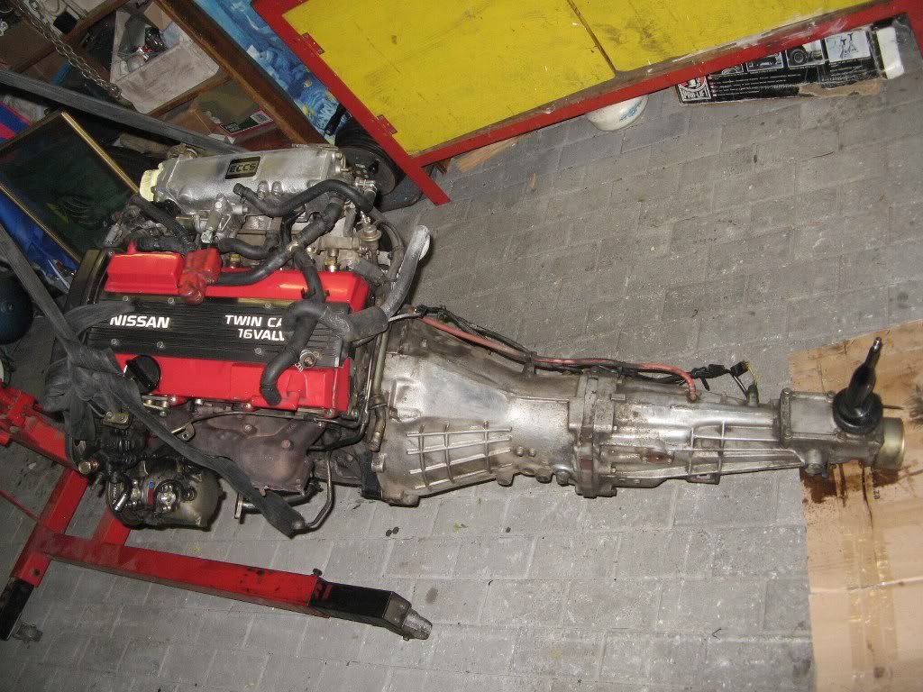

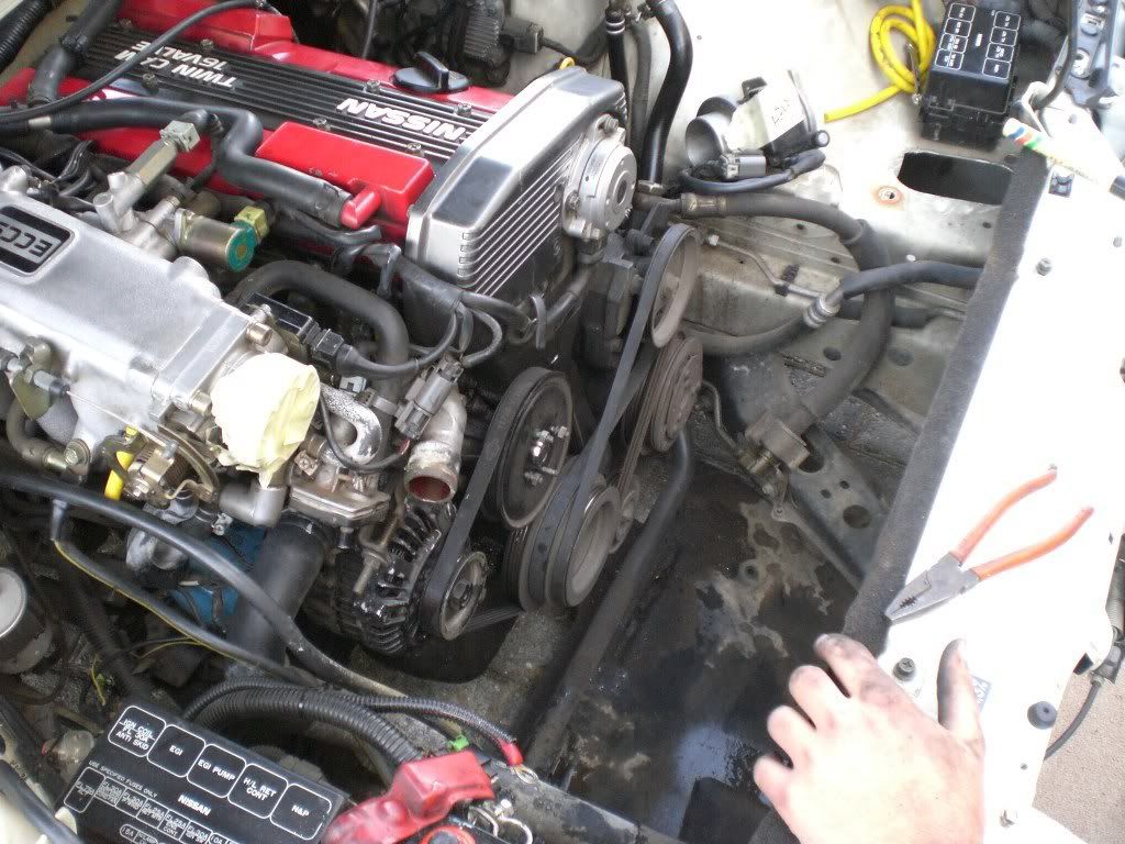

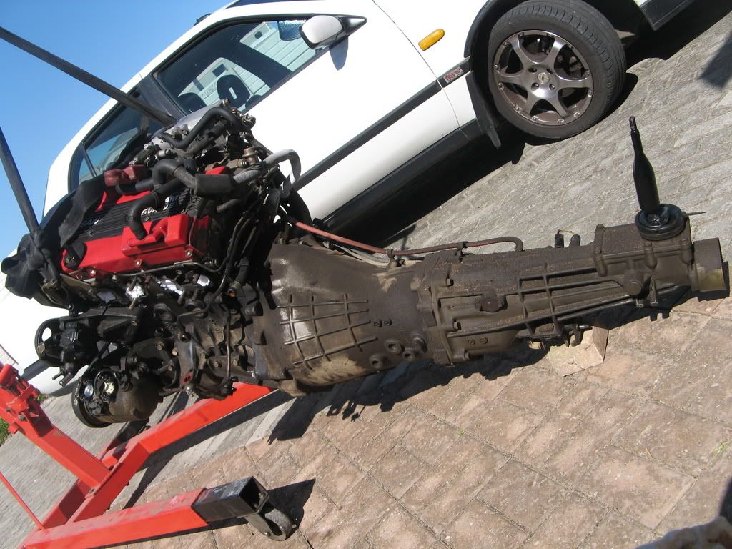

Some more piccies....

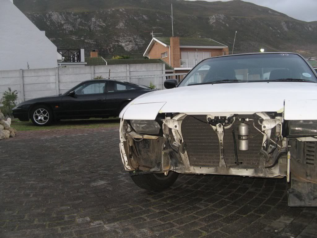

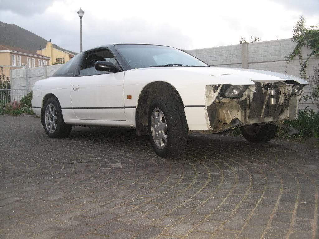

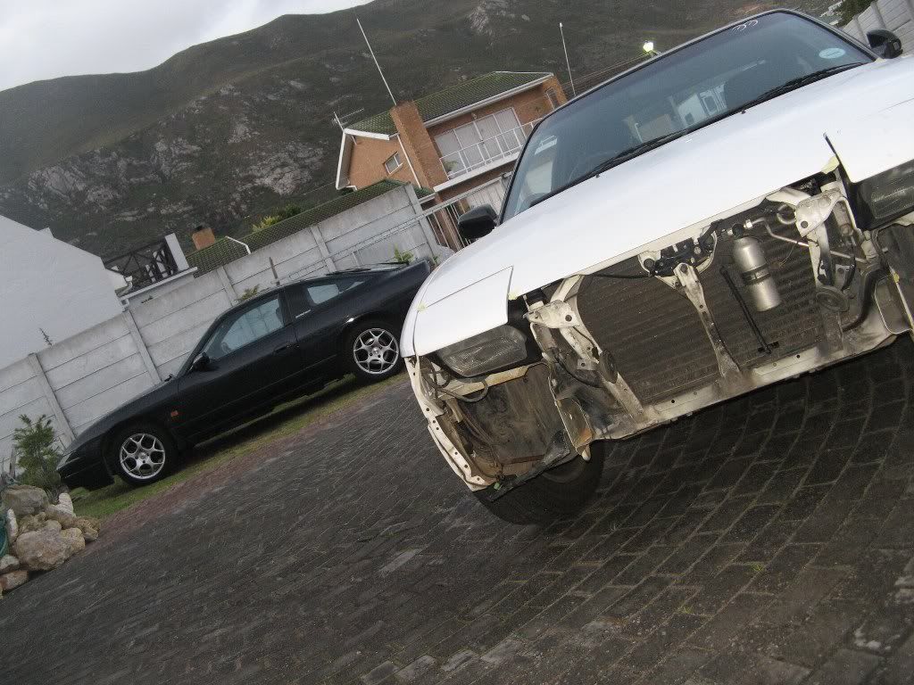

oh... uhm.... yeah... thought id make my car a 4X4 by doing a bit of weight reduction in the front....
Mission Completed! 4X4 achievement unlocked!
:shock: :shock: :shock:

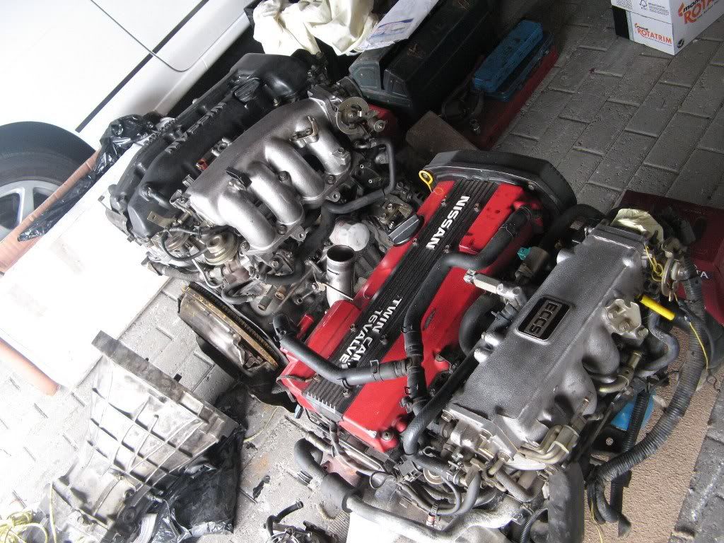

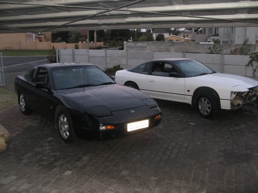

My new (unpayed) baby.
There you go... thus my progress so far....

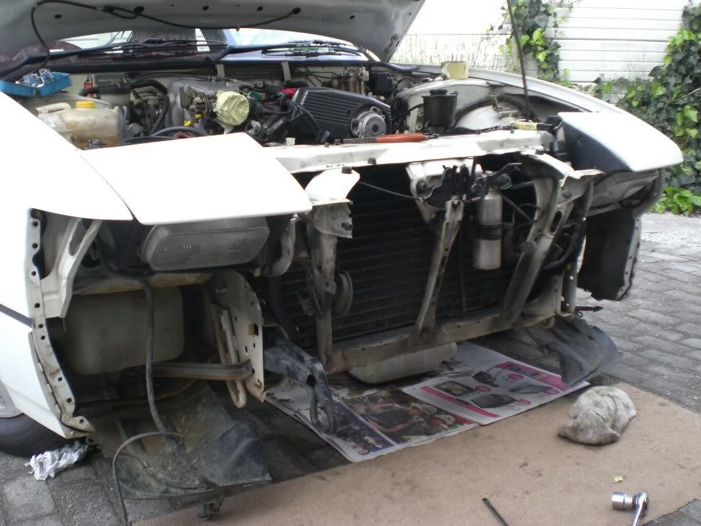

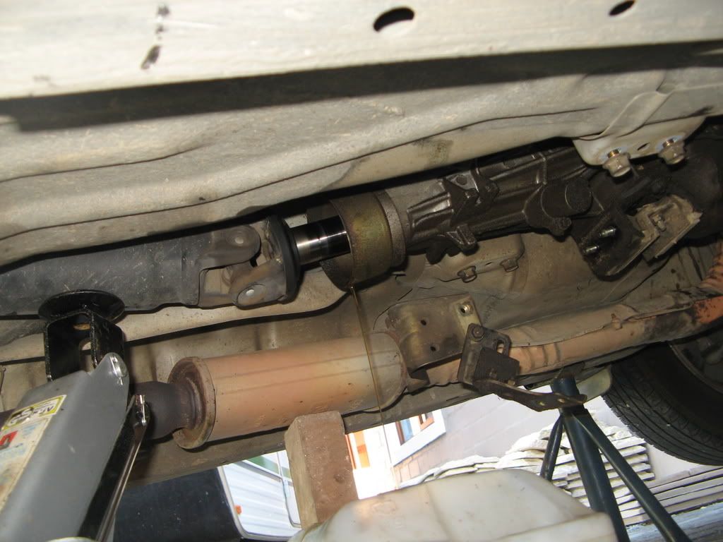

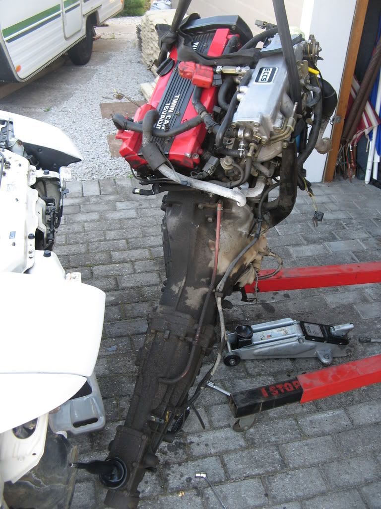

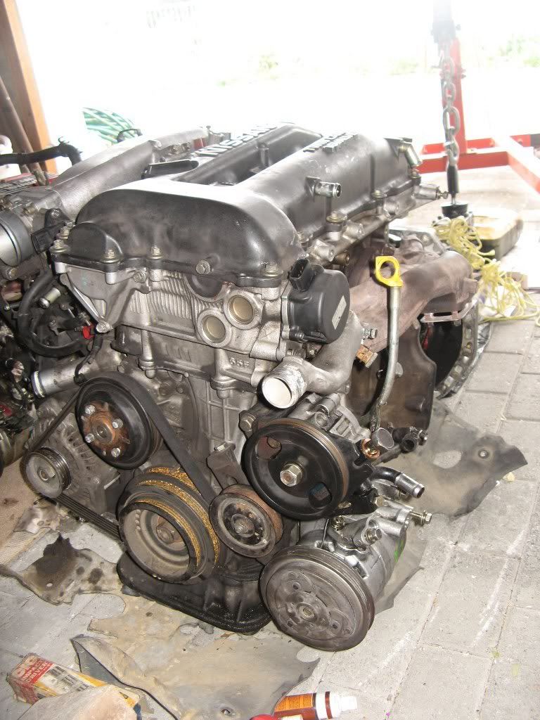

You guys did it the quick way, we normally have the shifter out and the prop disconnected, takes a bit longer, but alot less manoevering.
Riekert wrote:Image

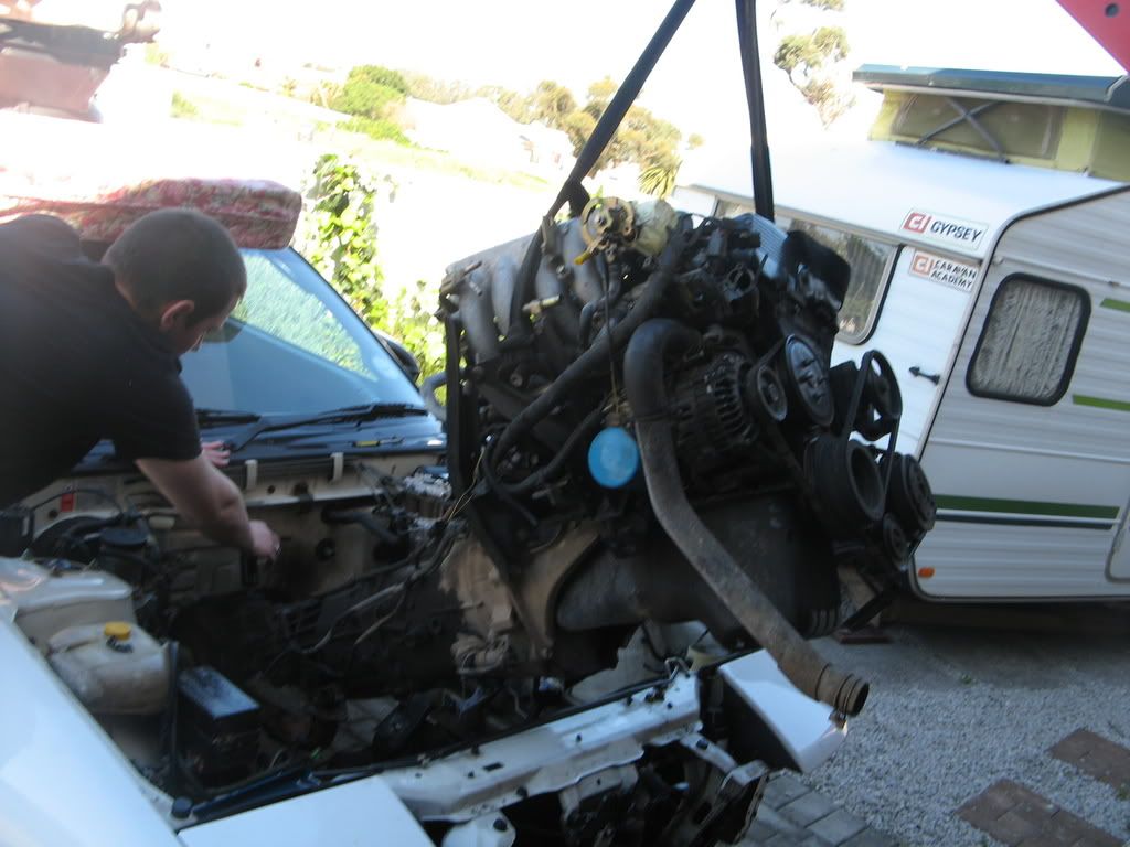

No man, you look like you're scared of the motor you need to have that "proud game fisherman" look on your face!
Captain Slow to the rescue!

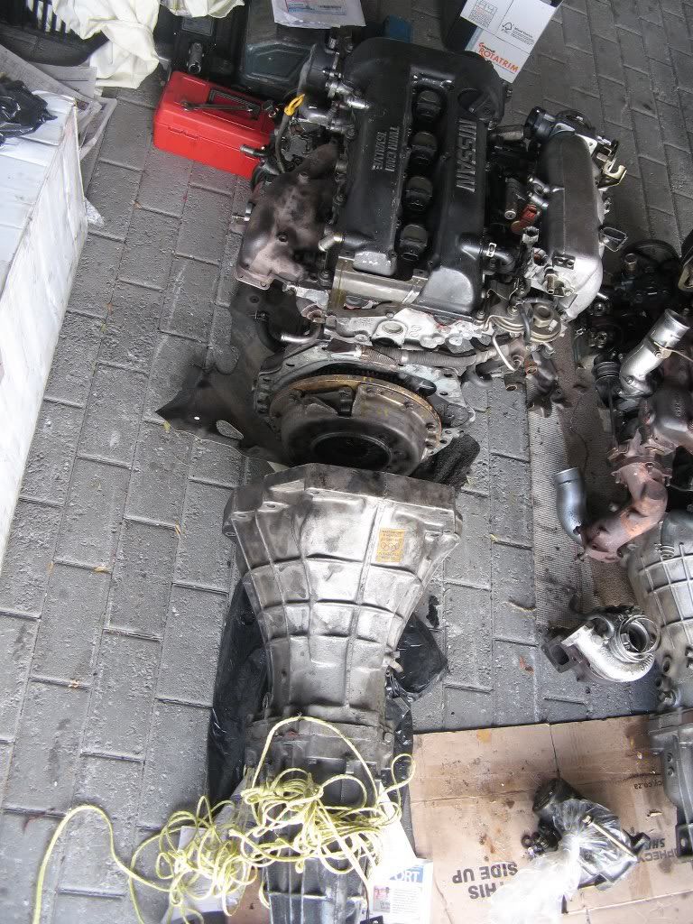

hehe yeah. Well not bad for the first motor removing mission me thinks.
hehe yeah was just so relieved the damn motor was out!

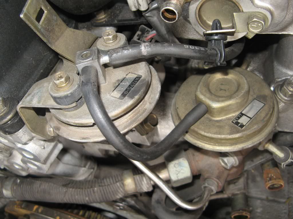

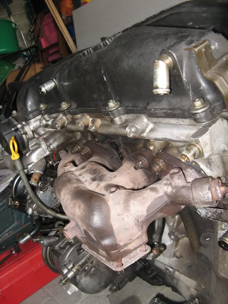

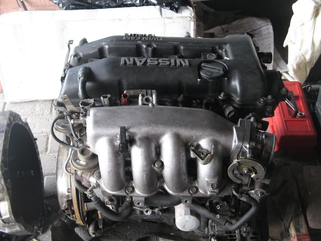

EGR FTL!!! Rip that shit out and block it off with a bolt!

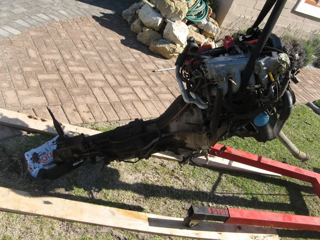

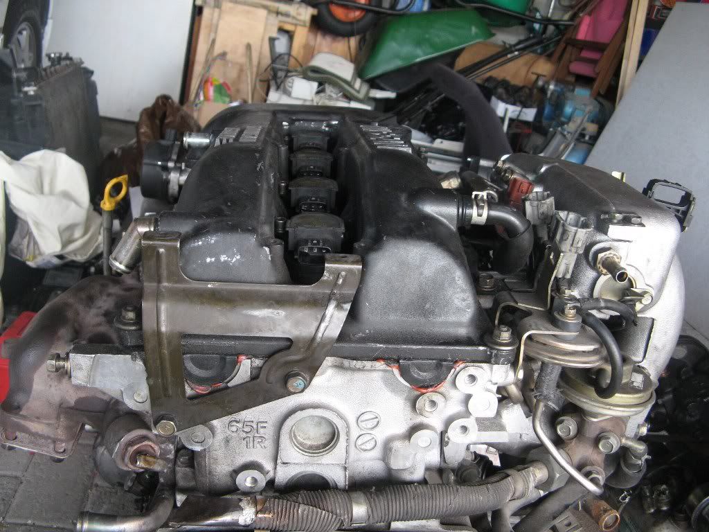

Sokar wrote:EGR FTL!!! Rip that shit out and block it off with a bolt!
uhm.. ok I know what it is but... where the hell is it?
Ohhh also forgot to say... I check on the net and the stock actuator on the GT28RS is set to boost a minimum of 0.8bar and max of 1.2. so I'm in the clear! I can run that one!
Sokar
1.0 Bar Boost
Posts: 1055
Joined: Wed Nov 08, 2006 9:30 am
Post by Sokar »

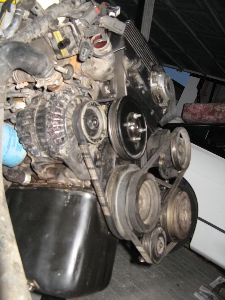

Riekert wrote:Image
EGR are those 2 do-hickeys there, you remove off the head, block the hole in the exhuast manifold with a bolt and get a small blank off plate made for the head. Mine was leaking and I made about 20kw more on the dyno when I finally took it off... It also doesnt interface with the ECU at all so the car will run fine without it.
oh I see... nice! I'll do that yes. Thanx sokar!
