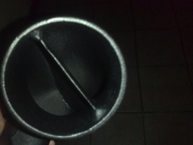

twin turbo pipe, droped at Piet's Fab lab to cut and weld in seperator plate to avoid "turbo shuffle"

got back some more clean / powdercoated parts
got the modded twin pipe back
twin pipe recoated and front view

Fast work there :wink: Not wasting time. Like the mod on the turbo pipe.

RB25SX wrote:Fast work there :wink: Not wasting time. Like the mod on the turbo pipe.
thanks, did you see the smoke flow test vids for this mod?
1st test no mod - orange smoke into front pipe and grey smoke into rear
http://www.youtube.com/watch?v=l8GUhVdko84
2nd vid with mod - same smoke colors
http://www.youtube.com/watch?v=xRX2NhlX ... re=related
