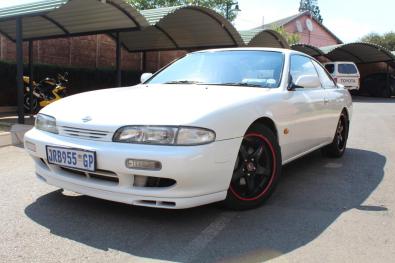

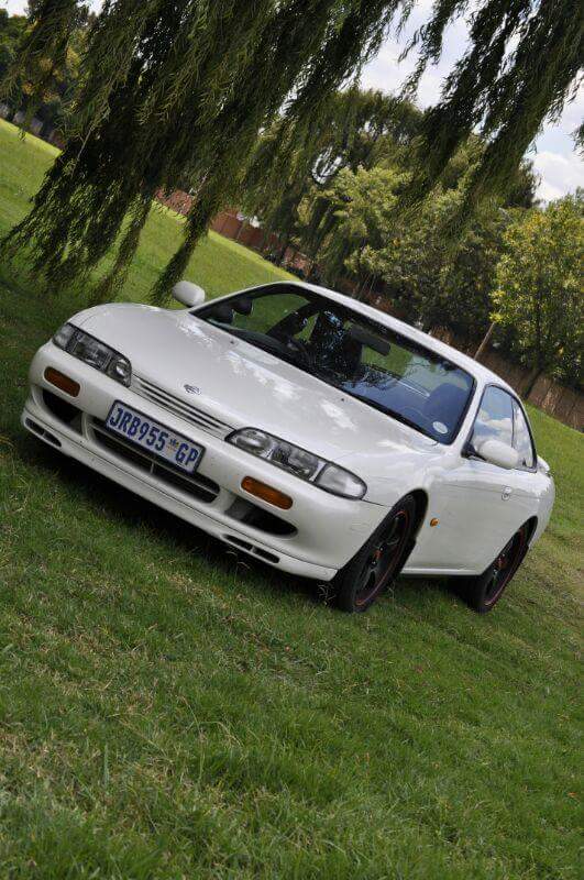

S14 200sx

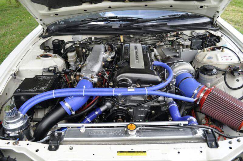

Sent from my D2303 using Tapatalk

Good looking car, and use to be fairly strong as well, so I've heard.

not anymore :facepalm: that car was driven like it was designed to be driven and it lasted like a champ sorry to hear it broke so soon after u bought it. you sure the water meth didnt fail?

I ran low boost so the water meth only came on at high boost. Yes she made almoust 240kw at 1.1 bar. Just trying to sort her out now. The head is coming of tonight to see whats going on. The strange thing is after the whole insident when i struggled home and you let of gas their was no engine noise or any abnomal sounding thing and it sounded as if she ran on all 4 but once your on the gas you can hear that their is 1 cylinder is missing. No smoke nothing exept the visial damages on the spark plug and no compression.
