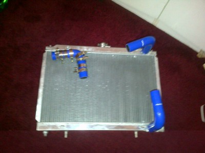

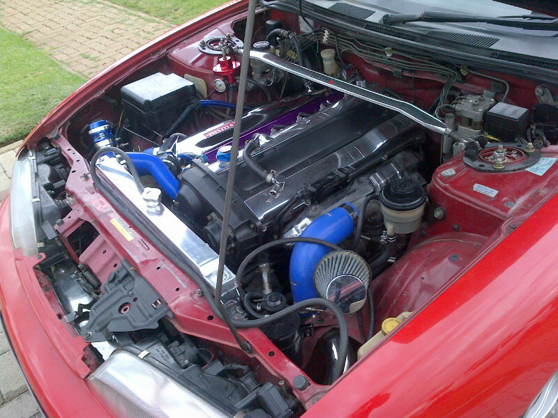

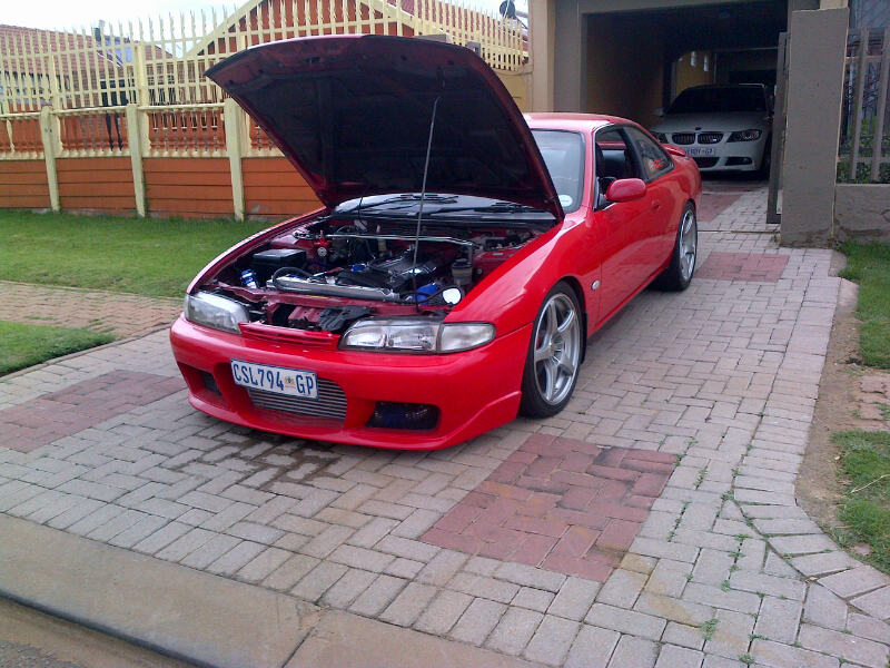

So i haven't updated my post in a while.
Finally got my new radiator cant wait to get it fitted..been busy changing the look of my gxi as well..anyone know the best way to fit the radiator and get some nice clearance away from the motor ??i was thinking along the lines of slanting it back abit??

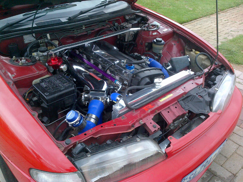

Hey dude, if you going to slant it you will need to be careful of air lock man... I'm currently modifying my radiator specially to be able to slant it... Also the lower return hits the chassis at the bottom when is slanted, unless you want to pay the price of the radiator to get it modified, I would not suggest slanting it... Maybe cut into the front valance slightly to get some few Cm... About 30 to 40 mm is possible gain that way...

Cutting the valance??
How would one go about doing that??
Ive got the R33 radator and its around 4-5 cm higher than the SR20 one...All im worried about is that i might end up with a radiator that wont fit....

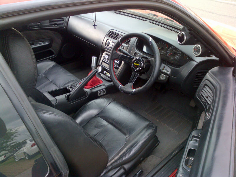

New update
Radiator fitted
Silicone water pipes created and clamped down
Momo steering wheel fitted
