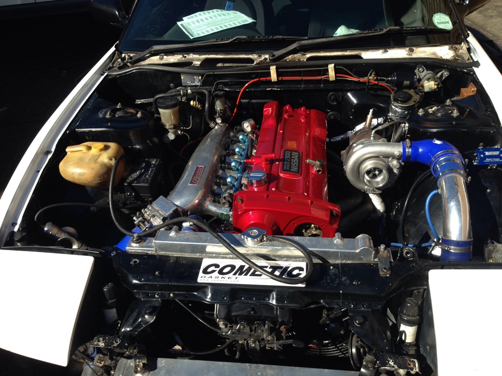

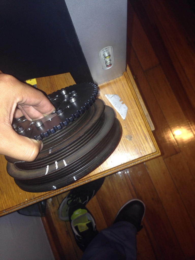

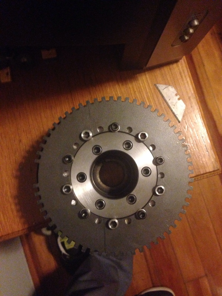

After mods

Now thats the proper way!!

Draco wrote:Now thats the proper way!!
No, the proper way is using proper management that can read the OEM CAS.
Re: Project s13 RB25 Neo Capetown
True....I meant the proper way rather than welding it to the pulley.
I waited almost a year now to finish the neo but funds on a project car is always a little slow lol but wanted to do everything right, going to get pully balanced aswell.
looking awsome, just add a touch of thread lock to that allen bolts when its finished, prevent them vibrating loose over time

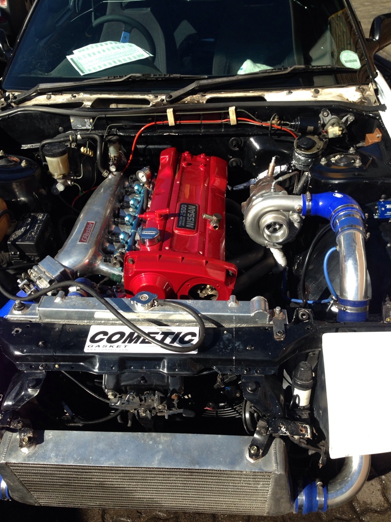

lekka what turbo is that?

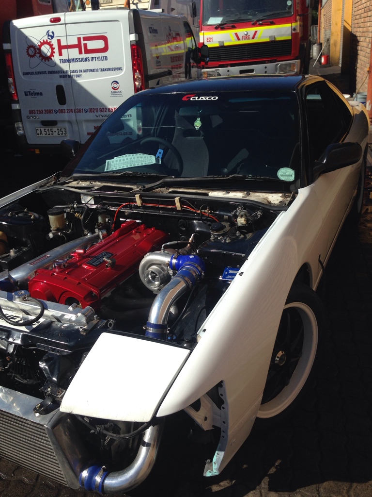

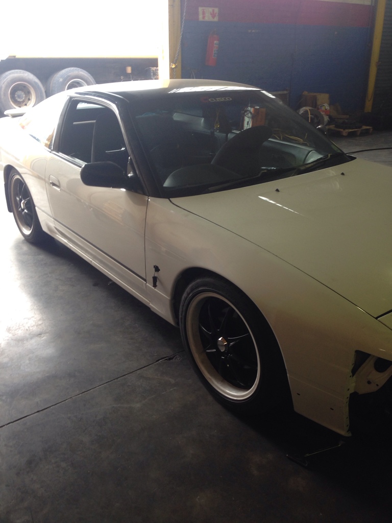

Update time fenders on an valve covers on.

China T3/t4 got it for very good price so it was a must doing 257kw on 0,6bar 380nm

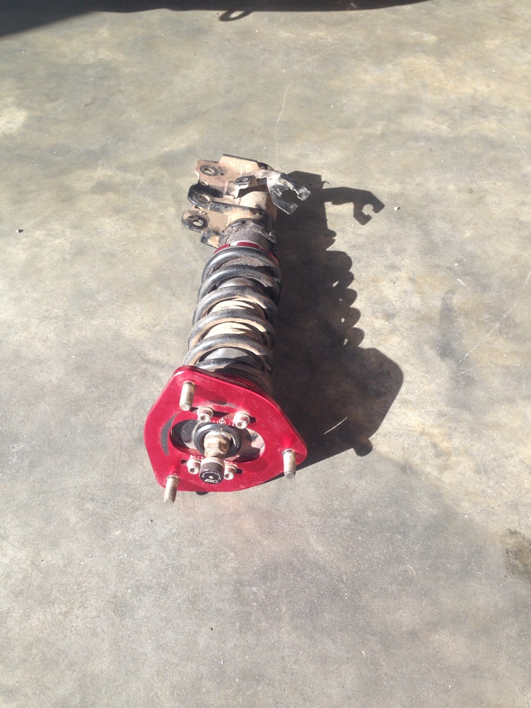

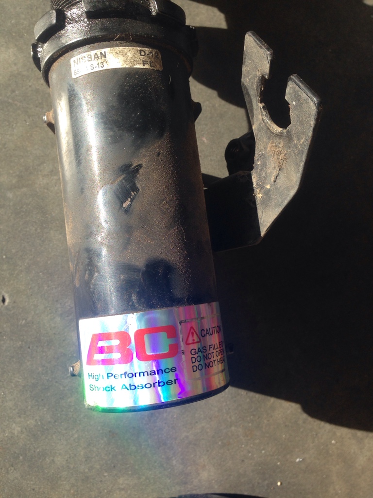

Got myself a set of bc-br coilovers the handling is freaking insane very responsive never got a chance to take it sideways with the coils yet but the con side to coils is the ride dammmmmmm its very bouncy and hard my girl friend not enjoying it lol it hurts my tits so must be sore for a chic granted on the high way its awsome but side roads is unforgiving.

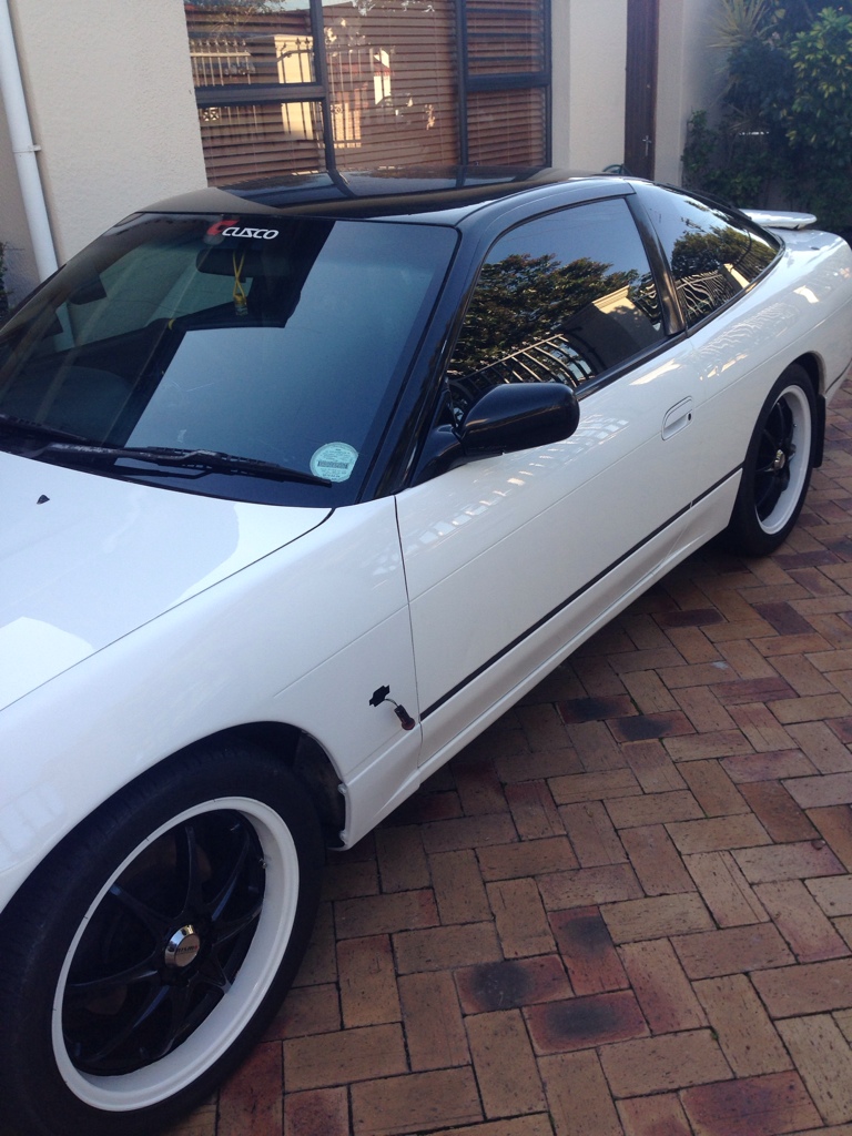

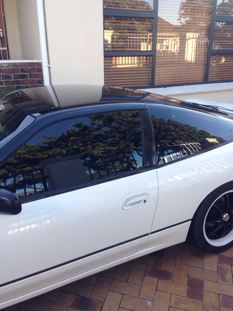

Smash an grab fitted aswell i think it should be mandatory for all S-chassis to have a tint on the windows it makes the car look awsome.
