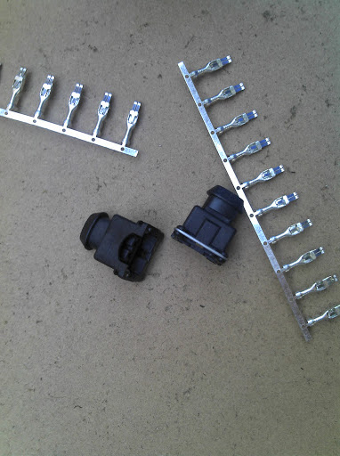

Thanks for the positive feed back guys! to today manged to get new injector plugs finally they clip on perfect

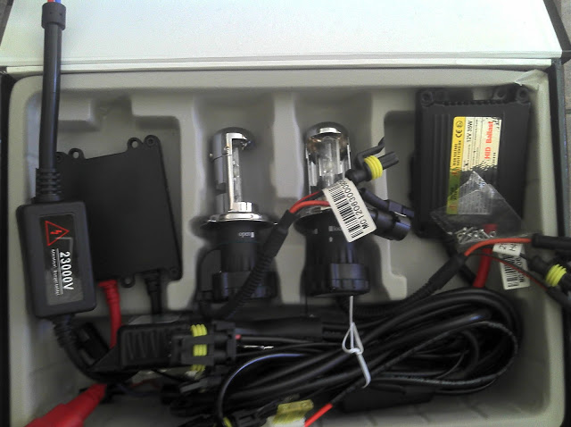

got a hid kit looks wicked
